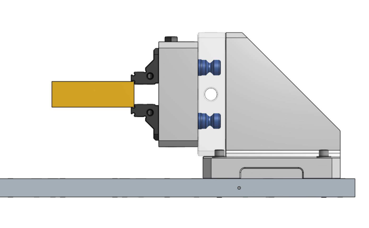

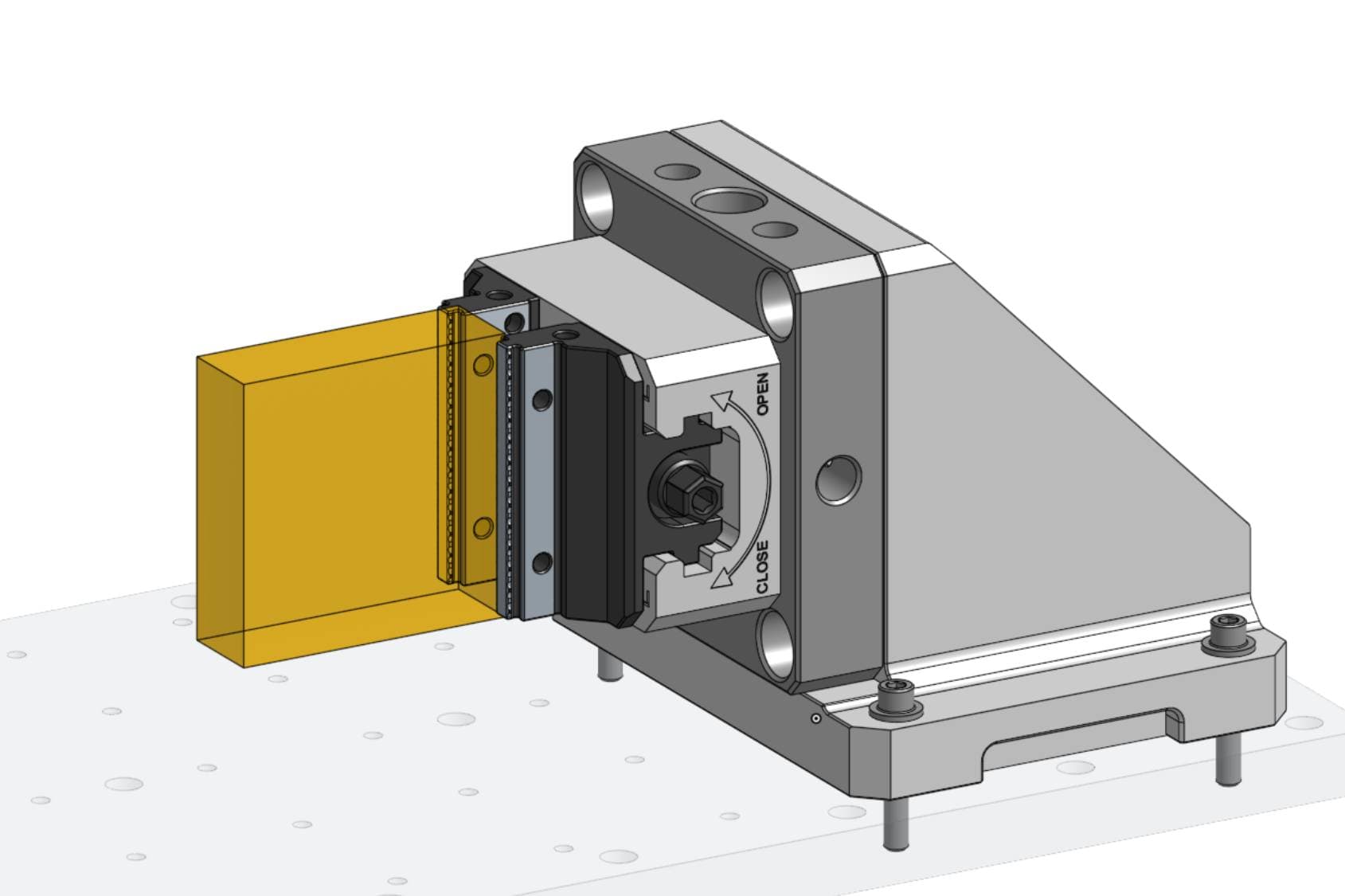

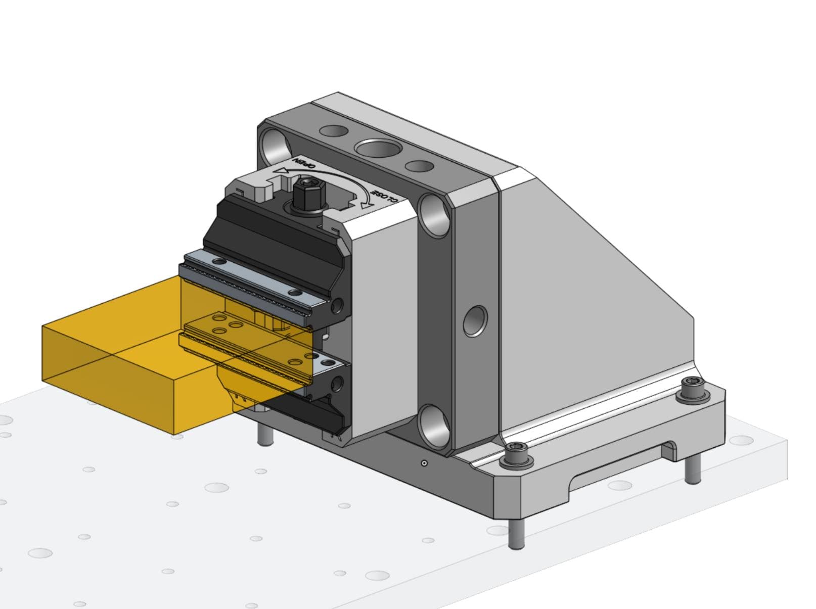

I designed a bit of tooling for those of you who want to splash a little $$ on your machine’s efficiency - here’s a 90 degree indexer/tombstone that fits under the gantry. This is an awesome workflow, and for many smaller parts you can totally avoid re-fixturing and probing:
90 Deg Indexer CAD Model
Total cost is about $1000, not including the aluminum to make the tombstone. These are the parts (a bit cheaper if you buy direct from XinDian’s website like I did).
Please note - if you make and use this without also modeling your spindle nose and spindle housing into the machine simulation, you are very likely to crash your machine!!

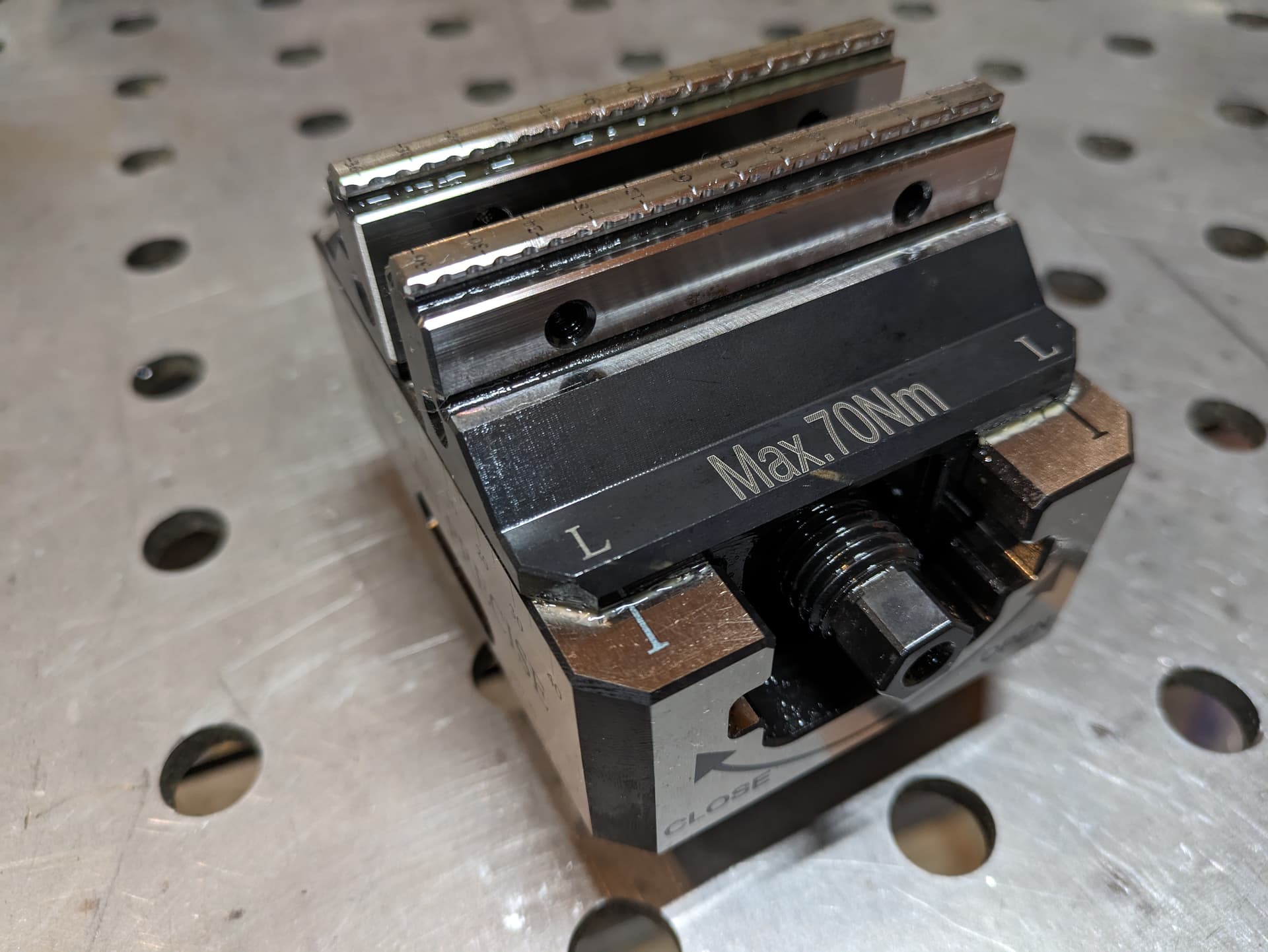

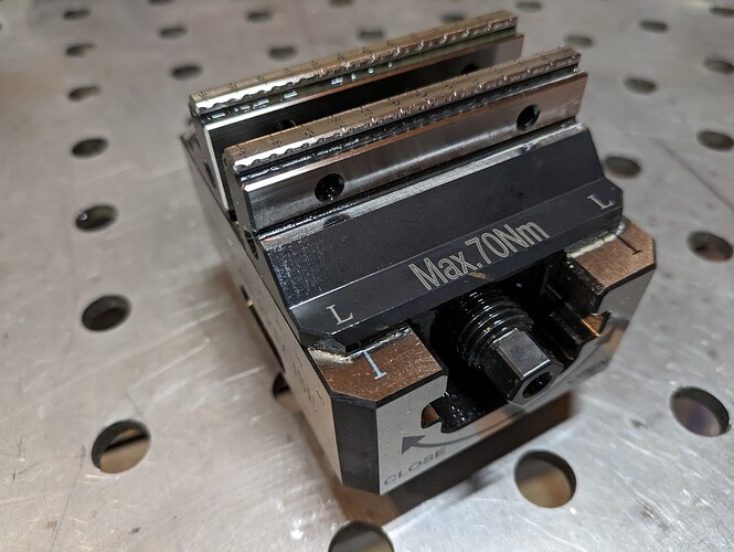

The vise itself seems acceptable. The centering screw has a slight bind in some parts of the travel, but not enough to hinder function. I might take it apart and see if anything needs to be deburred. Otherwise it looks like a solid chunk of iron.
My chuck plate still hasn’t arrived, so I can’t say how concentric it is.
