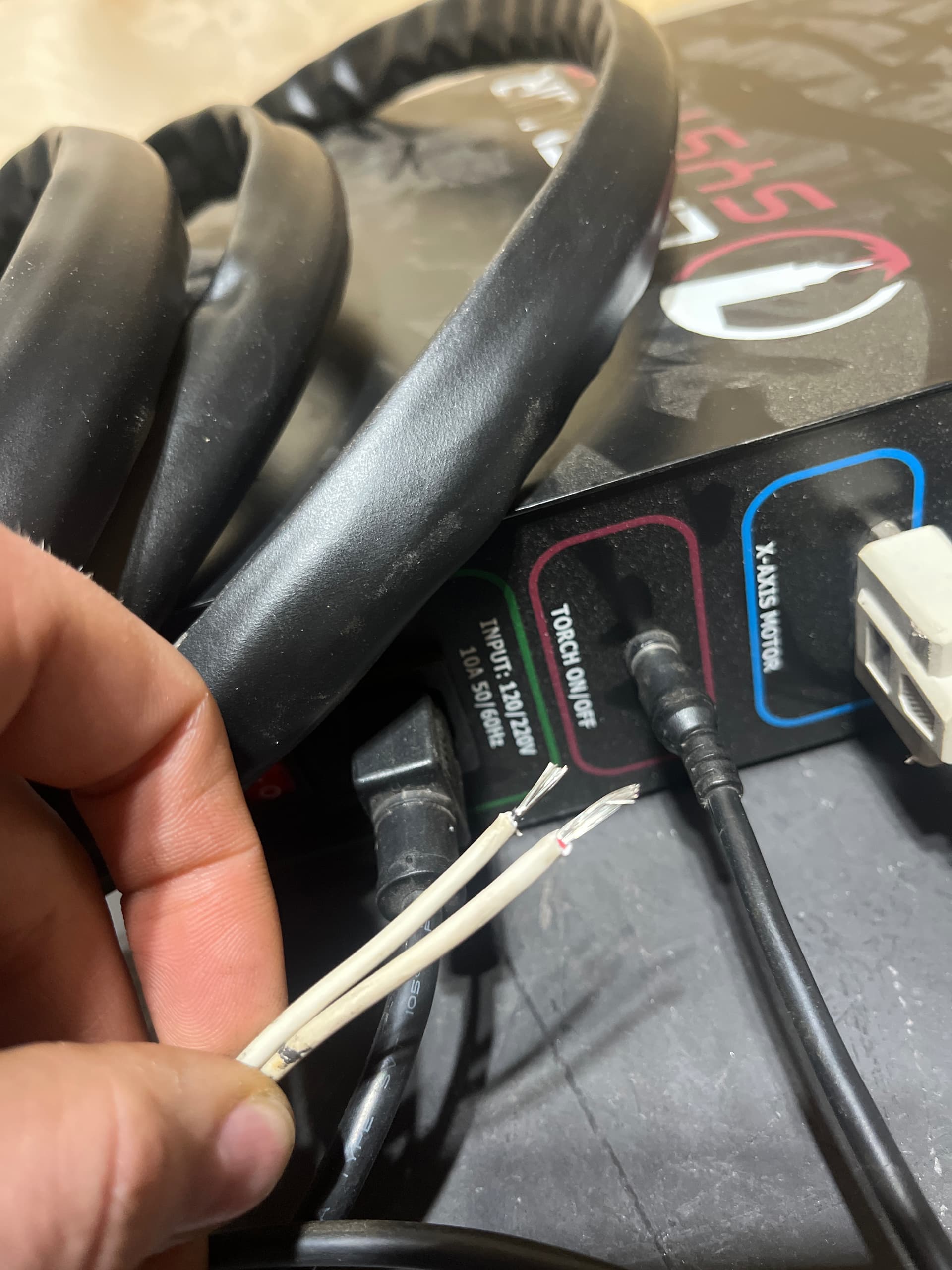

Hello all! I am new here, looking for help from anyone who can. In my current setup I am using a 1st gen crossfire 2X2, paired with the LTP5500D CNC with the two control ports in the back of the machine. I have everything setup and under power, but my torch will not fire. My Lotos machine came with the CNC torch and not the hand torch, so there is no way to fire the torch unless it is through the ports at the back. My crossfire is pre owned, and came with a control cable with only two wires, each wire is bare, so I had to do some soldering. I read elsewhere on the Langmuir forums that the 2 pin connector is used to fire the torch, so I went with this, and no luck. The 4 pin connector however clearly says pins 1 and 2 are the start control, so do I solder my bare wires to pins 1 and 2 and leave 3 and 4 empty? I have my doubts that this will work, but I have spent weeeeeks trying to get this machine cutting, and have hit many roadblocks along the way, but I feel I am close. Any help would be greatly appreciated, thank you kindly! Below is a photo of the control cable I received with the machine
Before you solder anything, use a jumper wire or a paper clip to jump across the pins and see if the torch fires.
The torch firing circuit is just a loop, so closing the loop by jumping across pins will fire the torch.
Test pairs of pins until the torch fires and then you will know which pins to solder to.
You should be able to find a manual for the Plasma Cutter. I can check in a couple of days as I currently don’t have access to my shop.
Thank you for the responses guys!
I will try what ds690 suggested, thank you!
Will it be ok to leave 2 of the pins bare in the 4 pin connection??
Yes, pins 3 & 4 of the connector are not used in either Mach3 or Firecontrol versions.
Ok great, thank you so much!

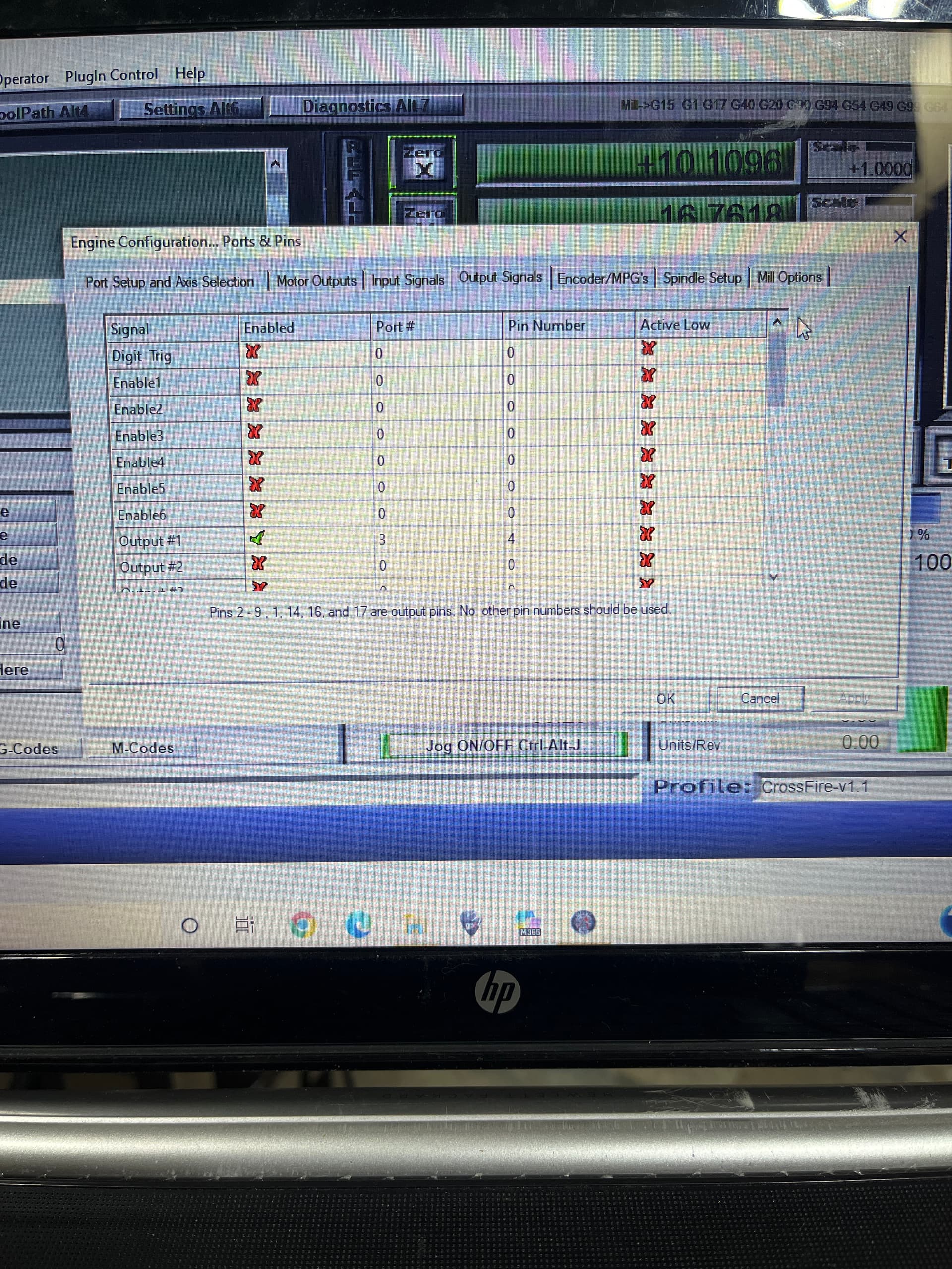

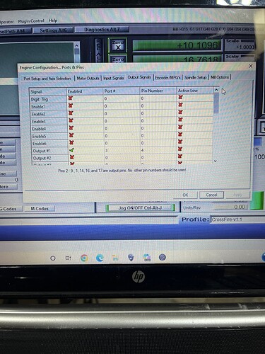

So I tried jumping the wires to pins 1 and 2, and the torch still will not fire, I also tried pins 3 and 4 just for shits and that didnt work either. The lotos is always in “torch protection mode”. Is there something I need to do in Mach3 under ports and pins? By default there is only 1 port and pin enabled, I will include a photo, I know nothing about this sort of thing lol
The plasma cutter should fire when you jump the pins, regardless of connection to any computer or software.
Jumping the pins is the same as pulling the trigger on a hand torch.
If the plasma is in some sort of protection mode, the torch and/or consumables may not be assembled properly. Some torches have a “parts in place” safety that prevents the torch from firing if the parts aren’t installed correctly. This can also happen with an aftermarket torch that may not have the correct wiring for the protection circuit.
@ds690 is correct. The torch has to have the cup put on properly so the contacts tell the LT5500D electronics that it is ok to fire. If this is not a standard Lotos Torch, you may have to move pins on the torch connector to get it to work. Somewhere in my original posts on this PC I documented the Torch Wiring.
