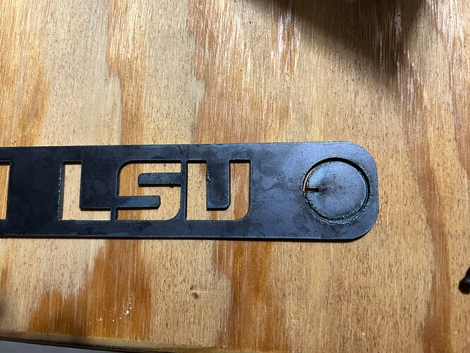

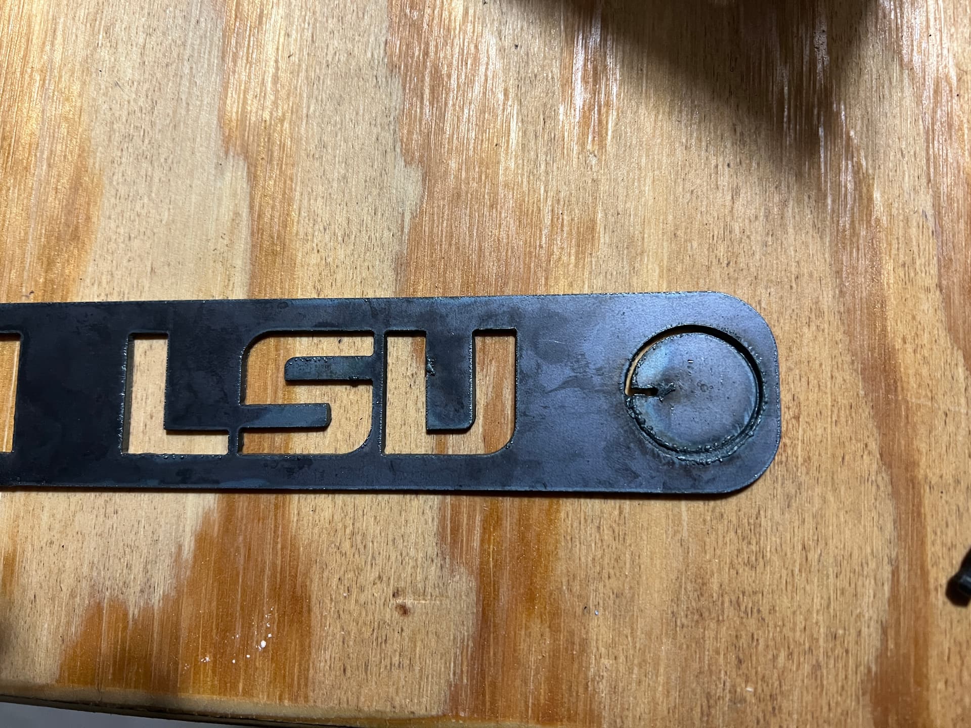

I’m losing penetration on some of my cuts. I’m pasting a photo of one of my cuts from last night and I can’t figure out what would cause this. You can see that it did the rest of the cut perfectly.
Using:
Crossfire pro with THC
Everlast Powerplasma 62I with CNC torch
Also having some issues where my torch doesn’t fire all the time. But I’ve read some of the forum threads of similar issues and have some suggestions from that thread I’m going to try tonight to solve that. Issues include:
  1. Torch will lose arc halfway through a cut and then kick on halfway through the next cut
  2. “sometimes” getting a voltage reading on THC
  3. couldn’t get an arc at all until I turned the air pressure up to 80psi. Then I read a comment from Bigdaddy that Everlast won’t operate above 80psi. So I don’t know on that one
I’ve gotten through several cuts though pretty well. I thought I was in the clear with a good running machine until last night.
This is 16ga. Cutting at 30A 80ipm
Post pictures of your consumables.
16 gauge is thin and super easy to cut so I suspect you have moisture which you should spot easily.
Also, 80ipm is pretty damn slow!

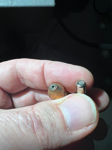

I’m betting that electrode has tons of swirl marks on it.
Your most likely running low on air. Air should be study at 65 to 70 psi when cutting.
Here are the tip and electrode They look ok to me.
