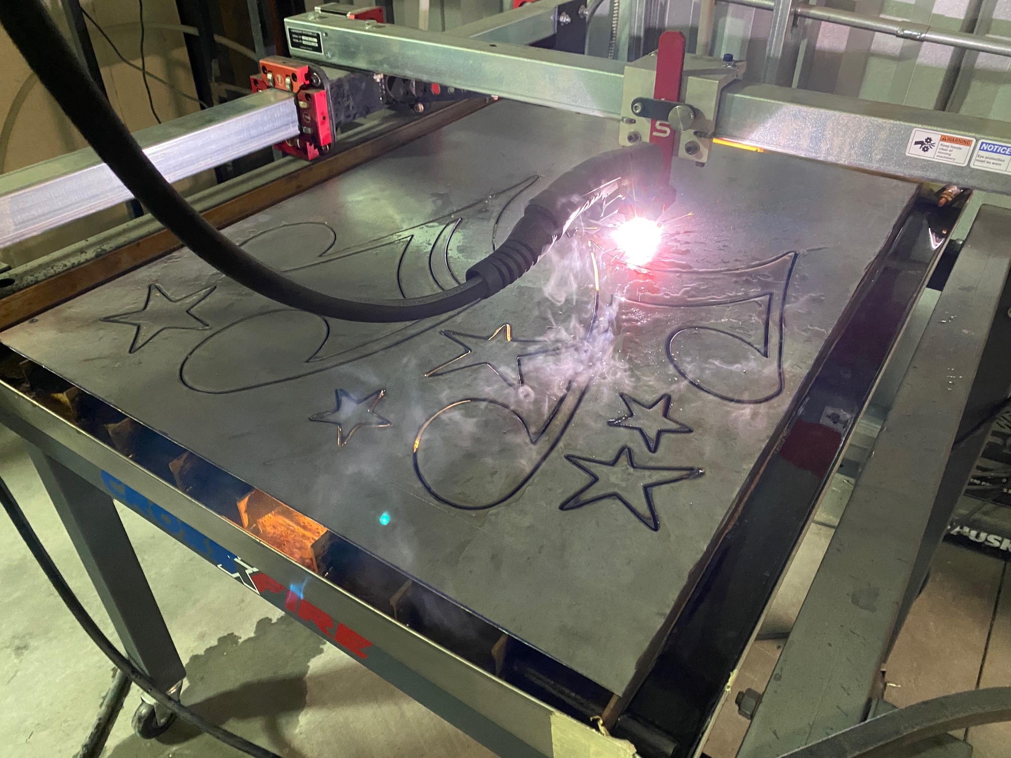

There is no water in the table fellas :grimacing: i was just doing dry runs to see if this thing would cut out. Now that i know it will i am going to set it up. Im going to give it another go and see how this goes. I will update you guys and will start sharing more info along the way to get this thing dialed in.
NOOOOOO STOP. Don’t ever plasma cut with a dry water table. You WILL blow holes in it. When we talk about doing dry runs meaning that we turn the plasma cutter off and run a program on the CNC table.
You will also warp your water pan resulting in the slats never sitting even
And you will give @toolboy incredible agita!!! We can’t have that! He’ll make the rest of our lives miserable and then something bad will happen…
Oh… sorry… I guess I got carried away. Um, don’t run your system without water… :flushed:
Sorry for the scare and i think i misused the term dry run … but i did fill it with about 4g of water. Im glad nothing happened to the table :grimacing: that will never happen again!

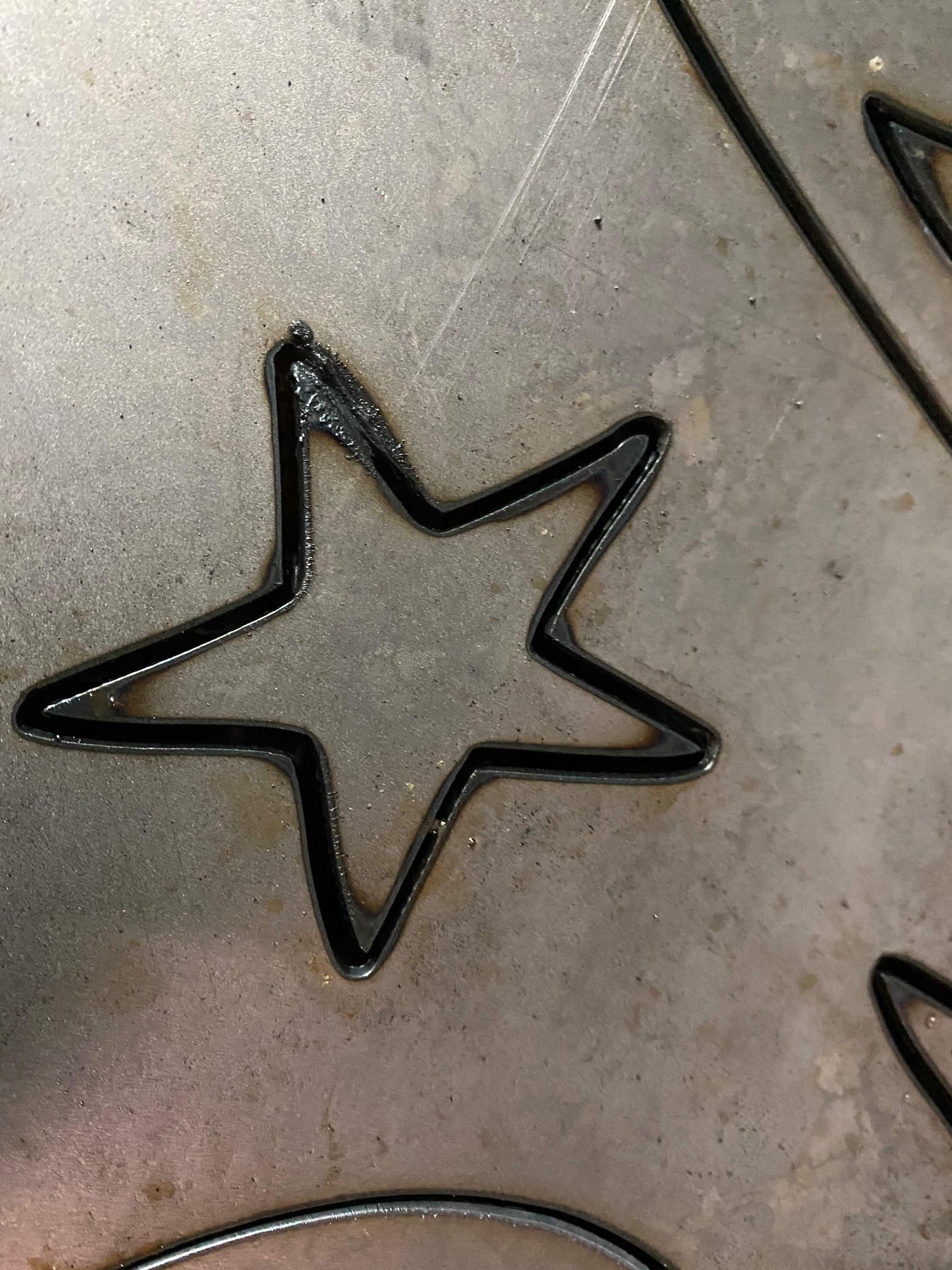

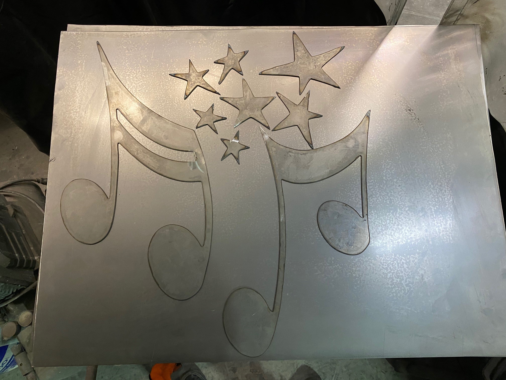

Got better results today with a project im working on. 16g steel cut out some music notes 32A 70PSI .2 arc lead in. I did have to finish cutting out all the piece. That is progress so ill take it :beers:
What speed? 120ipm or so? If too slow it can melt the slag back together
does not seem like enough water…
I fill my table …which sits real level…to about 1/4" from the top of the water table…in other words…as full as I can make it without spilling over.
I get good splash up under thmetal to keep it nice and cool while cutting.
Should be around 11-14 gallons depending on how close to top you get it…(pro table)

I was at 100ipm ill jump up to 120.
Ok toolboy i have some more to go i will top it off, i have a regular crossfire water table.
You have air compressor at 125/150 or whatever it is for max. and then 75 at plasma cutter should be normal.
Drop amps to say 25/28 or so with 16ga, and with 120ipm and try.
.2 delay is perfect
Ok i will make the adjustments and let you guys know how that work
