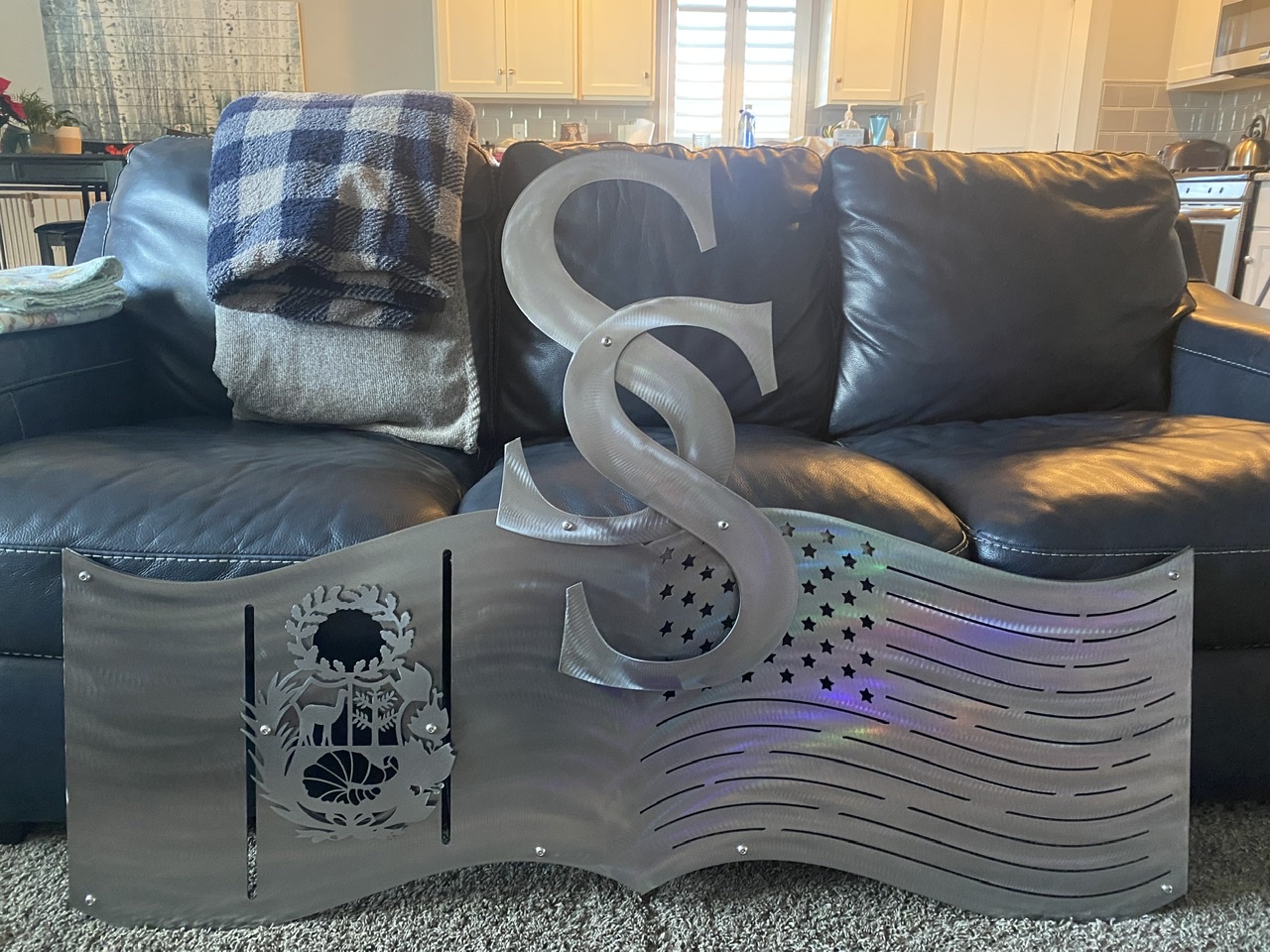

I think a lot of people are just like that, using templates and what not. I’ve been doing a lot of my stuff from scratch. I’ve been thinking about advertising design services. I feel like I’ve got a good hold on how to make stuff work out of metal. I use affinity designer and design in svg.
That’s the Peruvian flag on the left. I combined existing paths from a source file and then added a stroke to the outside the width of the kerf, and adjusted the detail to where it would cut. To get the holes all lined up I just copy and paste then move them to another layer of the drawing, group them and drag them away to nest in the same file.
  1. Peru is a beautiful country and I am glad I traveled there for 3 weeks. The culture and history is so amazing.
  2. Love the blend of the flags and the finish of the metal…us that stainless?

Looks good man! I plan to start with templates to get the ball rolling but will eventually be moving to more complicated design like that picture you posted.

Thanks! It’s just cold rolled 16g mild steel. I gave it a pattern with a 120 grif flap disc and hit it with some clear coat. Clear coat makes it pop.
