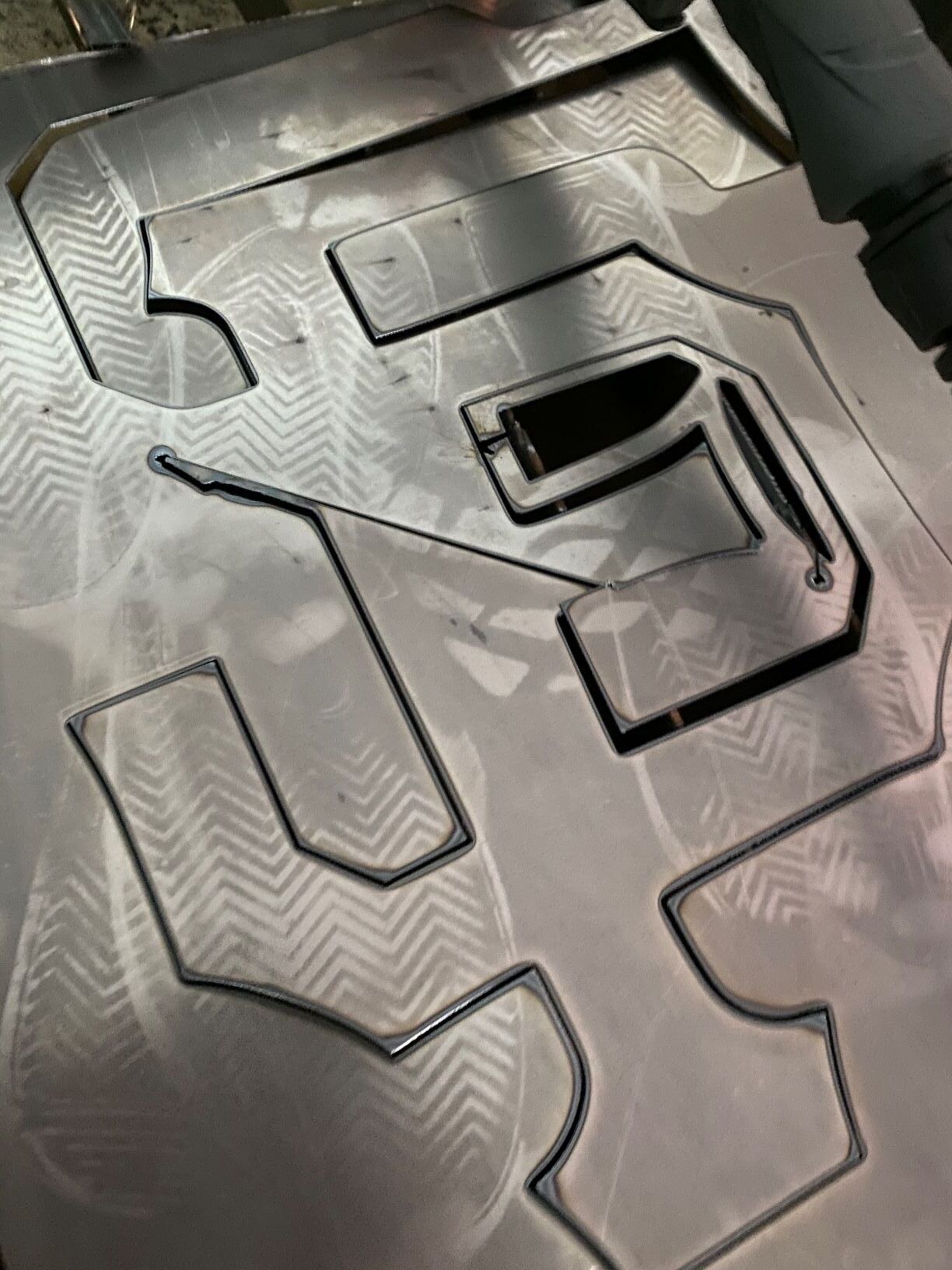

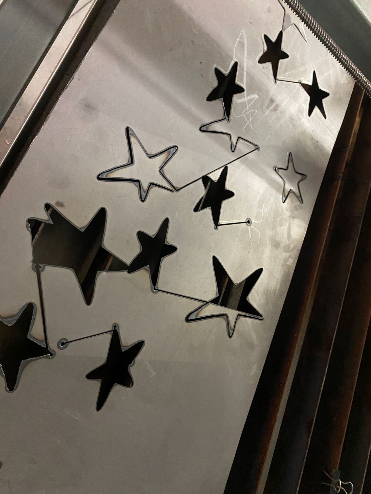

All right there it is! SUCCESS!!! Definetly needs some fine tuning but i cut something before the new year so its a win. Here are some pix.

Cool! Congratulations!
Now, it looks like your torch isn’t turning off, is your 2T/4T switch set to 4T? It should be 2T.
If you zip up your SVG and your .JOB files we can take a look at them and see what’s what…
Good! Now by looking at the stars…what is lead in or out lengths? Not sure if torch is firing early for lead in or staying on, the 2 stars show it cutting independently and not following G0 to next pierce, so that makes me think outside cut with 2.00 lead in, also note that both start and stop points are outside of star…difference is one is about 1/8 long and other about 2.00 inches long(guessing on lengths)
Def. Post code.
Let’s say the stars are about 2x2, click inside cut and maybe .15 lead in on an arc or perpendicular. You can move start points.

Tom i think your correct about the 2t/4t. The machine was not firing up at first and i did hit that button. so i will make sure to keep at 2t. I will work on getting those files for the group, thanks!
GunTruck1776 - I will need to look into that info, i will be cutting out some more peces today so ill take a better look at my setting. As tom mentioned may be that 2t/4t switch.

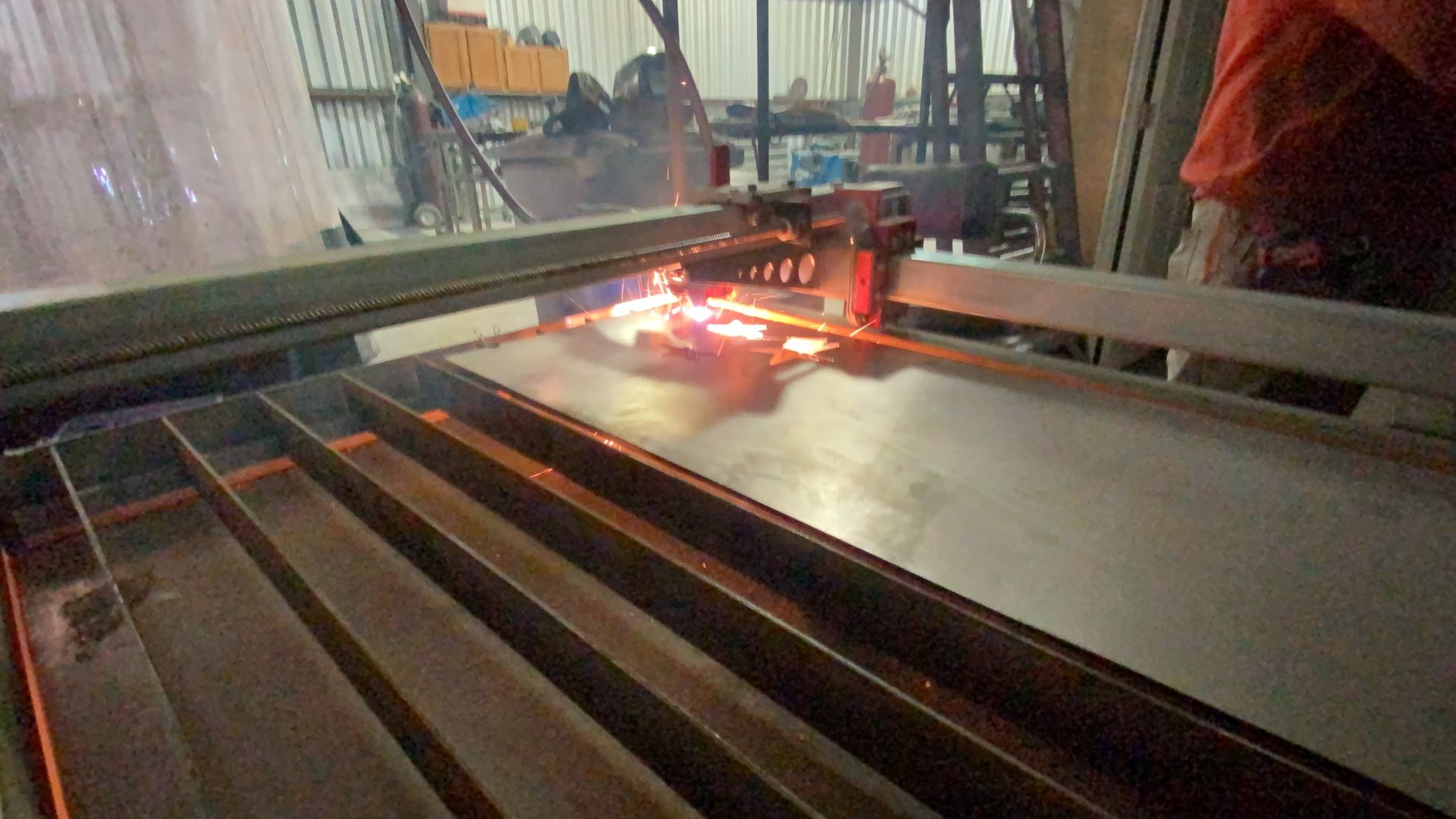

BFuentes are you going to put some water in the tank to keep the dirt down? Looks like a lot of smoke coming up from table! Or do you have water in there and it is real clear!
Sir…am I mistaken or is there no water in your table?
