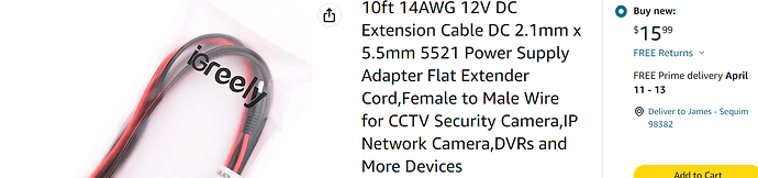

I did find this other listing that “claims” it is 14AWG wire. Always buyer beware but it claims you could go up to 20 feet or more. It is “Free Returns” if it does not work.
I couldn’t copy the link, it wasn’t working - could be an omen?!
i have seen that one also recommended. i believe @ds690 uses that one so maybe he can chime in on whether it’s actually 14g or not…
I have been using the one i posted for the past 3-4 years now with no issues.
just buy one of those and cut off the end you don’t need and solder it back on the cnc port or the remaining bit of cable still attached.
This still doesn’t tell us what cable you need. There is a torch on/off cable and a divided voltage or raw voltage cable. There is no “all in one” CNC cable for the Primeweld
This is the cable that I used to replace my torch on/off after I stepped on it and broke the connector. It is 14 ga wire, which is probably overkill and much heavier than the original wire. https://www.amazon.com/gp/product/B08L6LJ5F4/ref=ppx_yo_dt_b_search_asin_title?ie=UTF8&th=1
