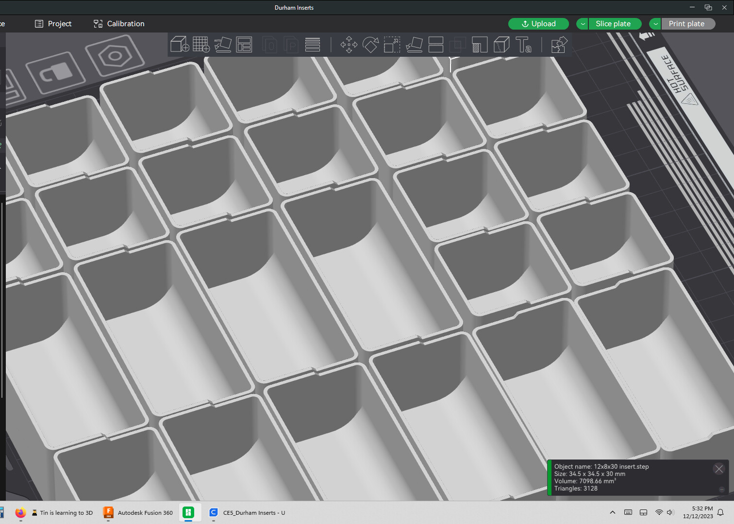

Durham part tray large
I can’t find the one where I put the rib on the top of one edge for the nesting ones (I hope I did not delete it), then I remembered that I also put a generous fillet on the bottom to make it easier to get little things out that would otherwise stick in the corner when reaching in.
I keep the base model in F360, and modify the sizes according to how many and what size I want.

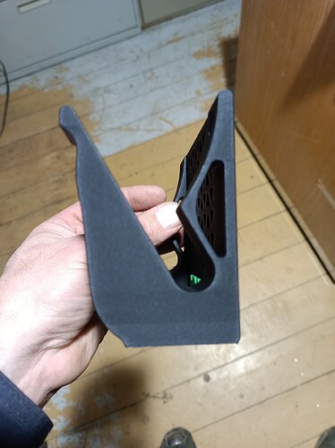

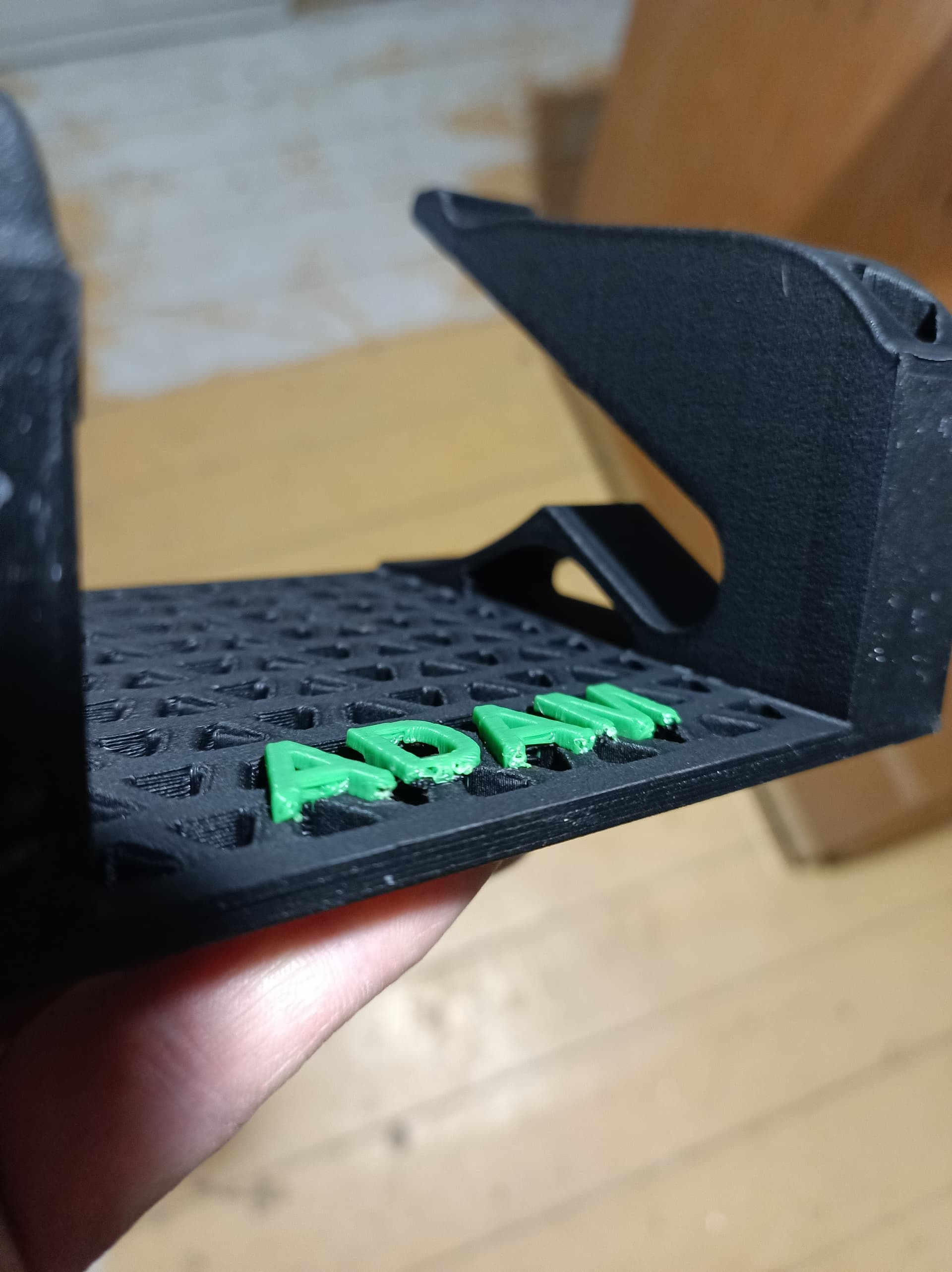

I have concerns about the lack of support at the bridge at the bottom. The smaller triangles may go well.
You are right to be concerned.
The photos are after I picked the stringy bits away with a knife.
It turned out okay but the bottom few layers of green definitely didn’t like being printed into thin air. I’m going to do one more later today and just see if I can put pla support material underneath the letters somehow or maybe design the letters as a separate piece that snaps into the triangles. I haven’t dove into the slicer muchyet. Fumbled around enough though to get the text and color done in Bambu studio…

Your CAD skills should make short work of making the letters seporate.

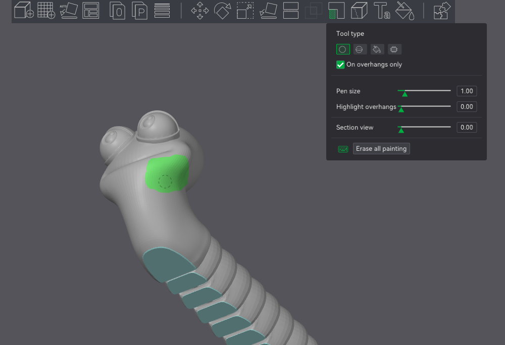

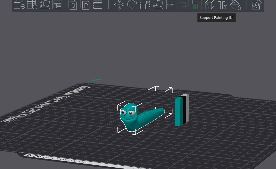

However…You can use the slicer to put supports only where you want them, which would be under the letters - Support Painting

I’ll try painting supports on the next one I do.

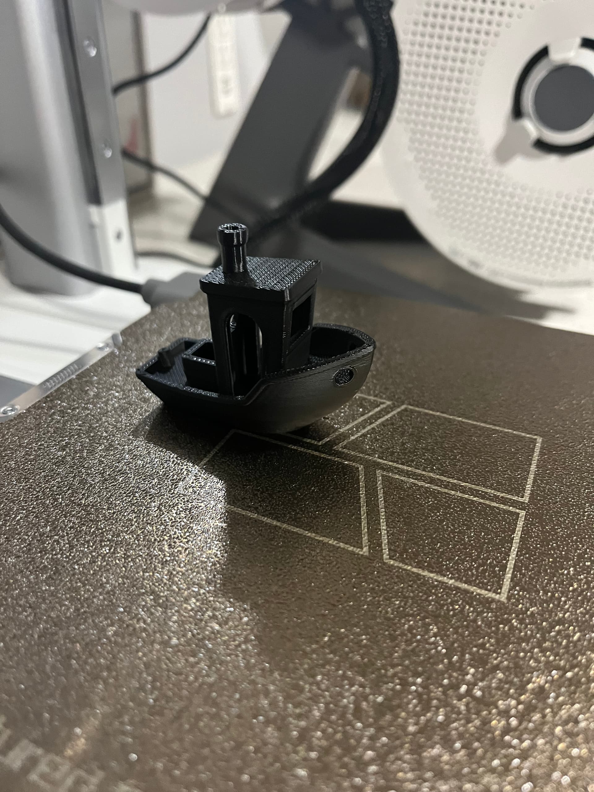

Got my Bambu A1 mini and took 10 mins to get it all setup. Did calibration and everything was good. I figured I would make a benchy boat so selected a roll of PETG and the mini comes with the textured plate. It didn’t stick and came off on first layer. I selected a black PLA roll, and it worked great. My question is…Should I raise the bed temp to 80C instead of standard 60C if using PETG?
I’ve had good luck with the generic PETG profile in Bambu Studio, which has a bed temp of 80C for the Textured PEI plate.
I’ve also had good luck with the Bambu PETG filament and their profile, which has a bed temp of 70C.
Make sure the build plate is CLEAN…wipe off with IPA. Fingerprint will cause bad first layer.
ALSO - PETG is hotter and slower. Some people get lucky with it. Others it’s a fight.
This long arse thread has a lot of tips and fixes.
Bambu Lab Forum link
ALSO - no part cooling with PETG

The cleaning and 80C seemed to work.
