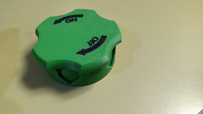

Those are great. I printed one a weeks ago out from PETG-HF , it worked out excellent.
The one correction I would have made is how the on and off or both written and positioned.
This one was on makerworld I believe
Elikoll was the designer

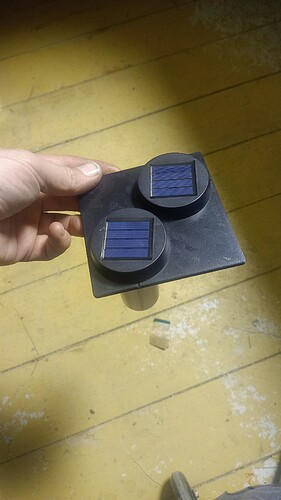

Printed the top of the lantern that hold two of these lantern solar panels. Running too low on filament to print the body of the lantern. Postal Strike Still on going I may have to start ordering from Bambu in the US soon.
Fits well
I made the top lid replaceable so I can try different solar panel and lights.
You can see the size comparison of the new donor lamp to the original lantern that I’m reproducing.
My reproduction one is 1.67 scale compared to the original. The left in on a true 6x6 and the right on a 3.5 x 3.5
