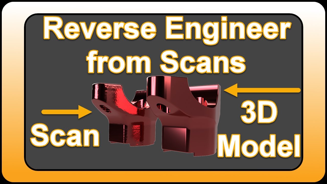

I’d figure out what the thread pitch is (looks like a DP, not regular screw thread), and go from there.
Maybe a mesh section sketch of the mesh body, offset plane through the middle then trace the thread profile, then a revolve to duplicate it?
ETA - Look up reverse engineering 3d scans. Same procedure that I use when I work with scans of things. ex -

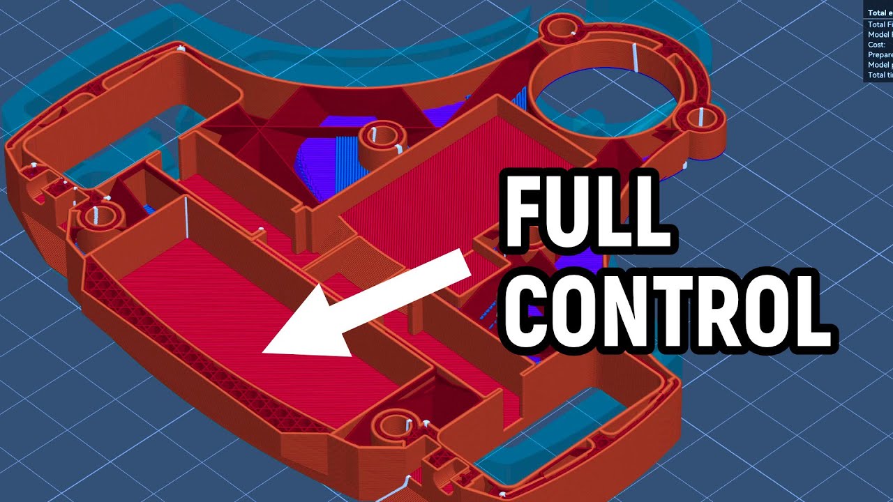

@Sticks I watched that entire video. Very good!!!
Advanced 3d design for printing.
Thanks Sticks! Finally got a chance to view it (18 minutes). Good information.
