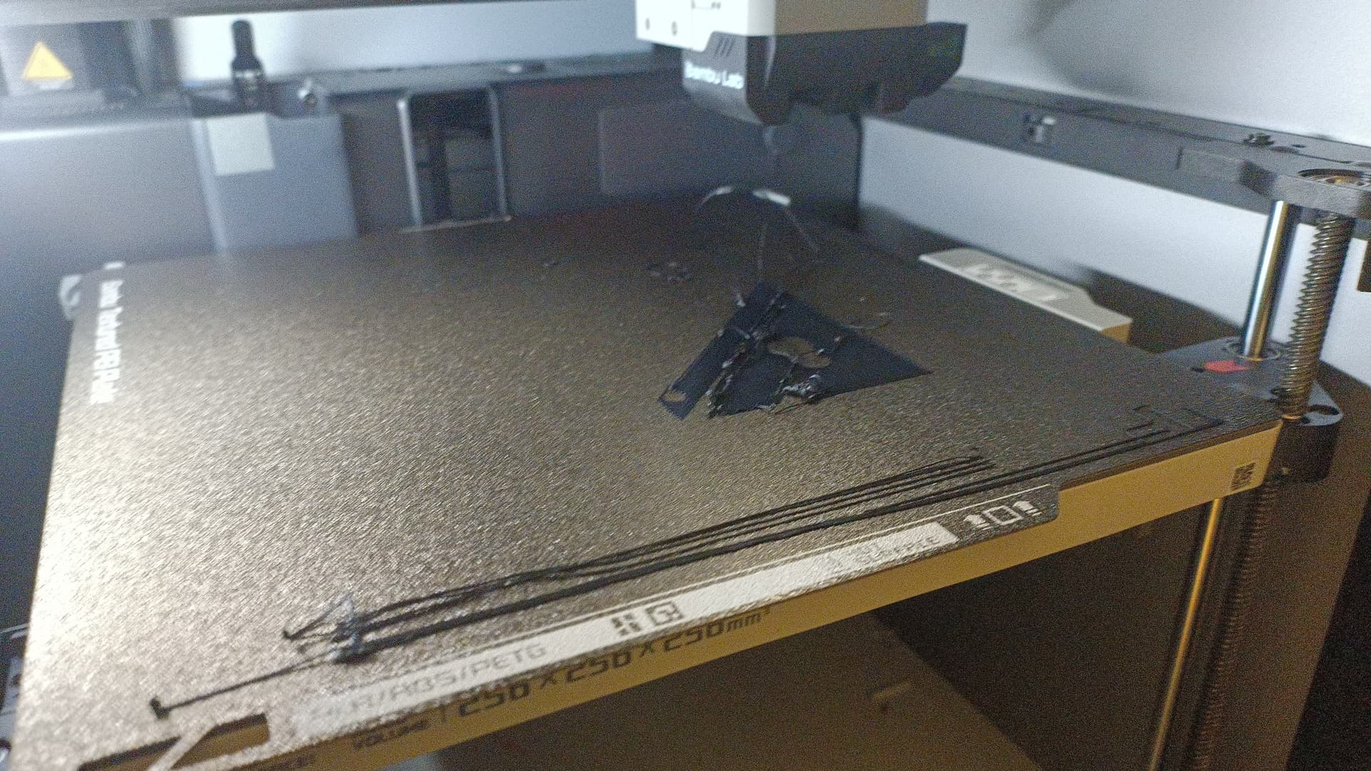

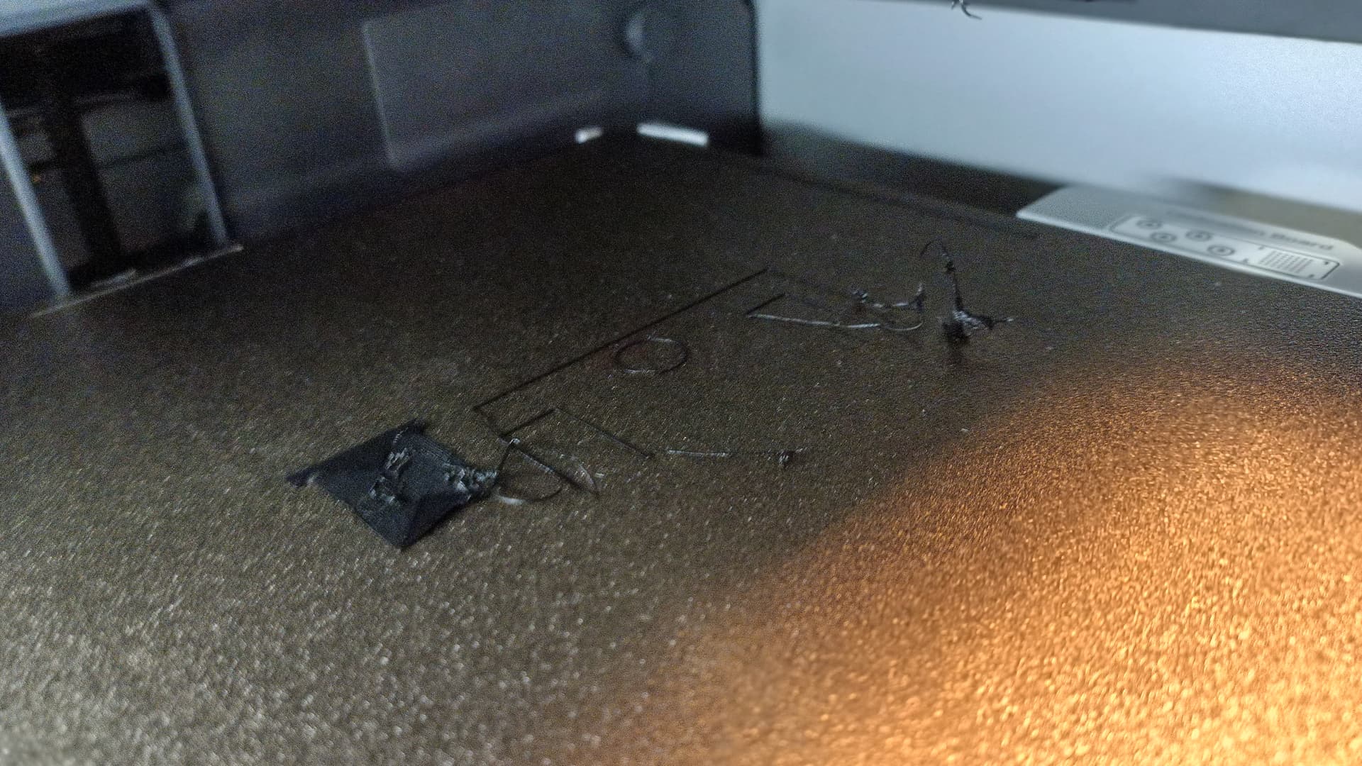

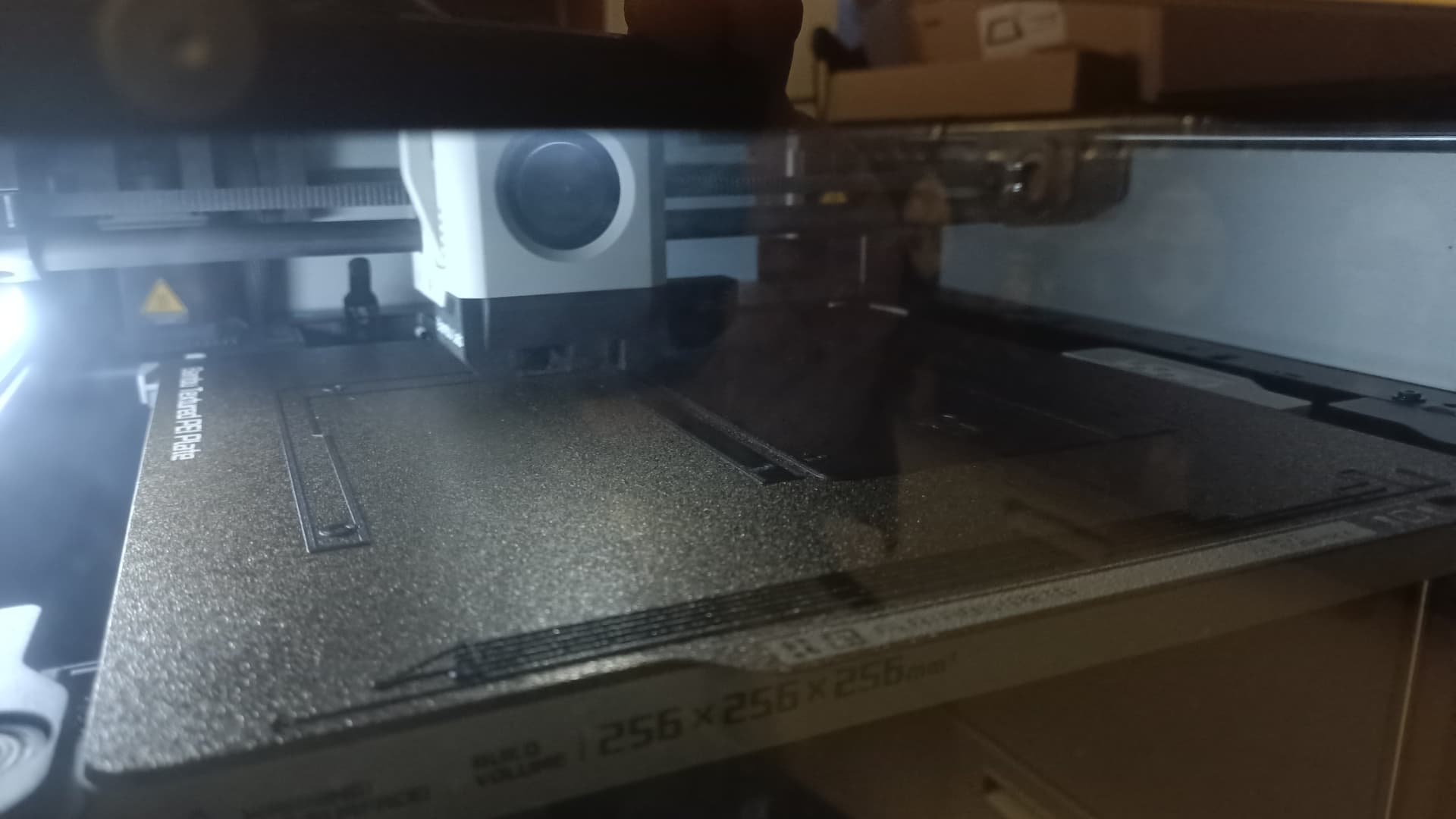

Been having some issues with my print lately. I keep getting first layer peeling up in a few places.
I tried a new hot end I tried really scrubbing down the textured plate with soap and water.
Now I’m trying a different spool of filament. maybe it’s a moisture issue?
I was using pla CF and now I’m switching to petg CF.

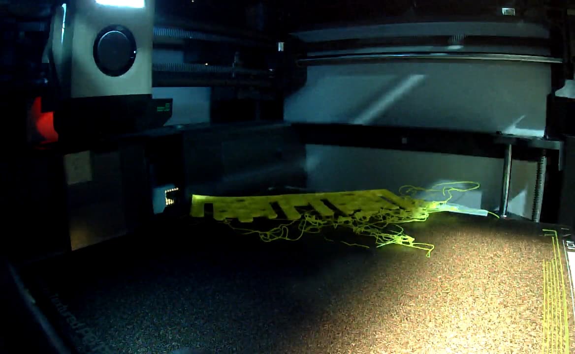

I’ve only had one successful print out of six over the last few days using mostly pla CF and I tried one run with abs.
The first layer of this petg cf print seems to be coming out okay.

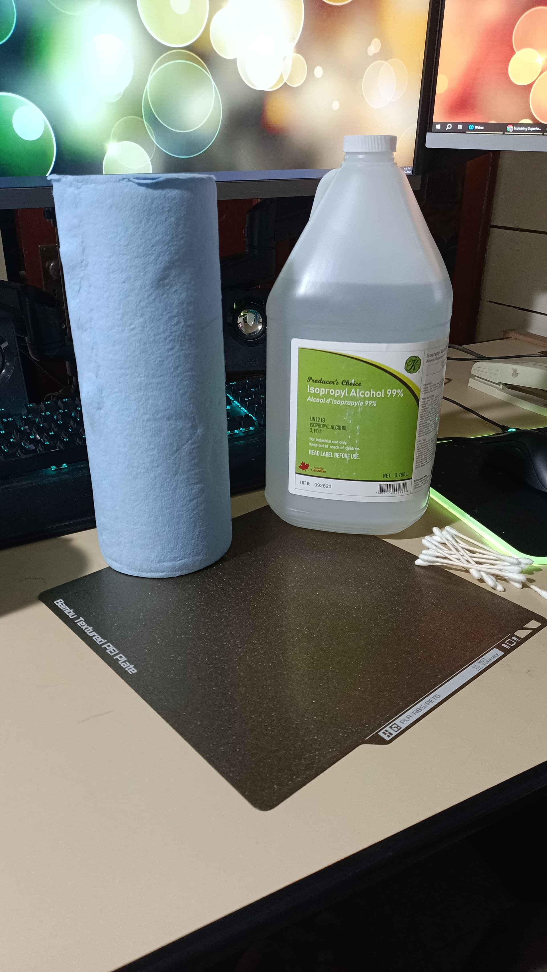

I’ve had good luck with cleaning the plate with isopropyl alcohol.

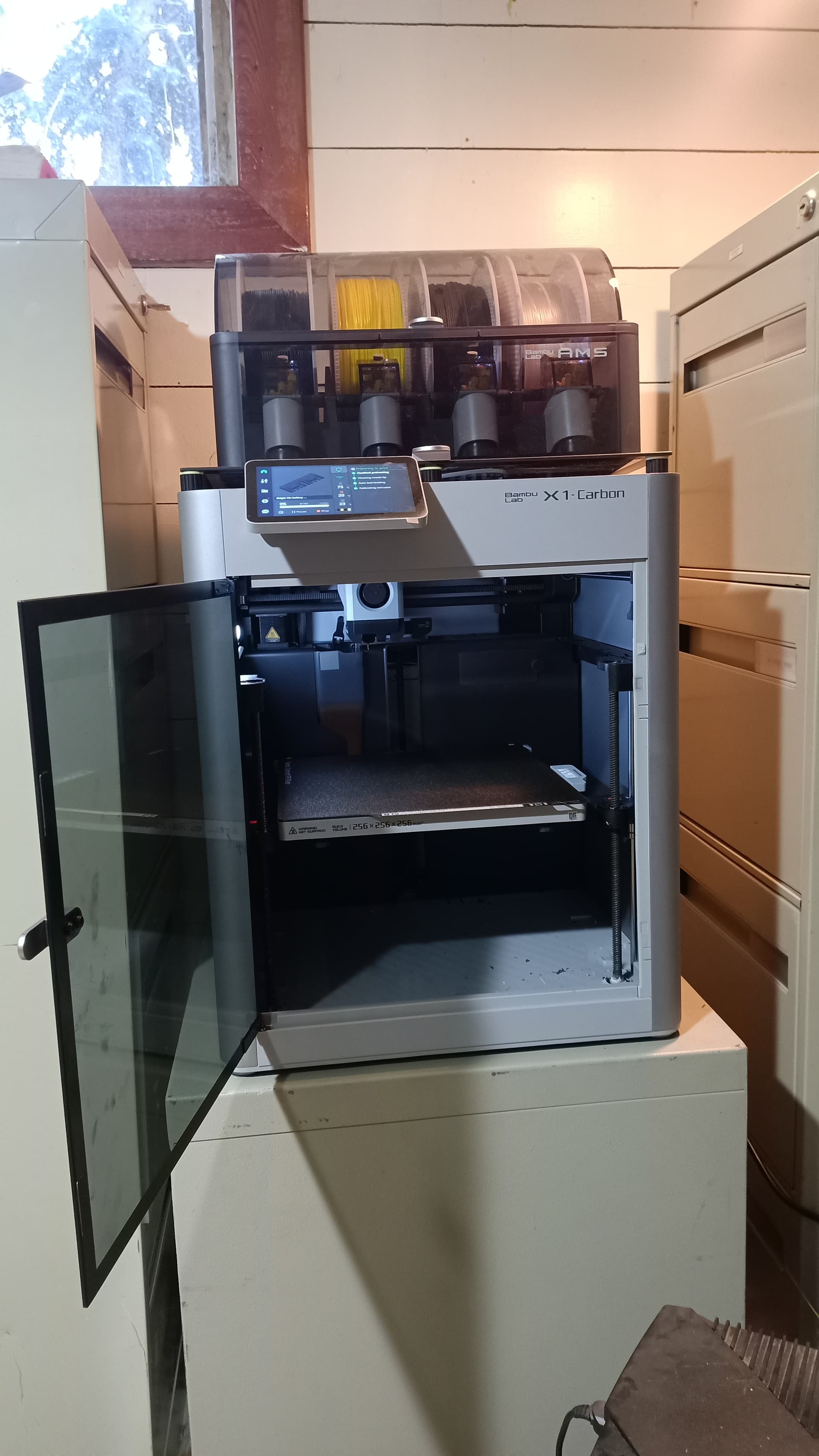

For PLA, I use 65c bed temperature and leave the top off or the door open.
I had been printing ASA and forgot to take the top off, when I switched back to PLA, and nothing was sticking properly. Took the top off and the issue went away.

I’ll see if I can print one of those things so I can have the AMS on top and remove the top glass.
I did read that the heat was an issue I did try to bump up the bed temperature by 3° on some of those previous attempts with no success but all with the door closed.
I’ll try another one with the pla with everything wide open.

Bambu actually recommends leaving the door open or removing the top when printing PLA. It is definitely related to the heat building up in the closed chamber and affecting the cooling of the filament.
I do use the 91% isopropyl.

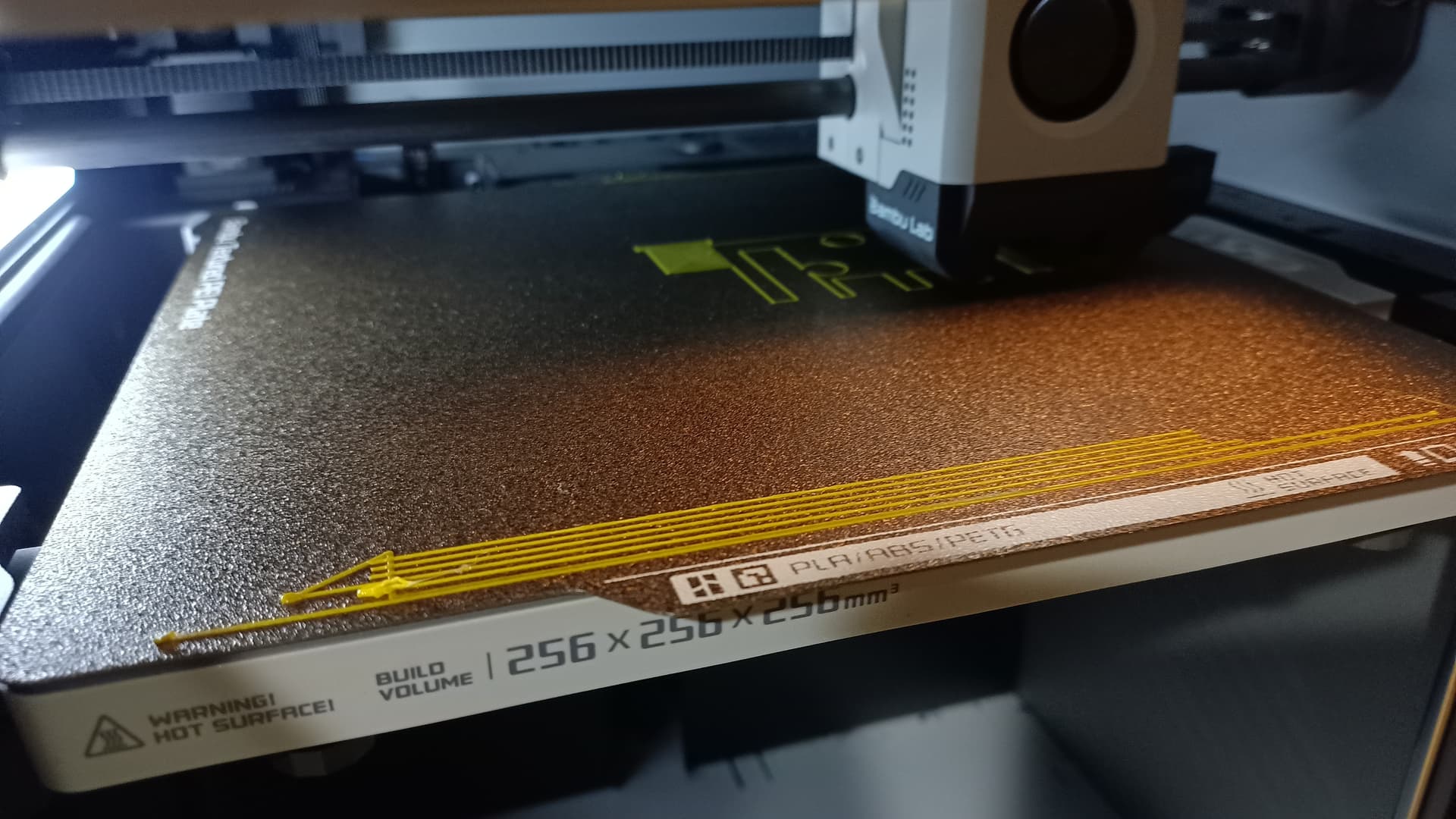

I have had some similar issues occasionally. usually if it is going to happen, I notice an issue with the calibration strip. Like @ds690 said I usually clean the plate with isopropyl. When I had the issue, I also turned up the bed temp a little and it solved the issue for that print.
PETG can be printed without an enclosure, so it should be fine with the door open.
When using the textured PEI plate I’ve only been able to get PLA to stick to the plate if I use the Bambu Lab liquid glue, then everything works great. Washing the plate, wiping with isopropyl alcohol or sanding with #600 grit sandpaper seemed to have no effect on improving first layer adhesion. I pretty much use the textured PEI plate for most of my PLA printing.
Quadruple on the 91% IPA, paper towel, and no touchy the build plate with fingers. Up the bed temp for first layer, and subsequent layers by 10*. Fine tune by 5s if you feel frisky. Use brim, 8mm.

isopropyl and cracks the top lids and kept the door open. Still had issues with both pla CF black and pla tough yellow.
I’m going to try to increase the bed temperature next.
Then I’ll try some glue stick on the smooth plate.
Then I’m going to try the pet g again.

Edit: I just remembered that most of my prints that failed from layer adhesion were while printing with “Optimal 0.16 mm) layer” with a 0.4 mm hot end. When I switched to 0.20 mm) layer, it would work. Can’t say it worked every time.
@TinWhisperer - Make sure that your print has selected the correct build plate, and that the build plate is actually heating and staying hot.
It all looks like the build plate is turning off after the first layer.
I had this happen, drove me nuts. After an update, and the default build plate was the cold plate, not PEI.

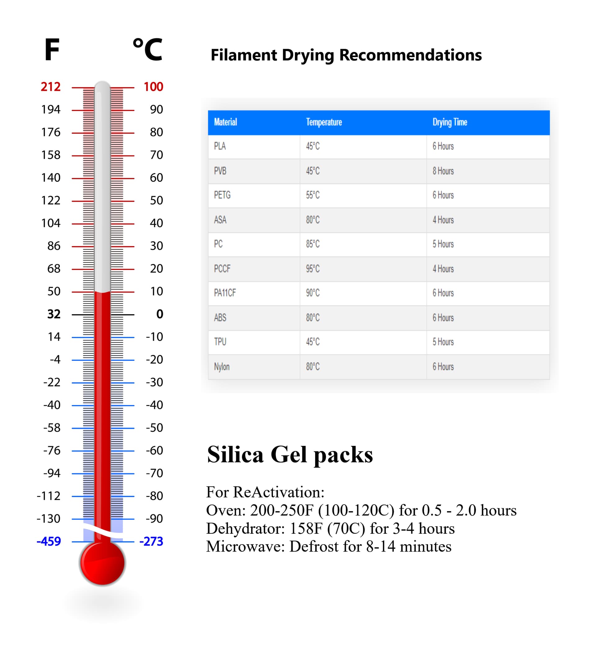

My biggest problem of late is I definitely think I need to get a good dryer as I am noticing problems with filaments that have just been sitting on the rack are not doing well but when first opened they pretty much all printed with very little issue. I’m assuming it’s from moisture.
At the very least you should put them in an airtight container with some desiccant beads (Amazon) once you open the packaging. It’s amazing how much moisture plastic soaks up :slightly_smiling_face:
@OldNBroken This topic is becoming quite large. I will just add, here are some drying times for filament by type:
