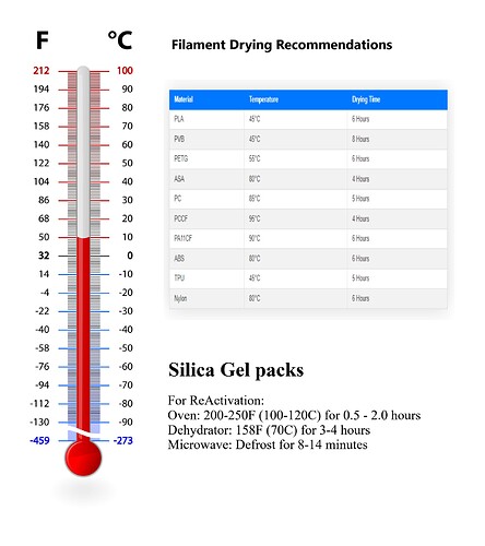

I compiled a temperature/conversion chart and what is recommended for various filaments.
