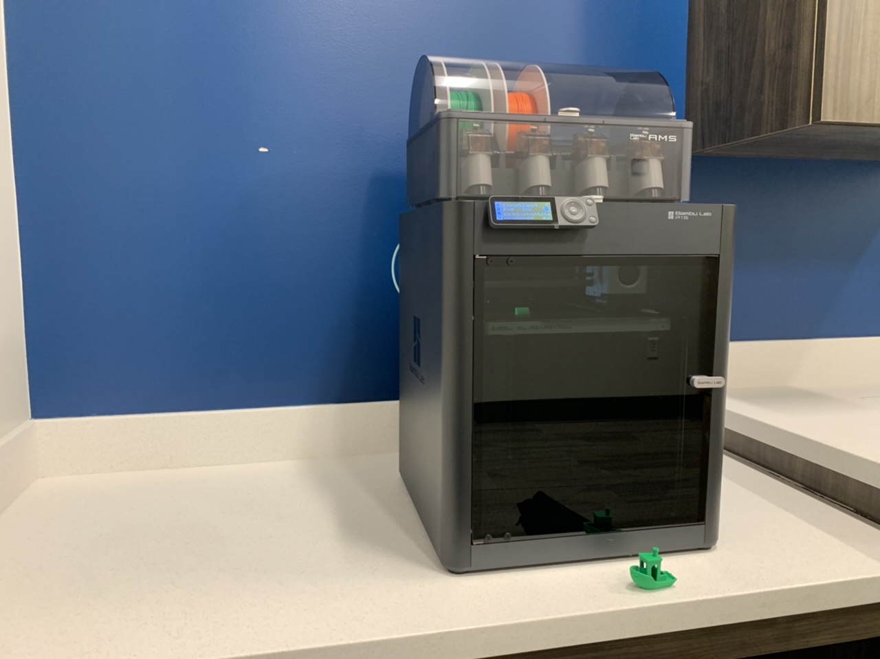

Awesome. Thanks everyone for the info. I will pull the trigger on my order today. I’m excited to get started with this printing journey
This showed up this morning!
I had a nozzle bend on me too last week. Really wierd I cannot figure out how that could have possibly happened. It’s not like I could easily bend it back so it had to be quite a bit of force from something.

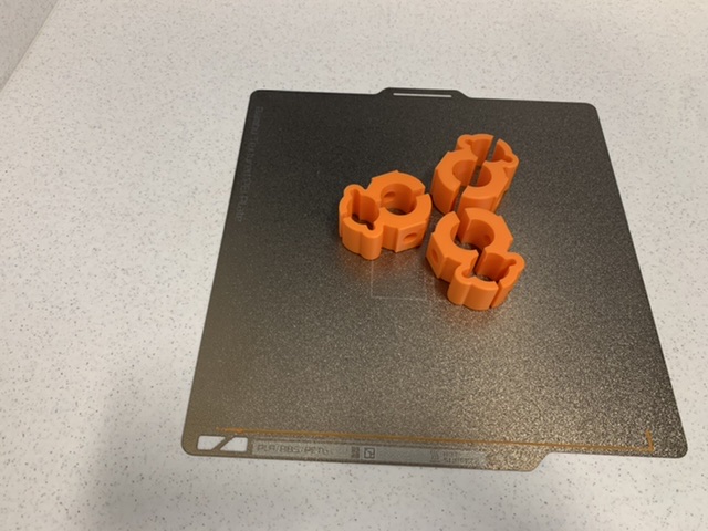

First print!!
Congratulations to you on your new toy.
@Heath I printed off a set of these. Thanks for posting them! I’m excited to put them to use!
Awesome.I really happy people are putting them to use.

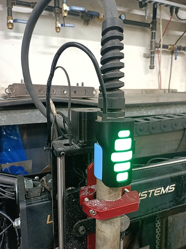

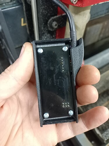

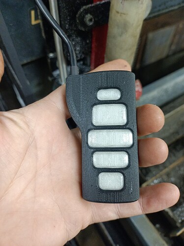

I found the XR shield / light indicator for the z-axis cumbersome and not super effective at keeping debris out. So I harvested the LED circuit board from the cover and made a small housing for it that clips to the barrel of the torch.
Design this in AD Fusion and printed it on my Bambu X1C.
The housing is made from black PETG-CF
ezgif-6-0a47bc4a4e
The light diffuser is made from translucent PETG-CF
ezgif-6-7bf57f884f
The torch snap clip and back plate is made from Blue ABS ( likely would have done black but I didn’t have any)
ezgif-6-319818a29e
ezgif-4-566ad2ad92

Very impressive!!

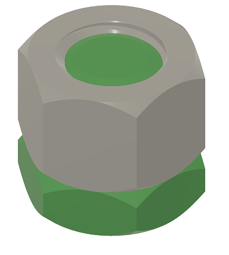

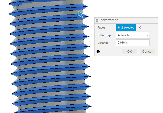

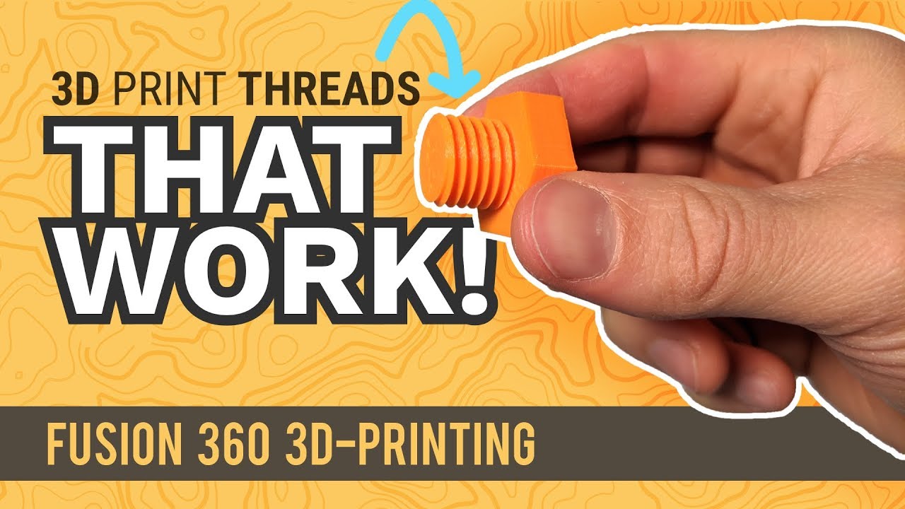

If anyone has been struggling with making threads that work in F360 - I found this video that helped me a lot.
This guy is great!

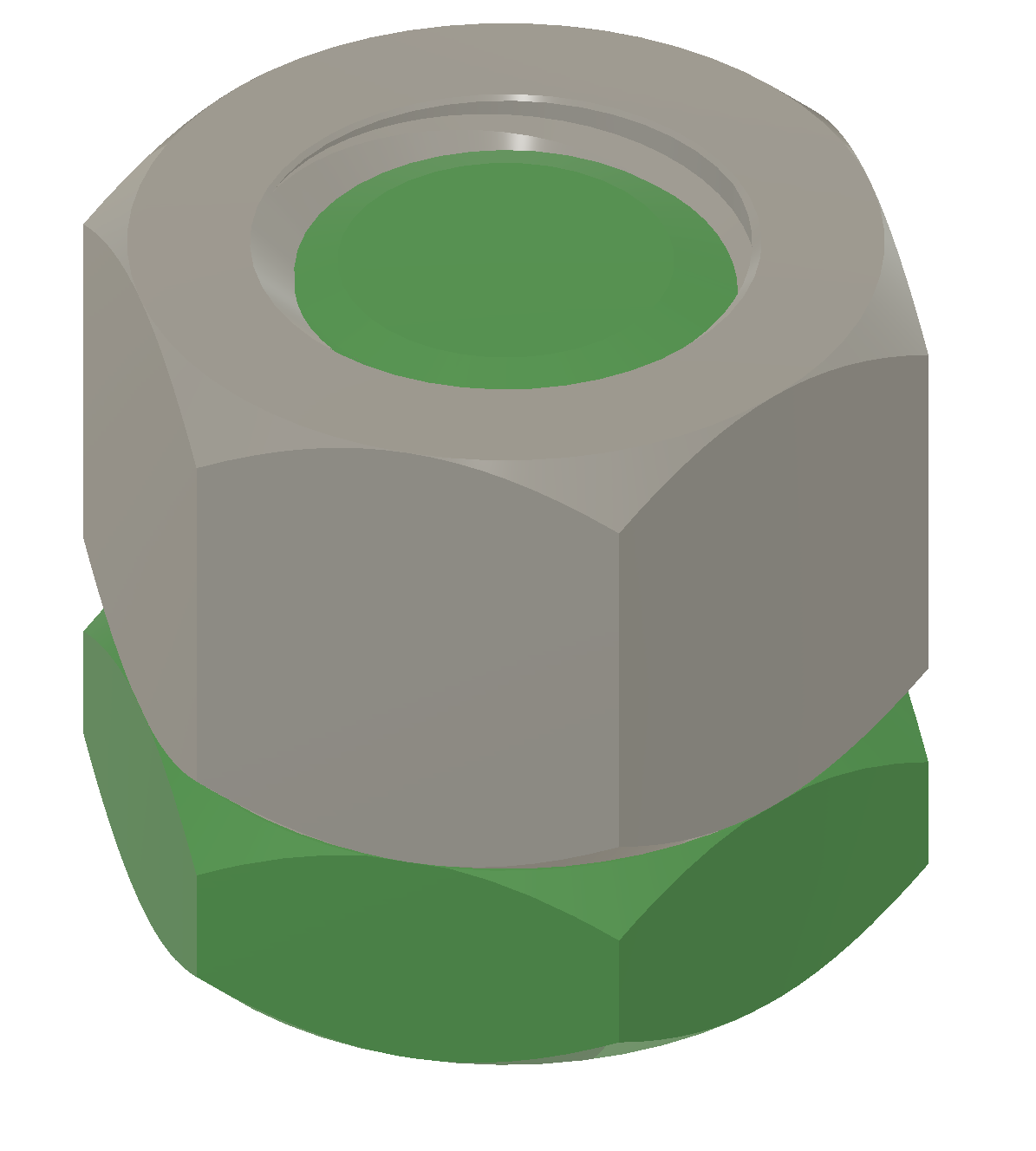

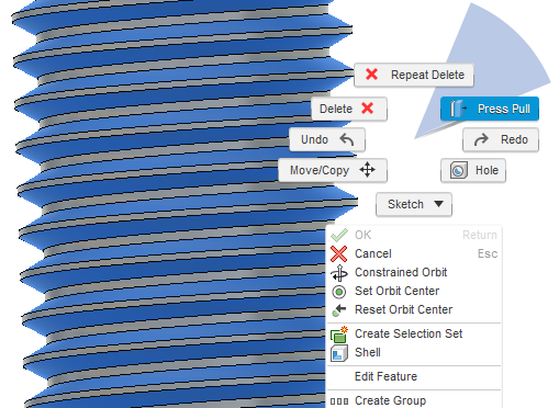

I found a slight short-cut that he doesn’t show: you can select both faces of the thread and then do the press-pull command:
When you activate the “Press Pull” it is best to just type in a negative value and watch how the treads respond. The mouse movement is very erratic.
I love the rounding of the face that he shows. Thanks for sharing.

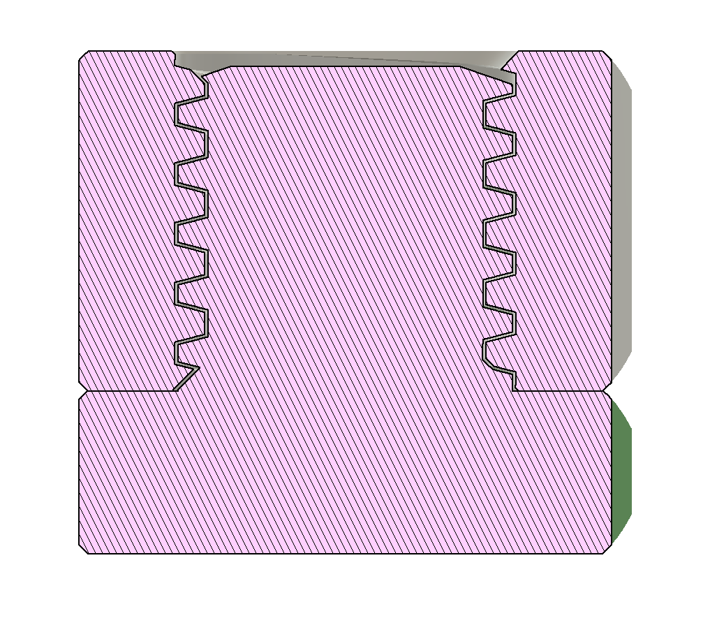

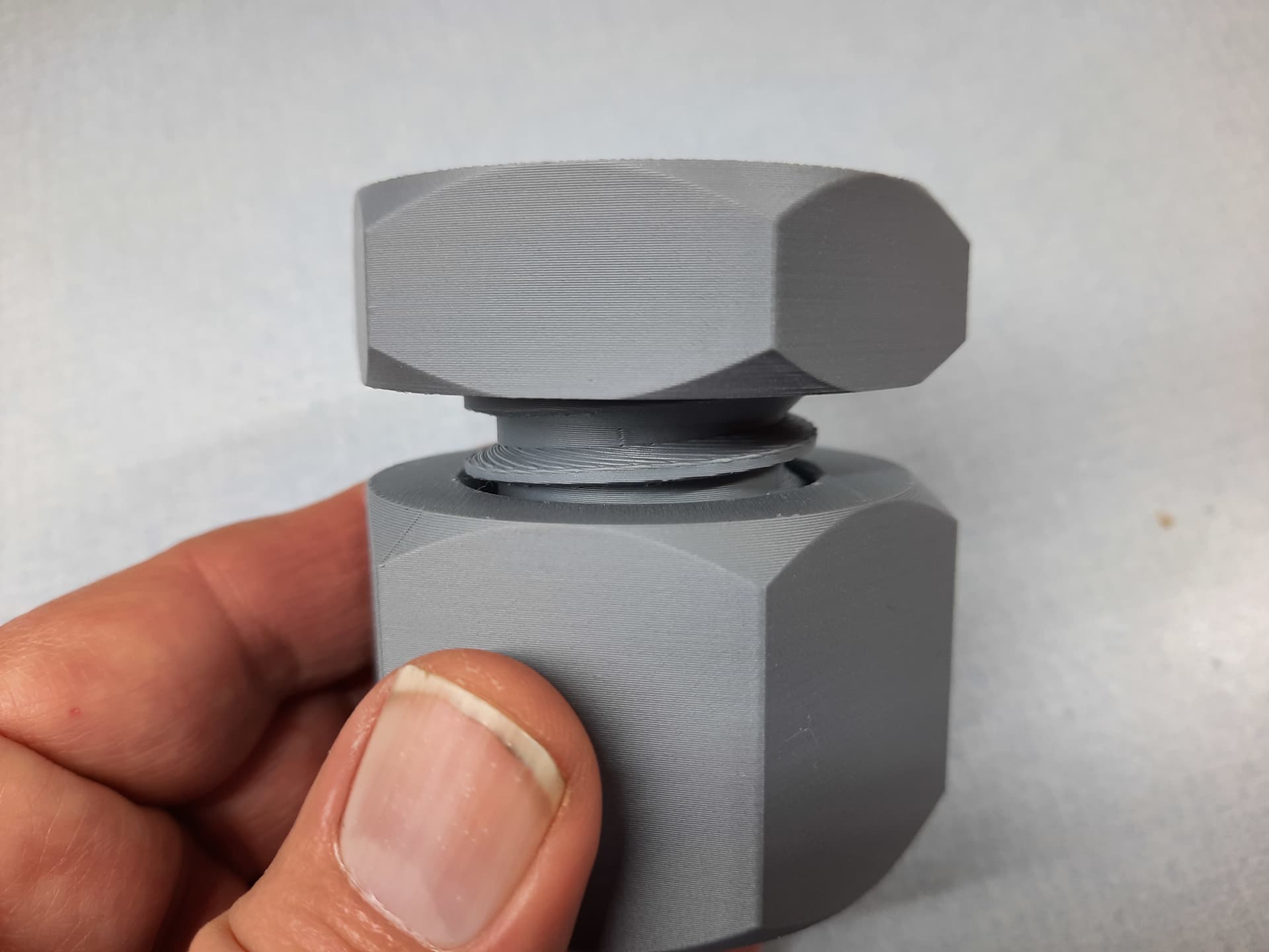

This works. I downloaded an M40 nut step from McMaster and modeled a giant bolt using ‘combine cut’. Then did the offset face technique with section analysis to check the offsets.
M40 Bolt #2 v12.f3z (936.2 KB)
