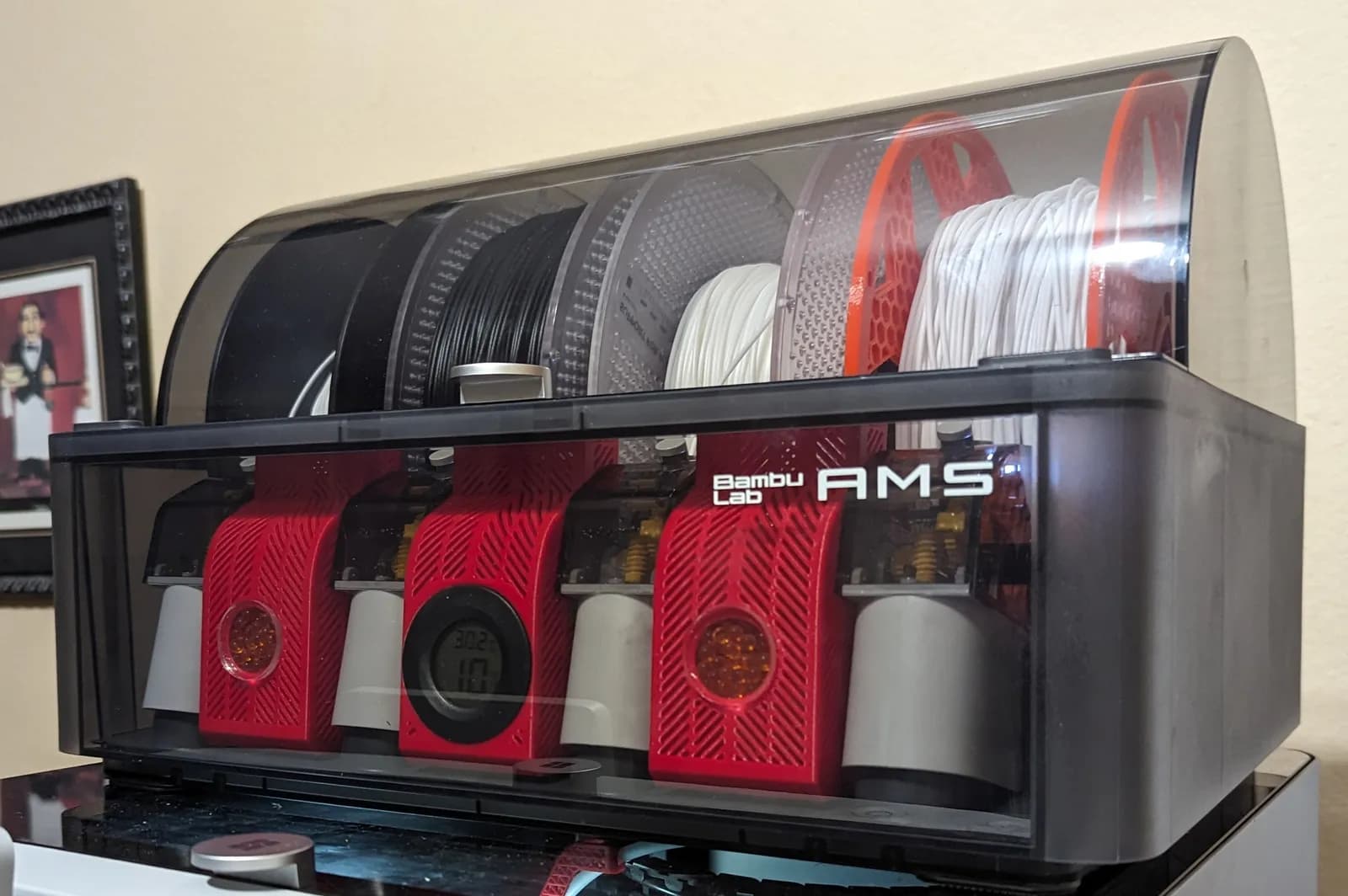

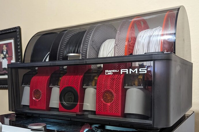

You know, the X1 has a drying cycle function.
https://wiki.bambulab.com/en/general/bambu-filament-drying-cover
These fit inside the AMS just fine.
https://www.printables.com/model/585282-silica-dry-box-with-window-for-bambu-lab-ams
@holla2040 I have drying bead boxes in my AMS units as well, but no hygrometer. One comment I’ve seen about having a hygrometer in the bead box itself is that the reading will be as a result of the bead proximity and not necessarily the AMS interior reading. If you have another hygrometer, see if it reads similar or different sitting inside away from the bead boxes.
I like that it has this function but the benefit of the filament dryer is that you set it and forget it. This function within the printer has the disclaimer that “the spool may not tolerate the heat” and you need to turn it over after 6 hours. That is one more thing for this feeble mind to remember! :upside_down_face:
That would be true. The beads with indicator color change might be good. I think I will print these baskets. I have the beads for/from plasma cutting desiccant filter.
Someone else will have to try this. It’s so dry here in Colorado, 23%, that none of this really matters.
Yes, I use the same beads in my plasma drying setup for the AMS units. I can then batch re-dry the beads every few months once I have collected enough that have color changed. I put them in a paint strainer net bag in a dedicated food dehydrator for workshop purposes.
Yeah, that is why I am kind of lazy about keeping my stuff bagged up. Most of the time I have a full AMS, and 3-5 rolls open sitting on the desk next to the printer.
My AMS lite is completely open and I haven’t heard or had any issues with filaments. Nice to be organized and store in dry location but past that I wouldn’t even worry about it. You’ll be changing out filament colors on almost every print. The issue might be the enclosed lid but you must need it for some of the exotic filaments.
I had a roll of PLA in my AMS for about 10 months, eventually it became unusable due to constant breaking. I have taken apart my AMS several times because of that now-in-the-trash roll.
So do you think it could be the lid keeping heat from bed inside AMS?
