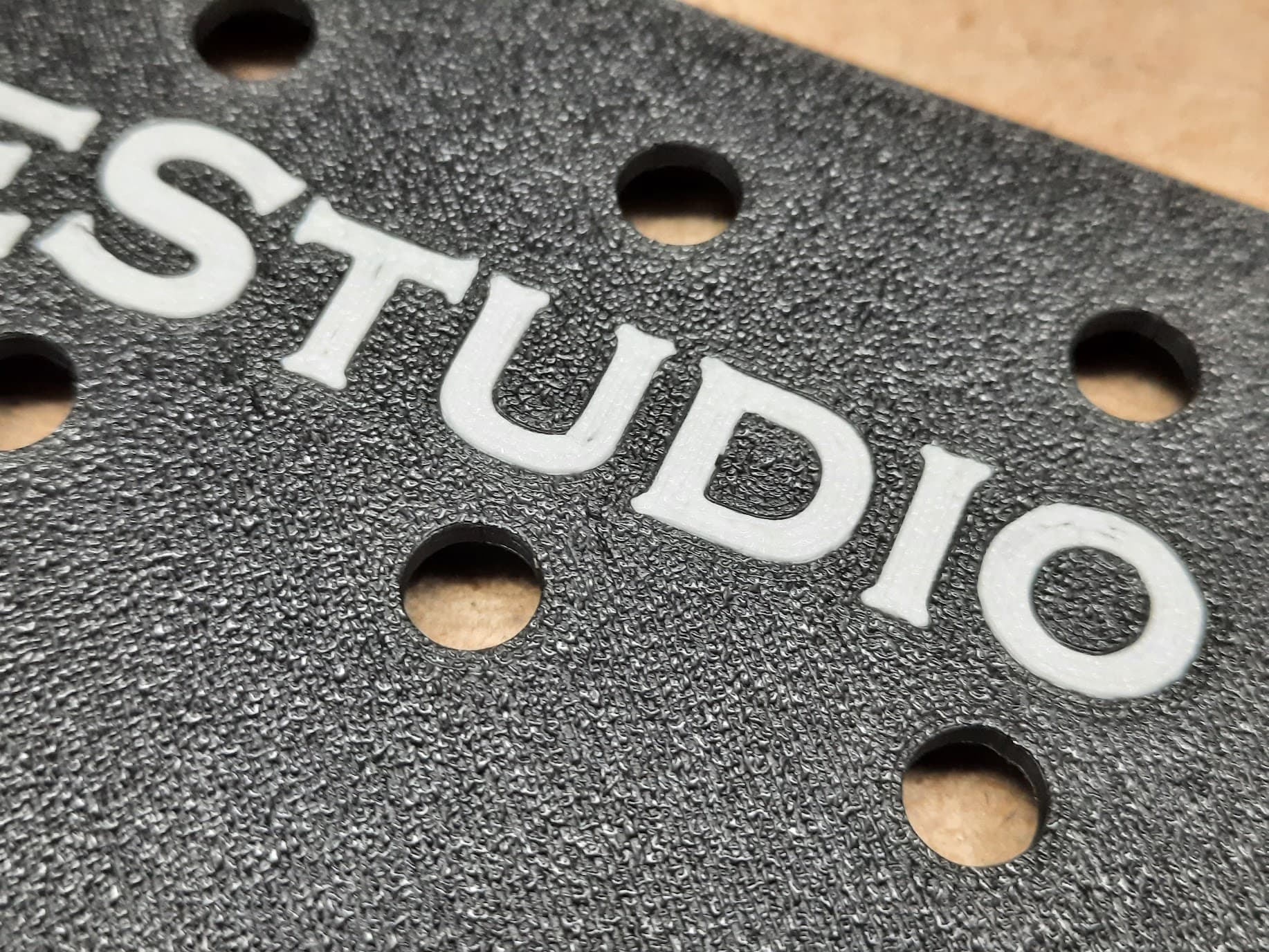

@TinWhisperer wait until you start doing multicolor prints.
Top layer example.
Bottom layer example
I do all this in Fusion. Top layer is simple. Bottom layer requires a couple more steps then tweaking in the slicer.

Print the two color badge. It blew me away with the detail.
