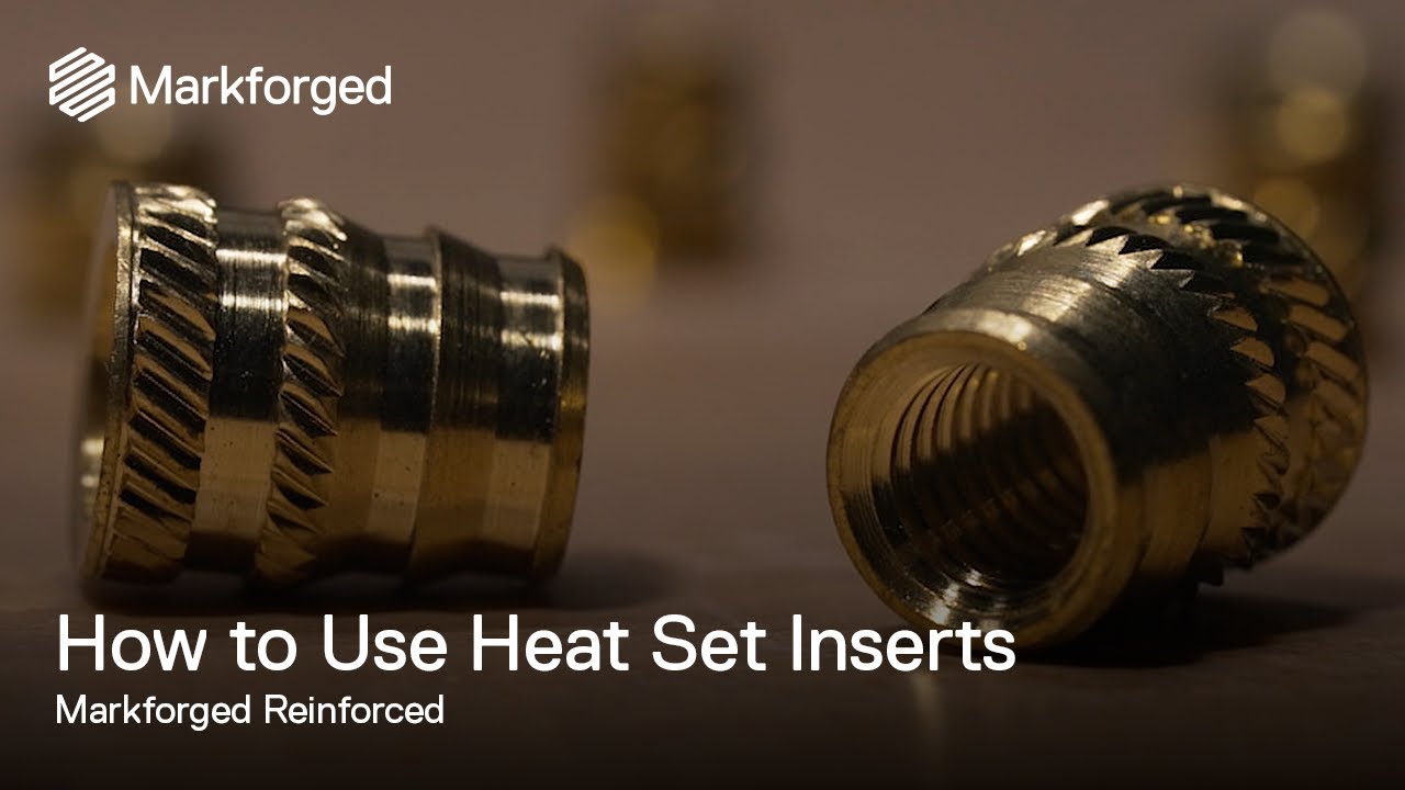

Haven’t read the whole thread, but for those of you struggling with threads, or just want a better and easier way, I just found these brass inserts for 3d or plastic parts browsing on amazon. You make the hole the right size and push the brass threaded insert in with a soldering iron to heat it up. It melts into the thermoplastic. I just ordered some today to play with.

It did take a little playing around for me to figure out I needed to offset the threads and I also rounded them which seemed to help. These do seem like a much easier alternative. I ordered 100 of them in my normal 1/4”x20 size to try out. Thanks for tip!
