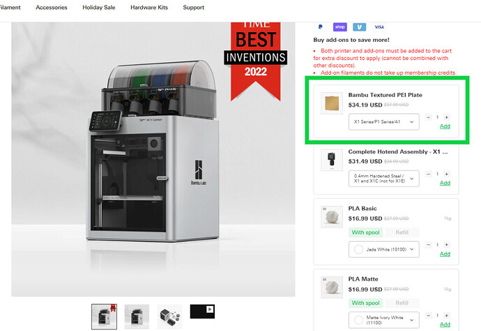

One YouTube influencer stated this textured plate is a must have:
I believe Craig (@holla2040 ) said a similar thing. I guess getting the first layer to stick is one of the most crucial first steps to a successful print.

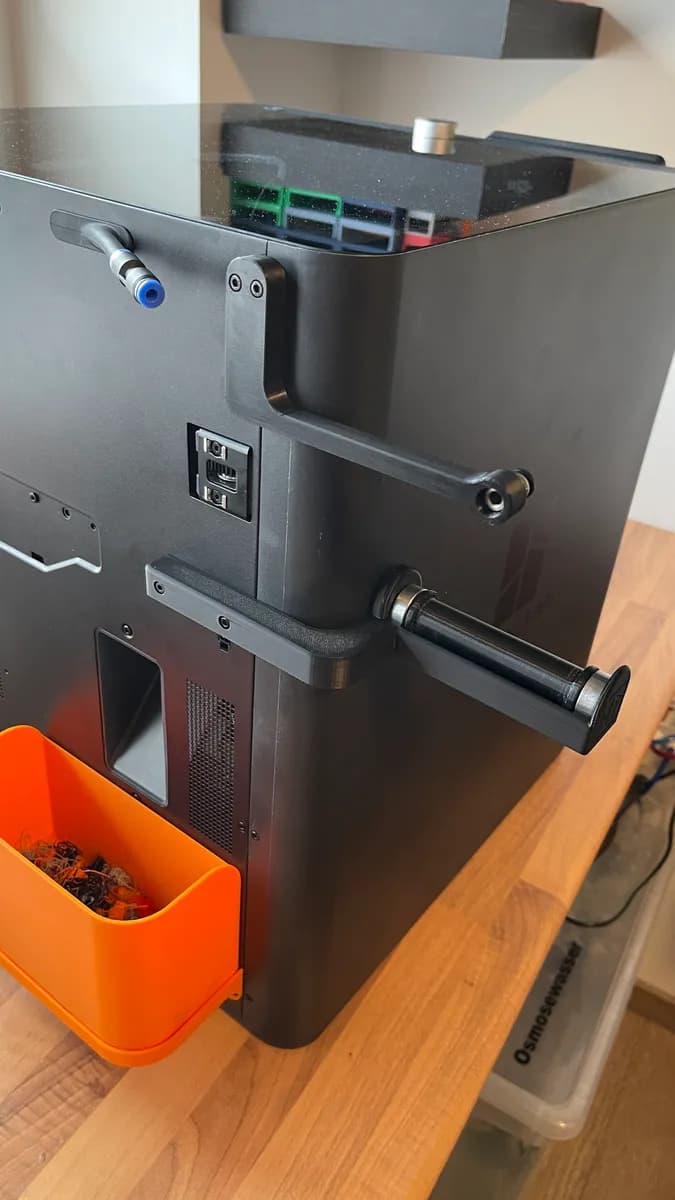

The PEI is a must, no fuss. I was sold from the first print and will never go back. Order some matte PLA to see the surface quality difference. I prefer matte. If you’re going to print TPU or other without using the AMS, get a little piece of PTFE tubing for spool holder.
https://www.printables.com/model/658927-bambu-lab-side-spool-holder-p1s-p1p-x1c
The PEO and PET plates (aftermarket) are good to.

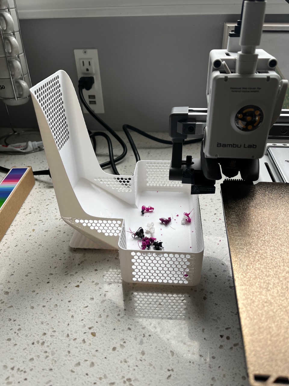

I made this poop tray yesterday afternoon.

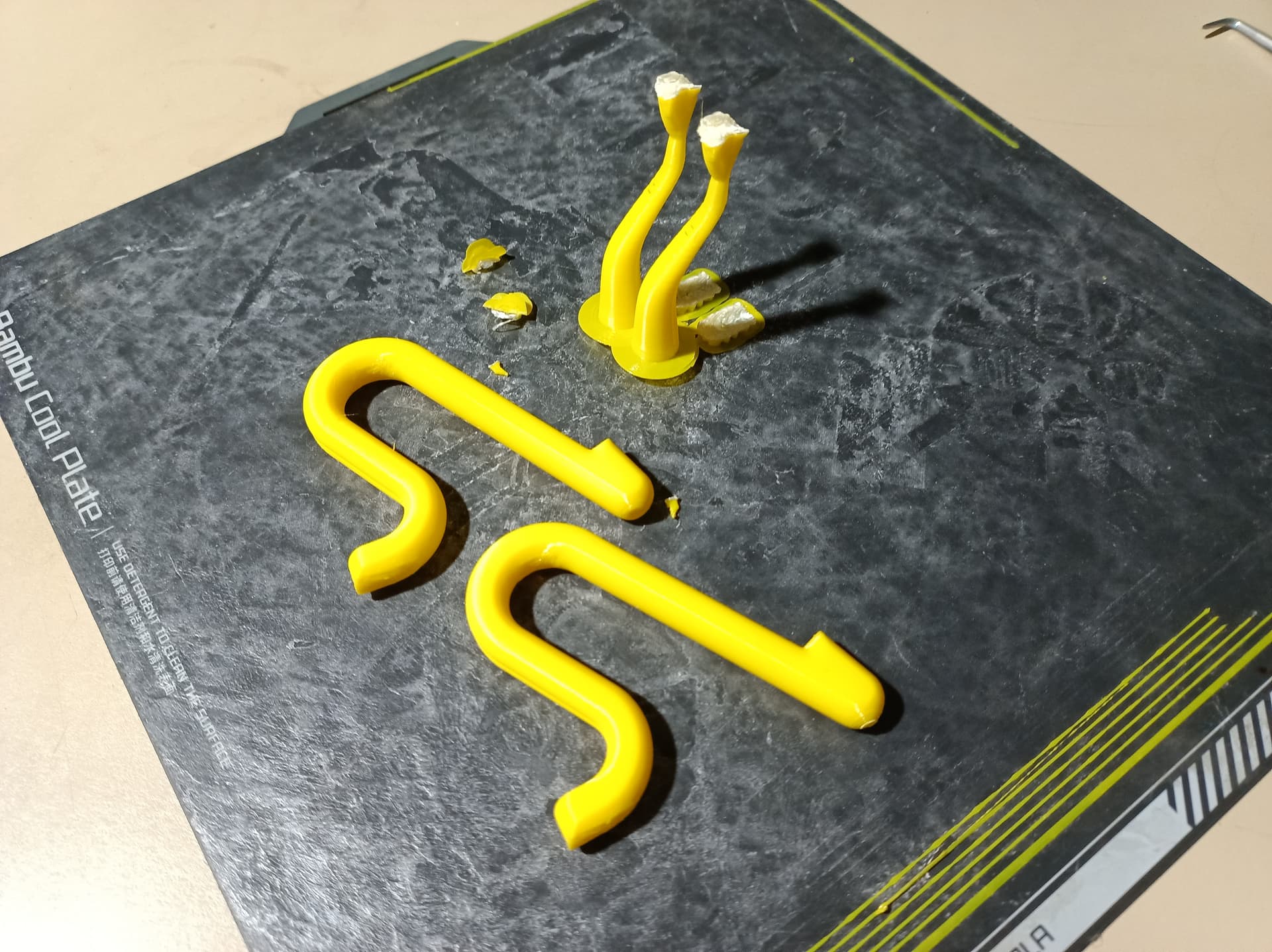

Well the last set worked out so well I printed a second set. This time I use the same PLA for the majority of the support except for the interface between the support and the part.

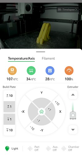

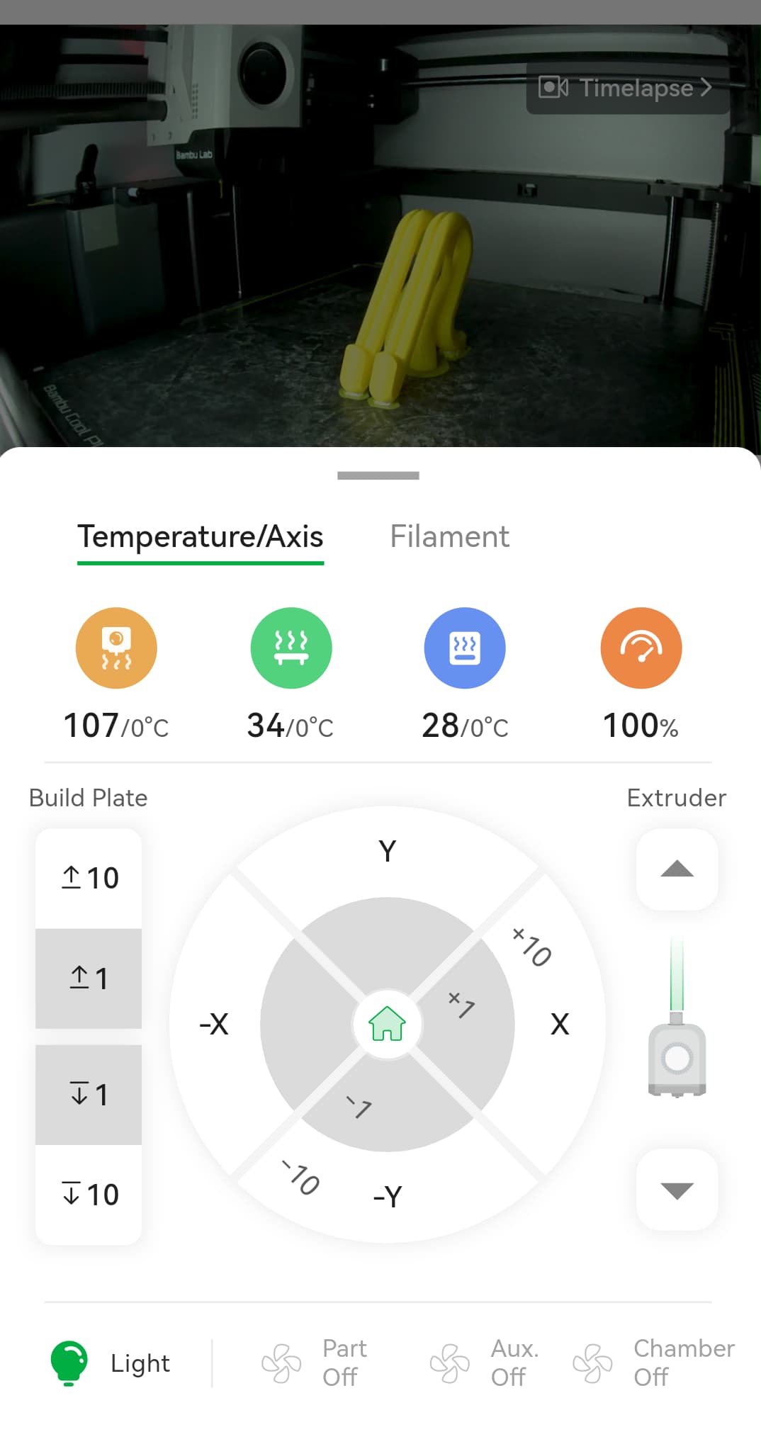

I’m out of the house in the next few hours taking my son to a birthday party. This print just finished. I have to train my wife to change the build plate. Have to come up with it clever approach too convincing her.

That support structure is fascinating. I assume that it does not actually attach to the piece. Is it a different material so it does not stick?

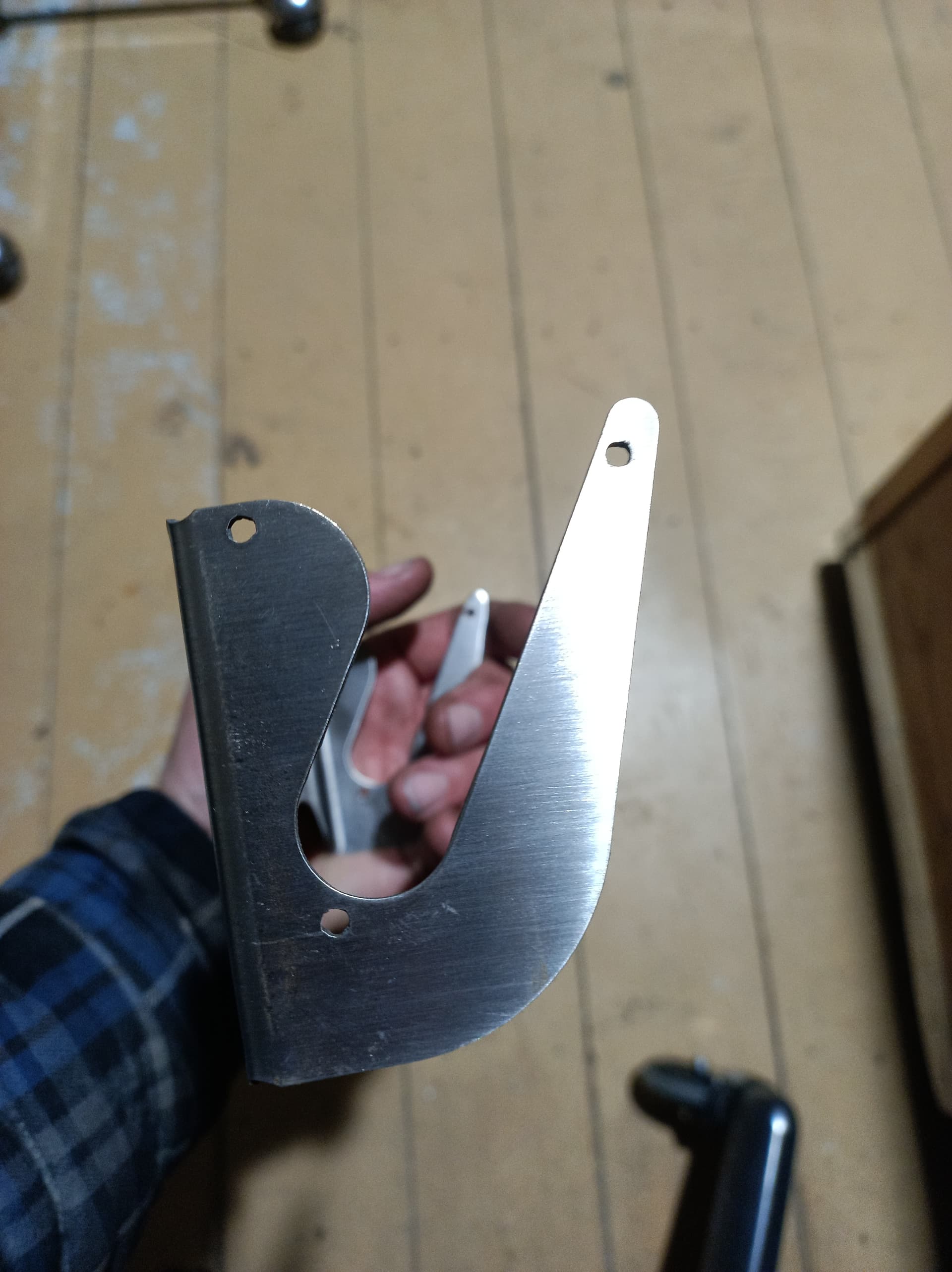

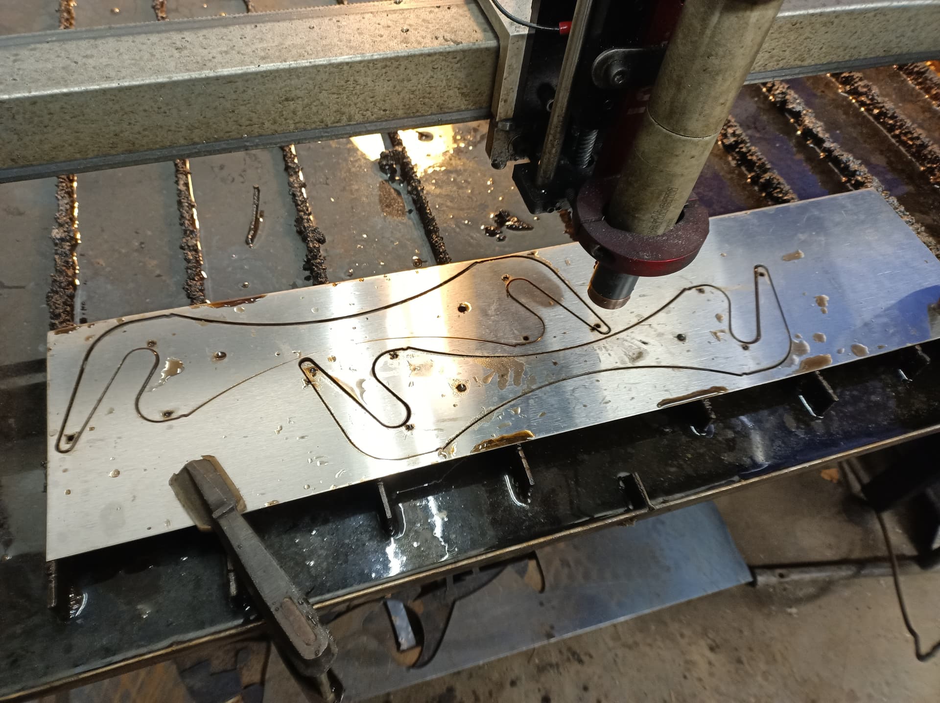

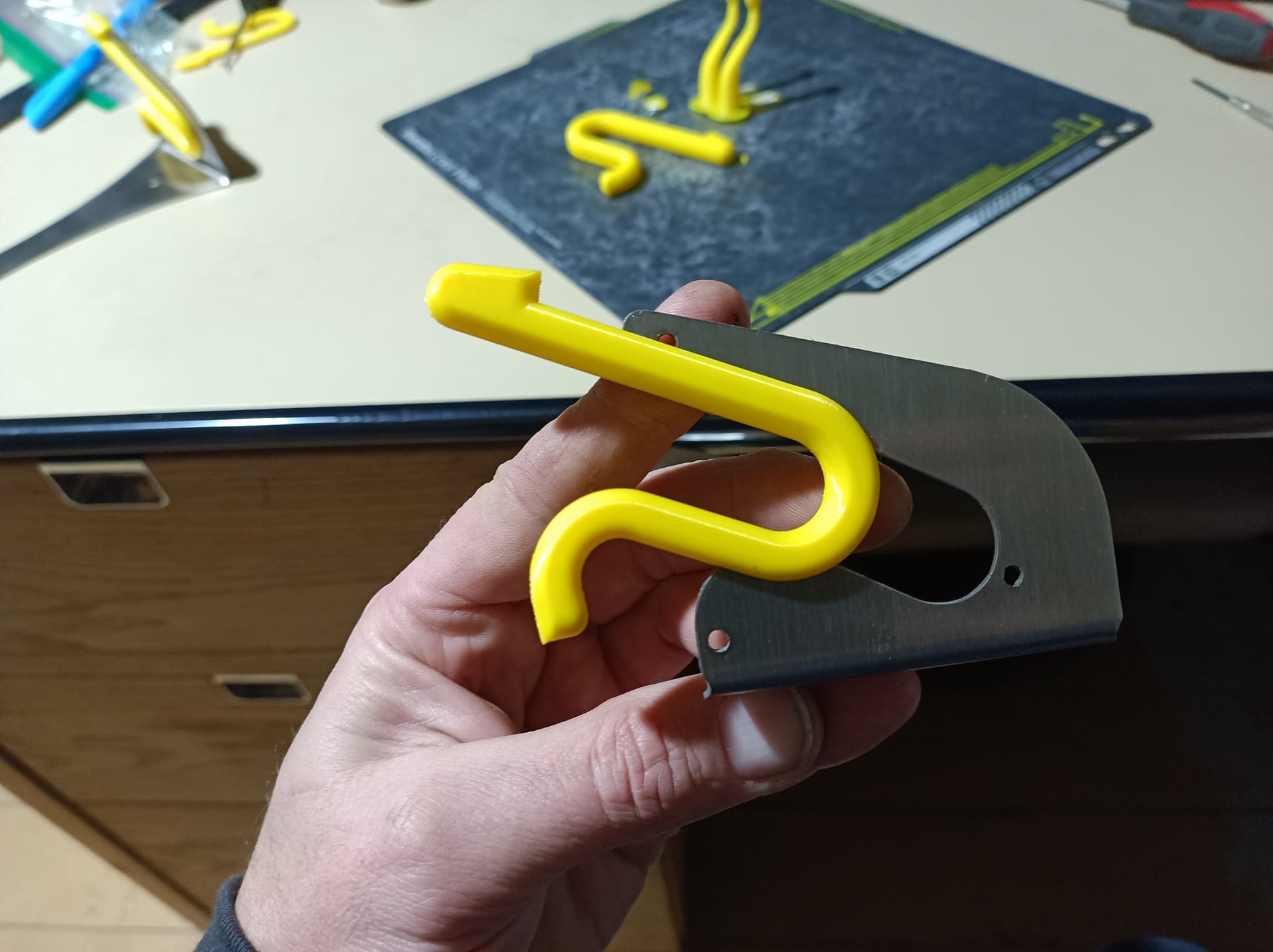

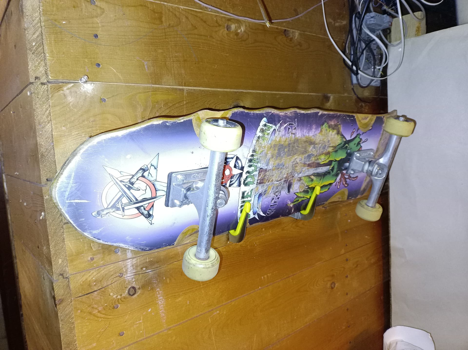

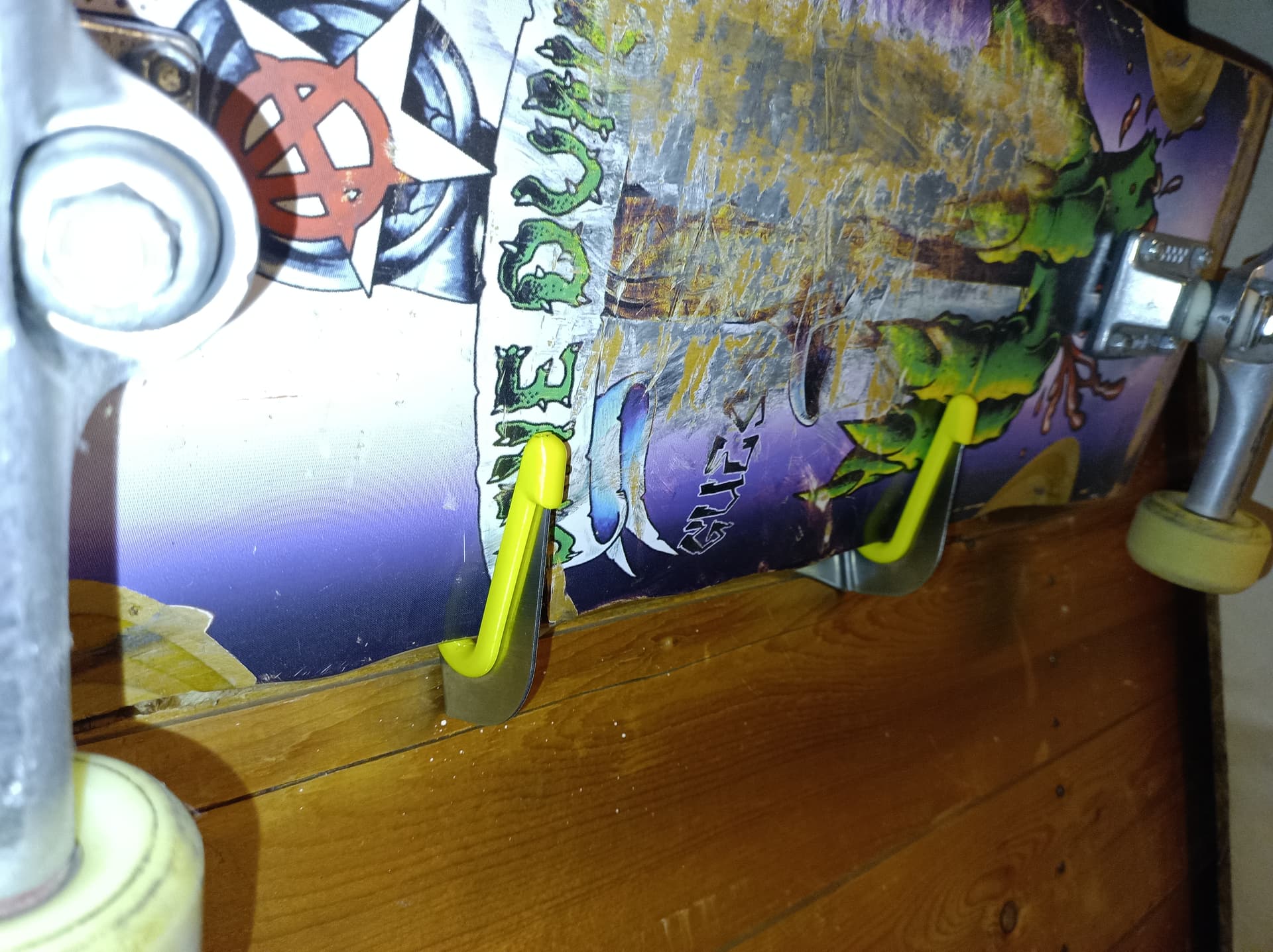

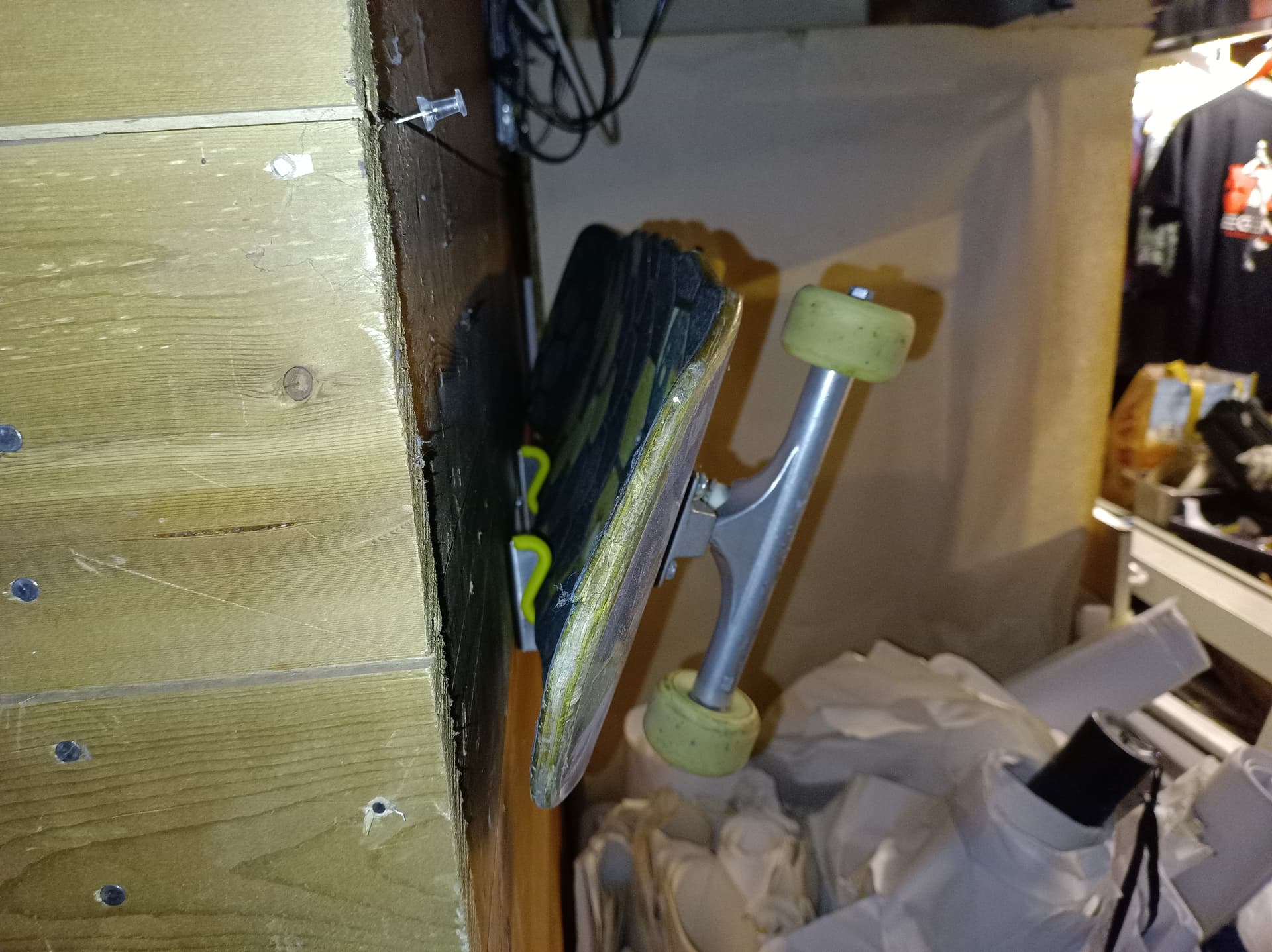

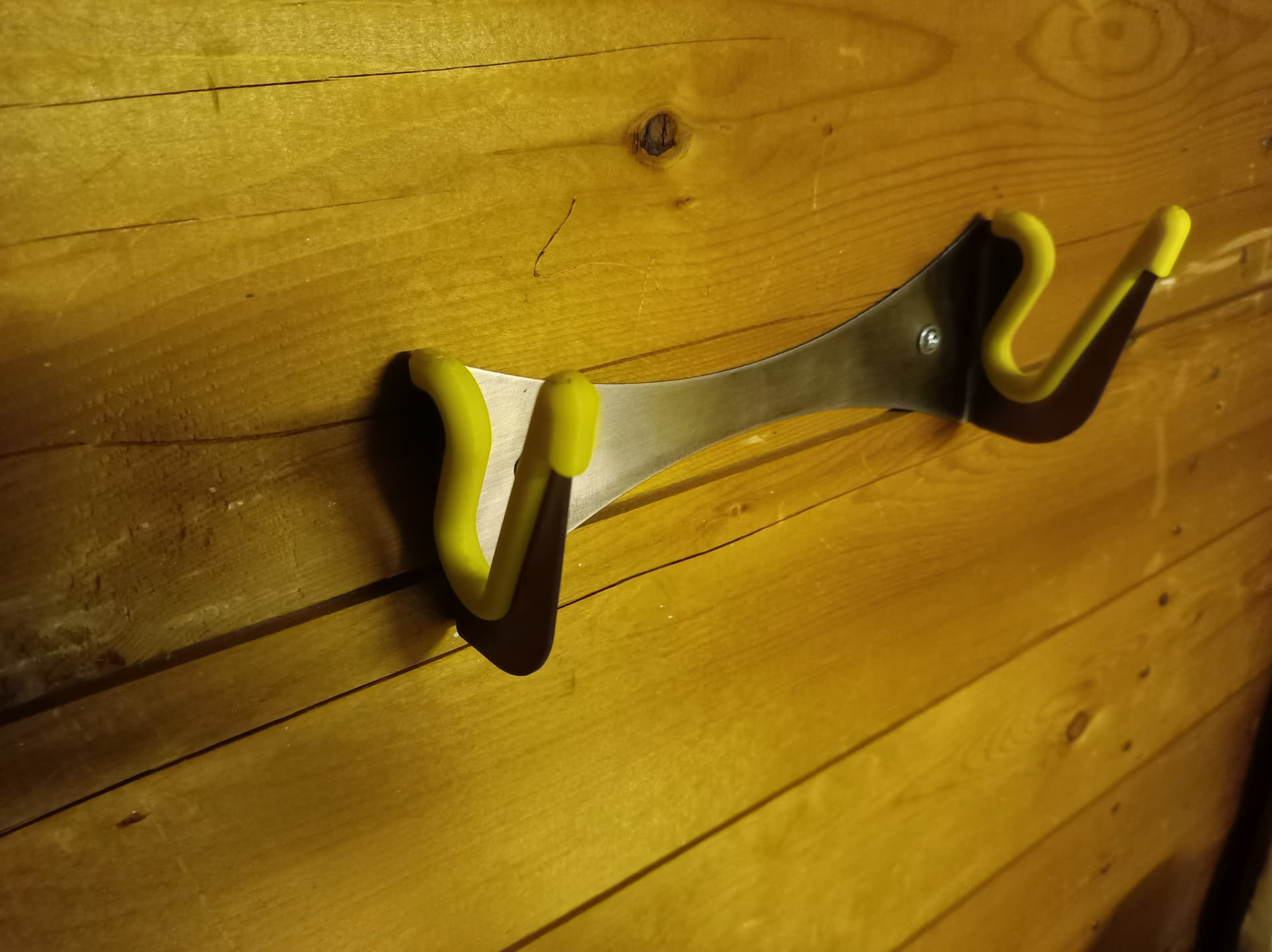

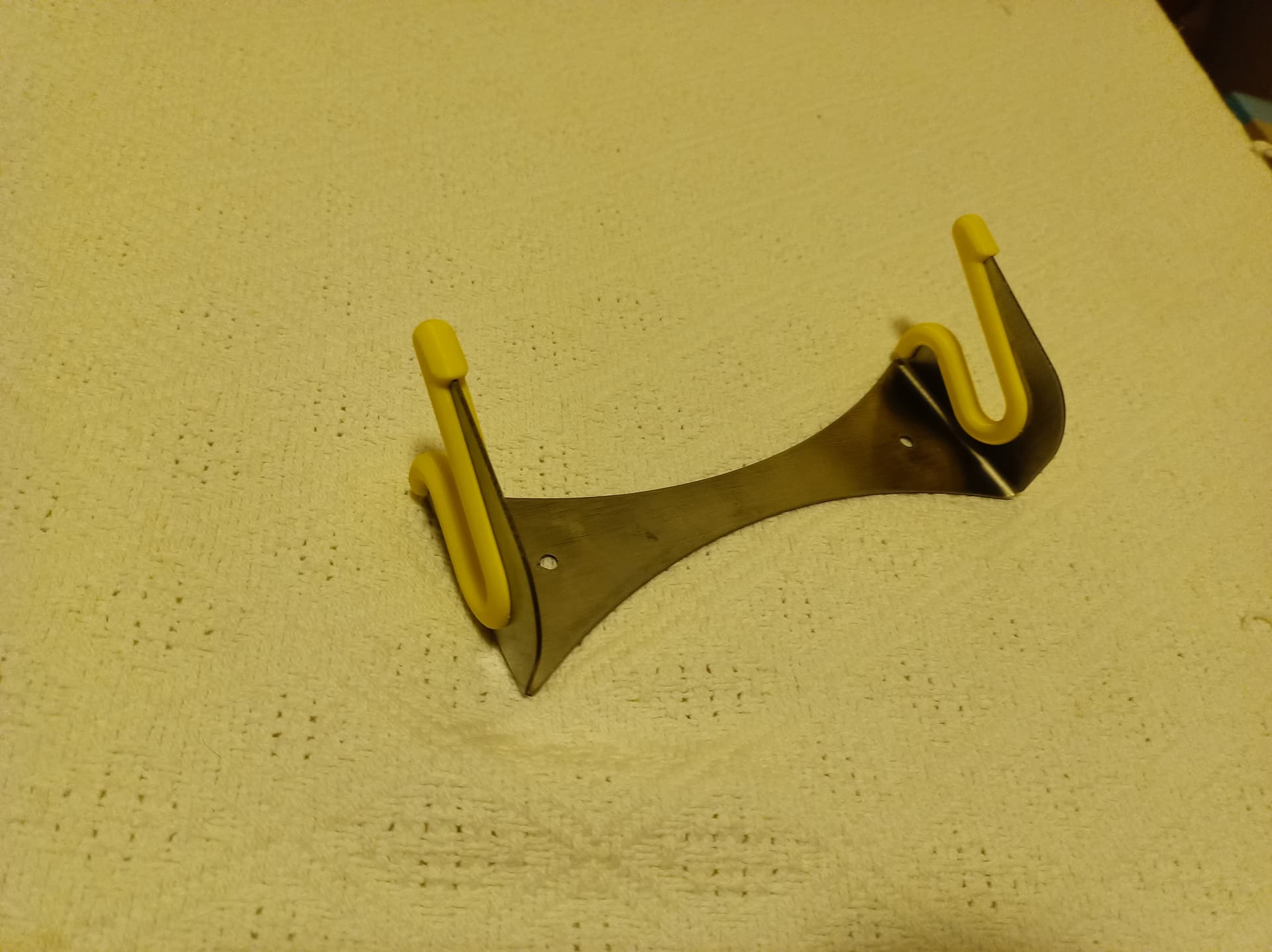

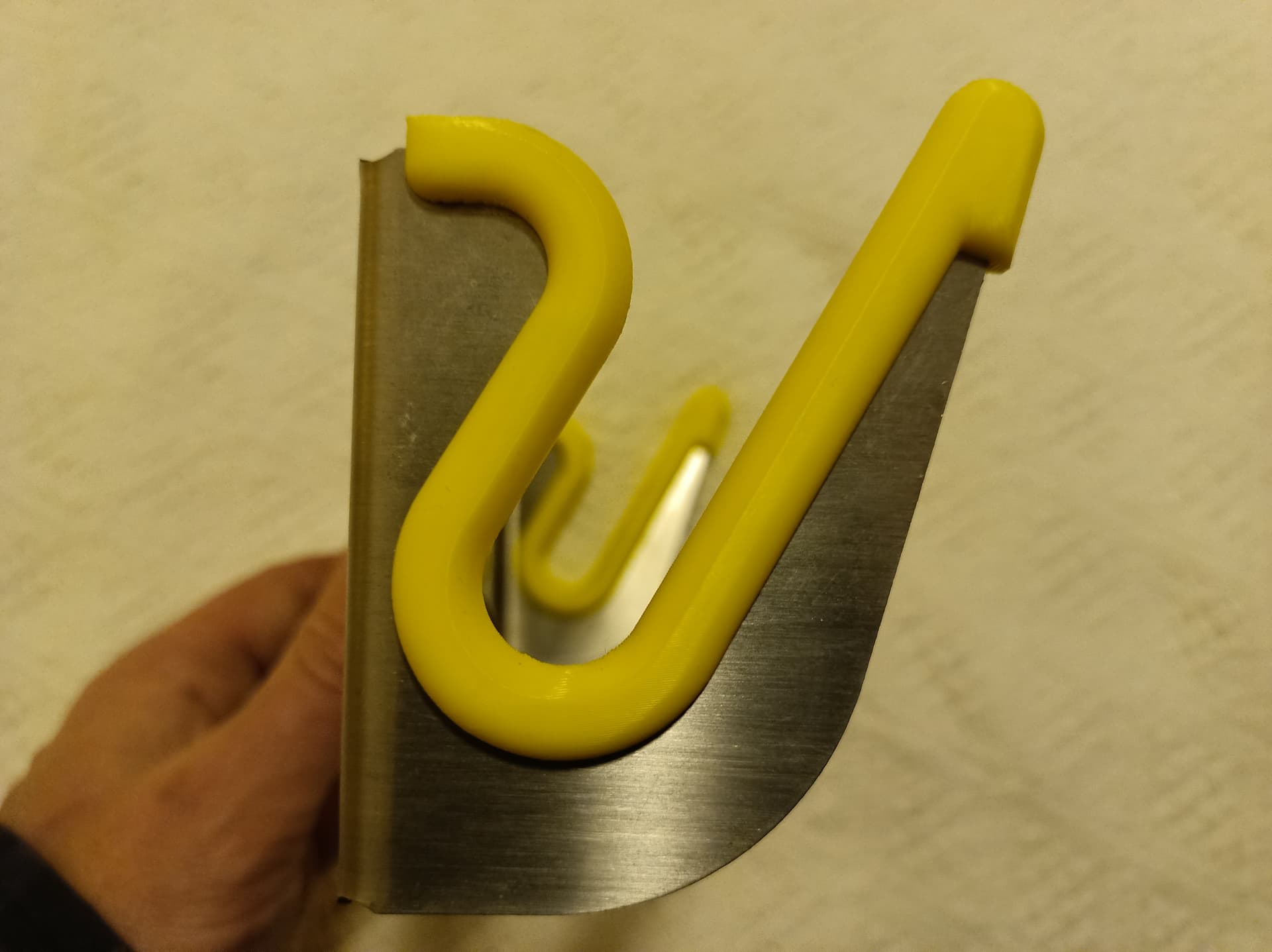

Everything worked out with the print and everything worked out with the cutting and fabrication.

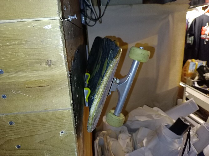

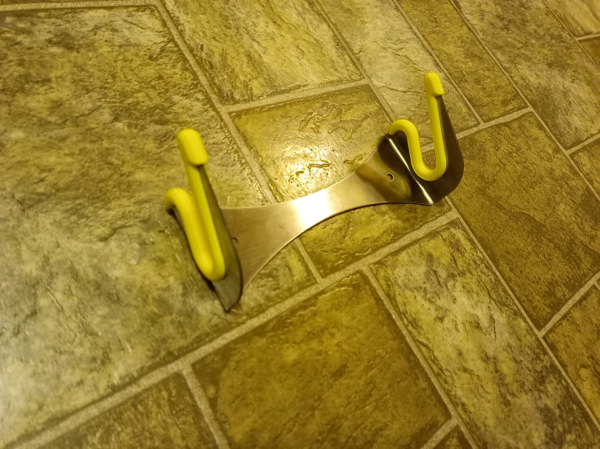

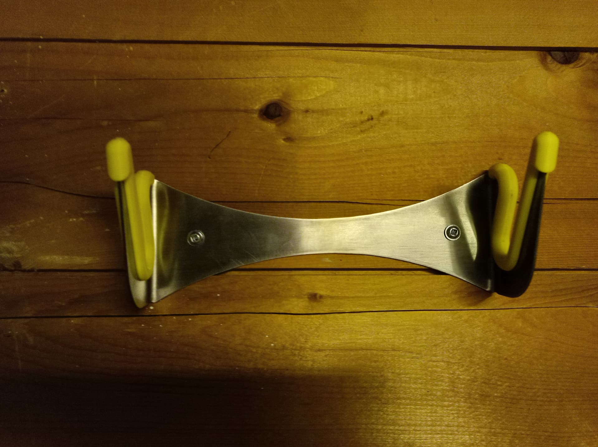

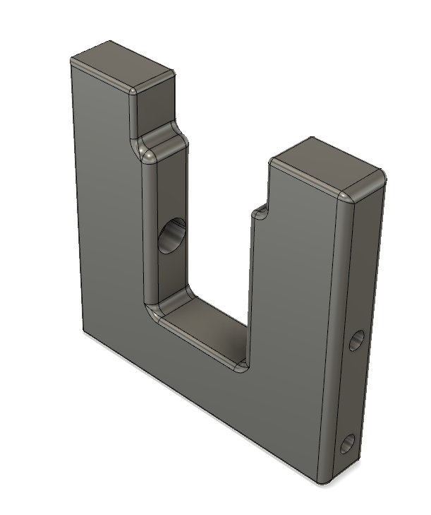

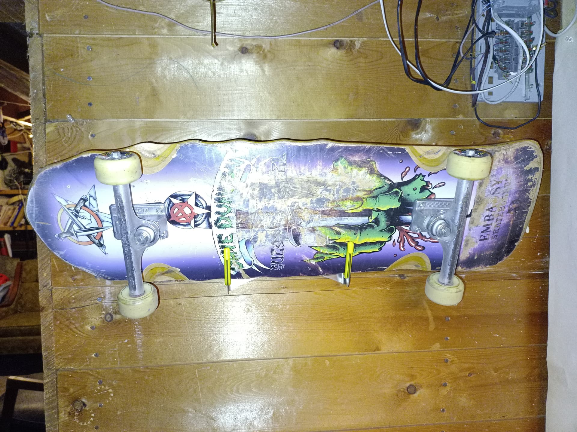

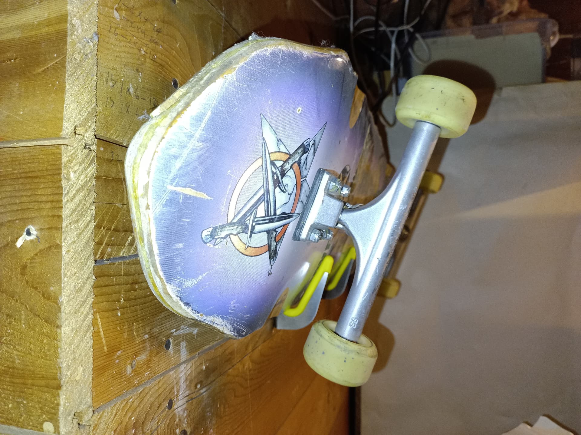

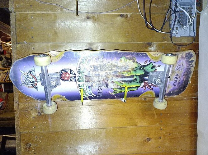

I designed this board holder to be mounted on a wall.
@ChelanJim basically hit the nail on the head
I’ve been itching to post but I had birthday parties to go to and Christmas parades and all kinds of other fun stuff out in the real world.
The 3D prints are for capping the edge of this stainless steel hanger, keeping the edge from marring the boards. Inside these yellow caps contain three compliant mechanisms which each have a dome that snaps into the holes on the stainless steel, locking the part in place. I have a few cross-section views on my computer, I’ll post tomorrow, here’s a photo dump from my cell phone. I’m very happy the way all this turned out. My mind is just spinning with things I want to do.
I am guessing that is what the first ADAM print was. Your arms would have had to have been way thicker all the way around like the front (about 50% of the front, and maybe a large fillet to make it wider to support the weight and use.
Make it a 3 piece (back and 2 arms) Print the arms vertical, and the back on its back.
That being said - awesome job blending the two products together! TPU would be another good choice for the buffers

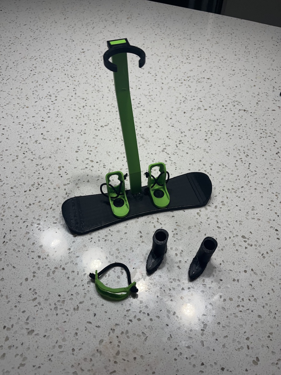

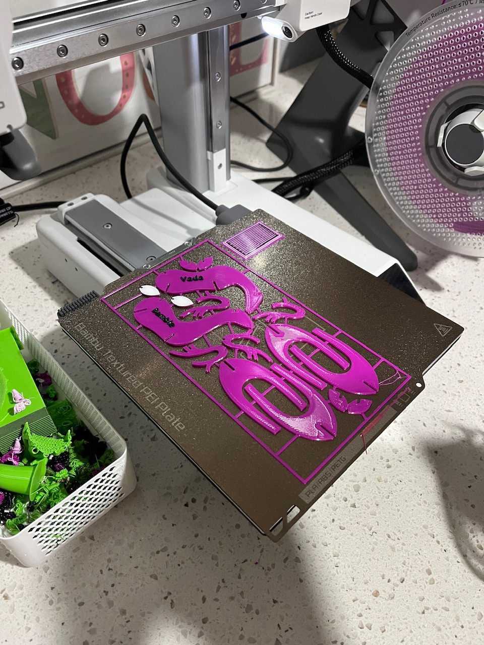

I made these overnight. I’m going to have a really happy little girl this morning…

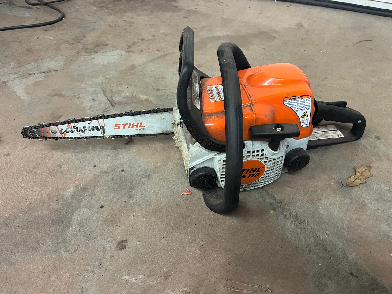

I’m neglecting my stihl carving chainsaw. This is the time of the year I like to be out making saw dust.

I like the board holder!

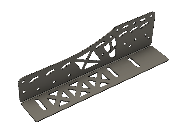

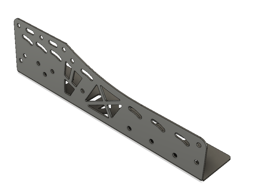

Here is my ski rack so far. Ski holders were designed to be wrapped with a 1”x3/4” aluminum channel.
Prob some changes ahead still…
Will prob do one out of steel as a prototype before aluminum
Added places to hook bungies so it can also be used as a cargo rack.
