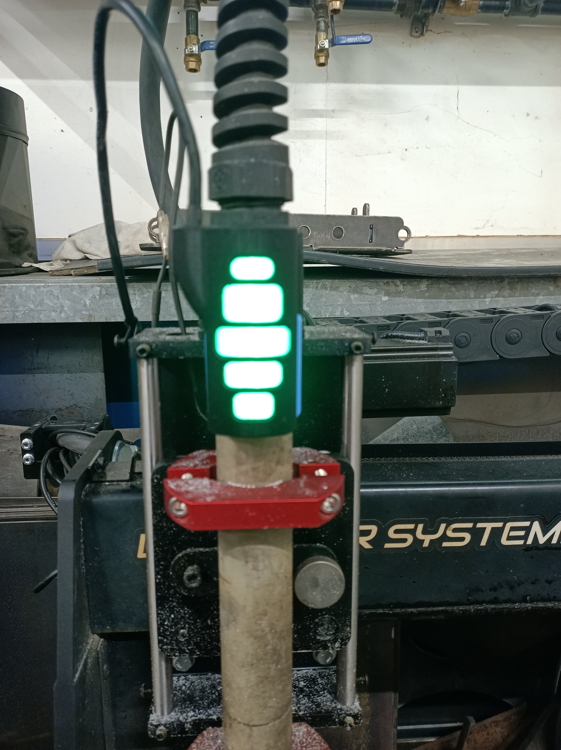

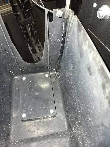

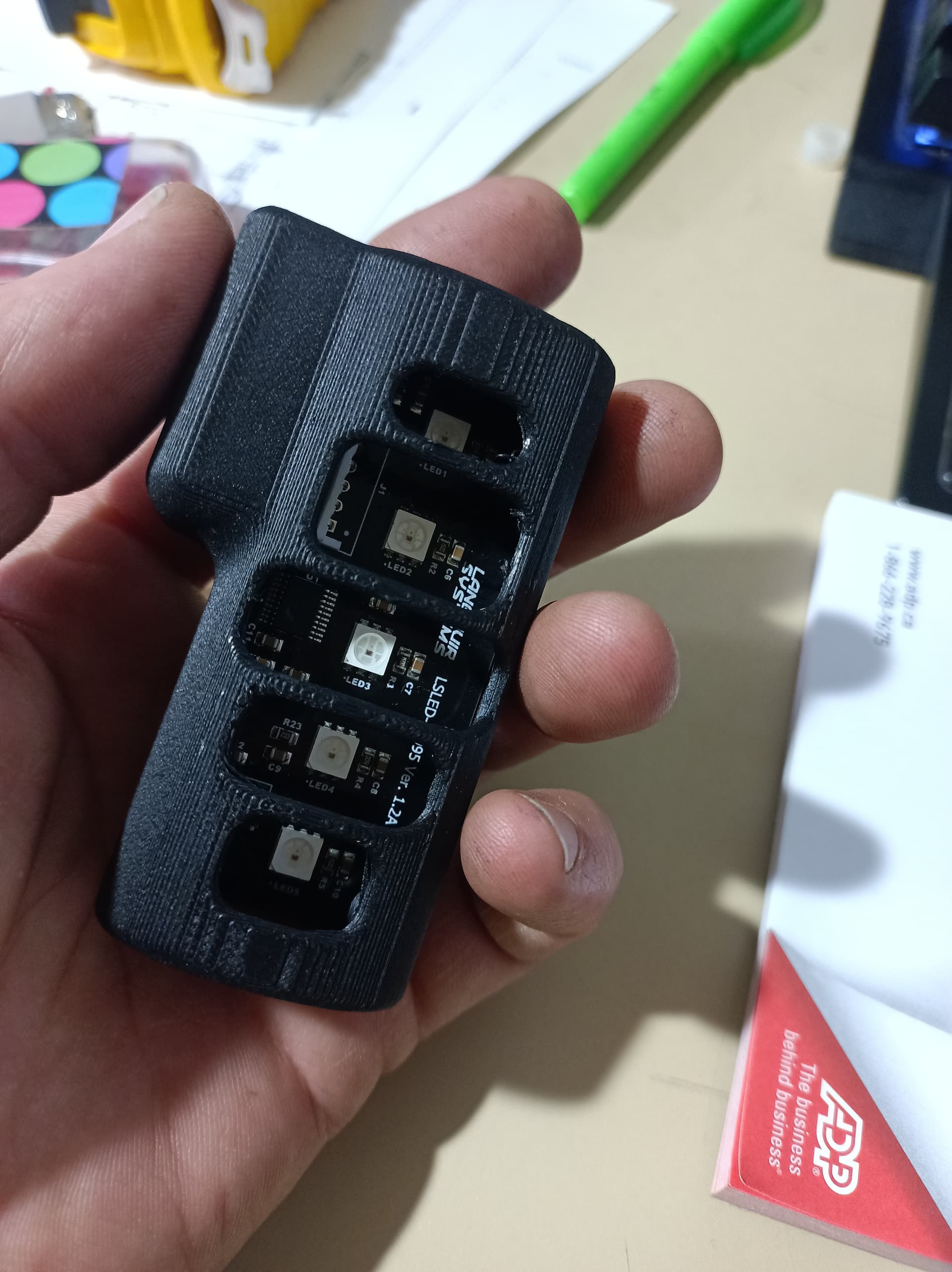

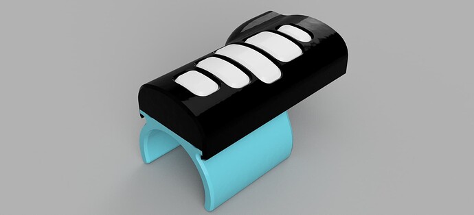

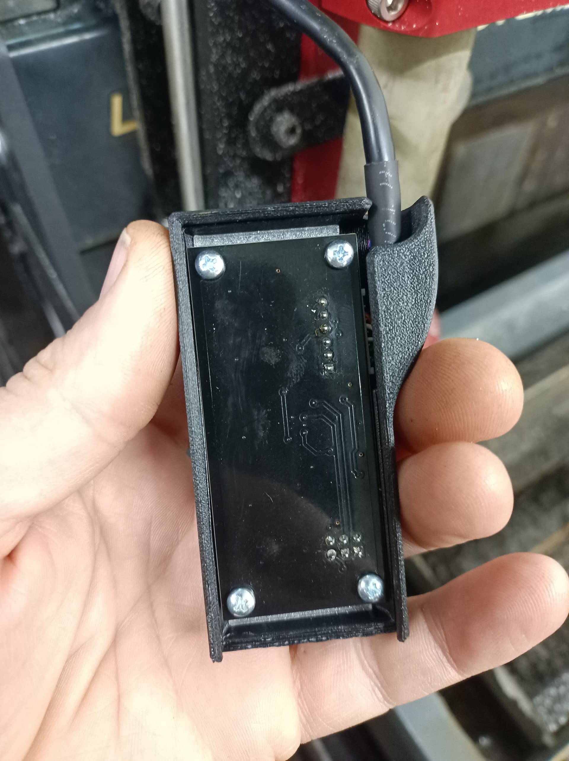

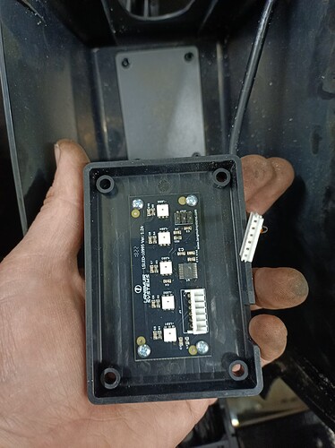

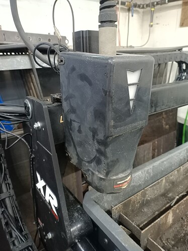

I found the XR shield / light indicator for the z-axis cumbersome and not super effective at keeping debris out. So I harvested the LED circuit board from the cover and made a small housing for it that clips to the barrel of the torch.

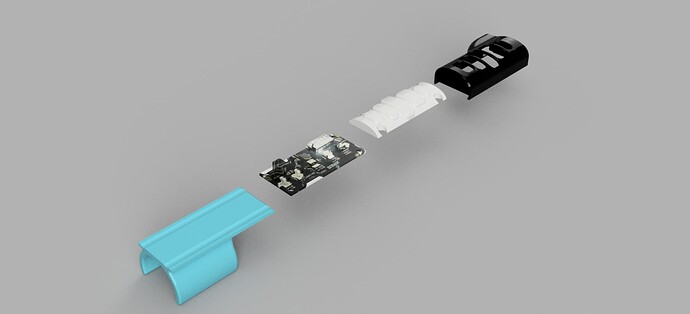

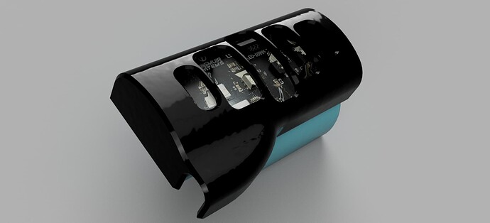

Design this in AD Fusion and printed it on my Bambu X1C.

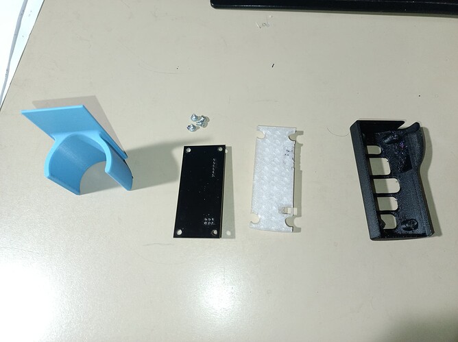

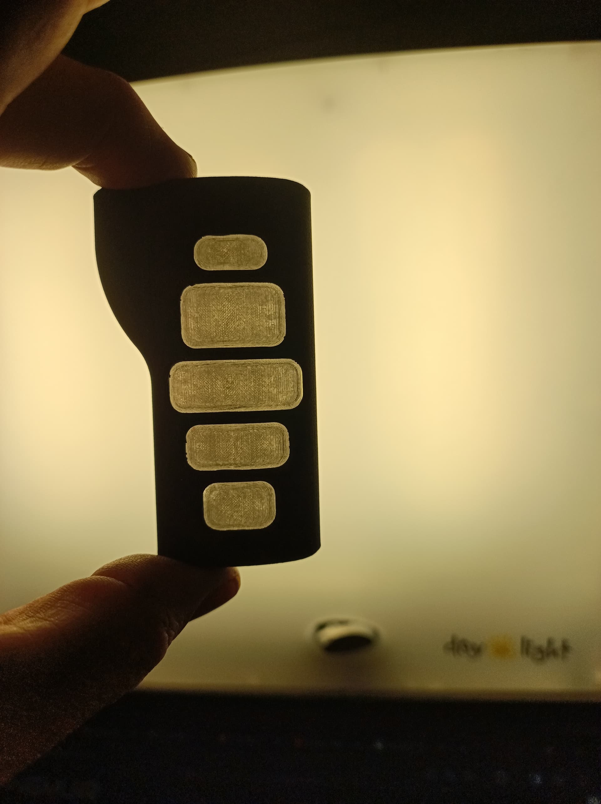

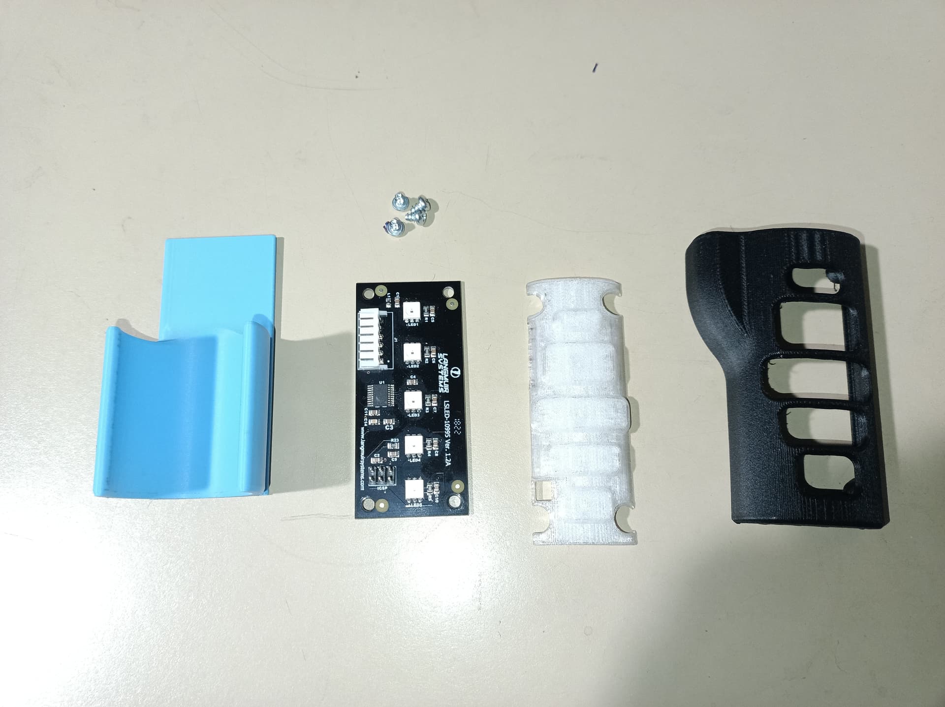

The housing is made from black PETG-CF
ezgif-6-0a47bc4a4e

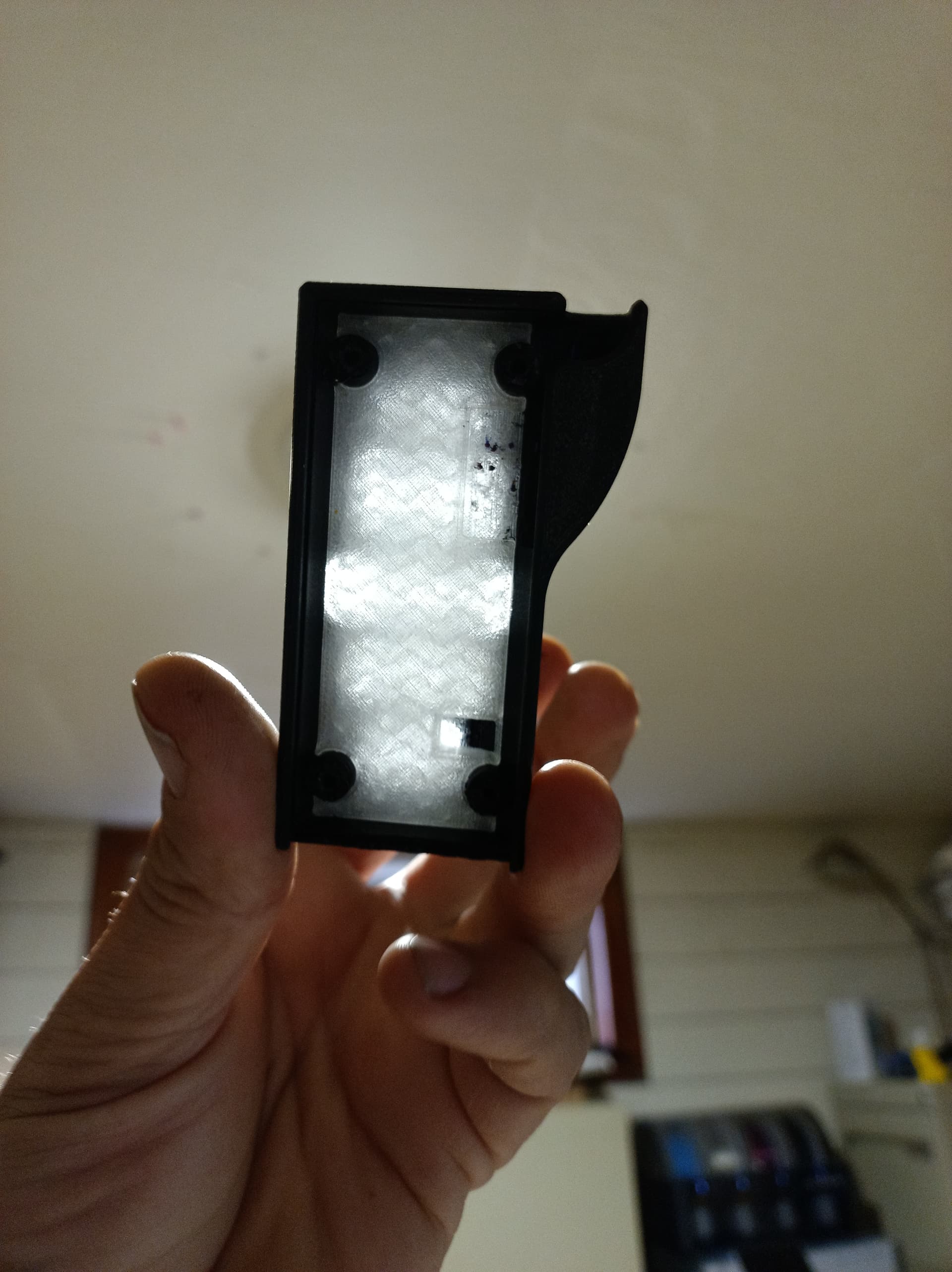

The light diffuser is made from translucent PETG-CF
ezgif-6-7bf57f884f

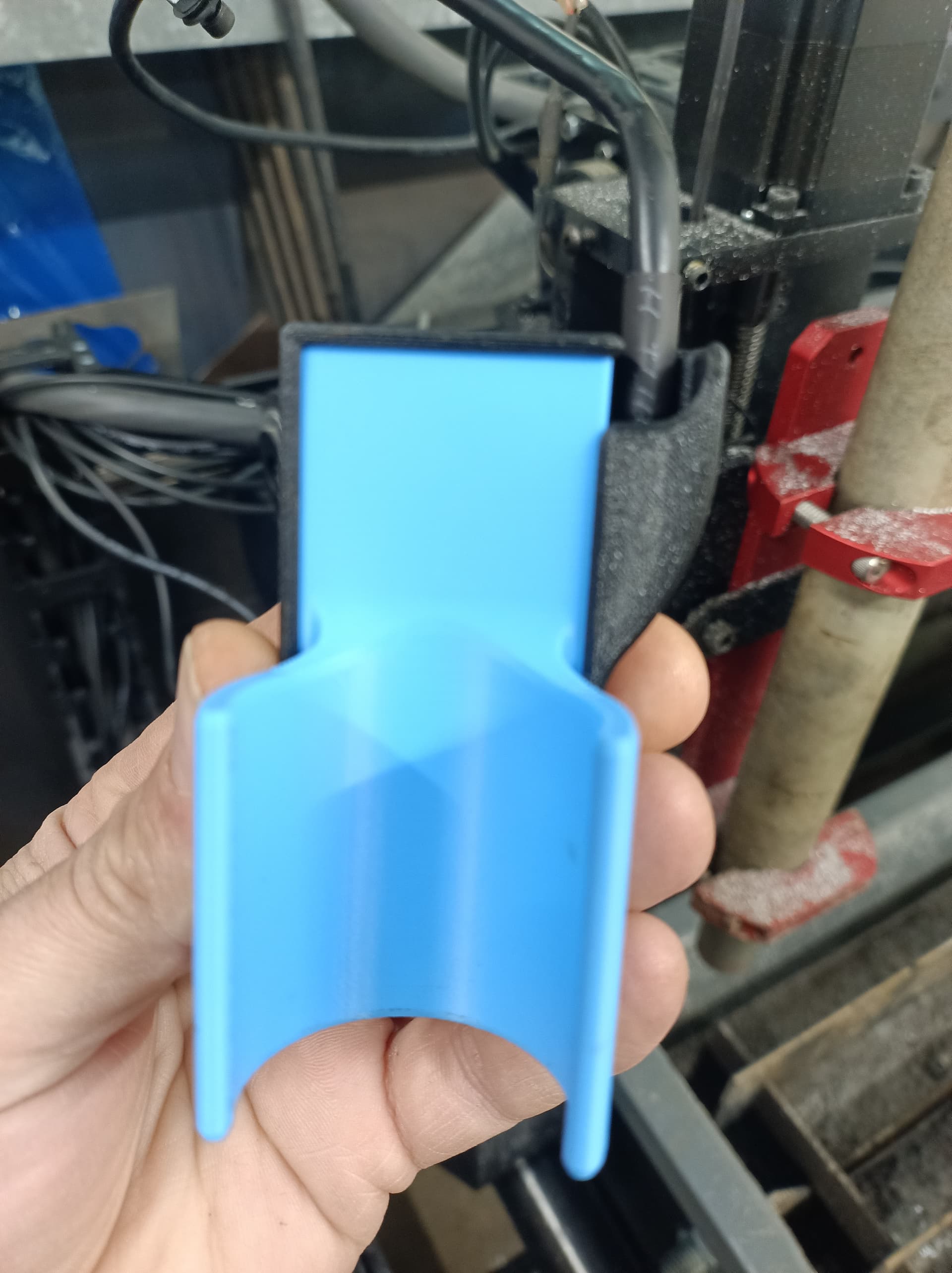

The torch snap clip and back plate is made from Blue ABS ( likely would have done black but I didn’t have any)
ezgif-6-319818a29e
