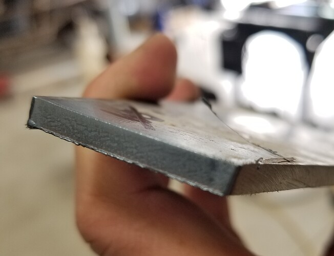

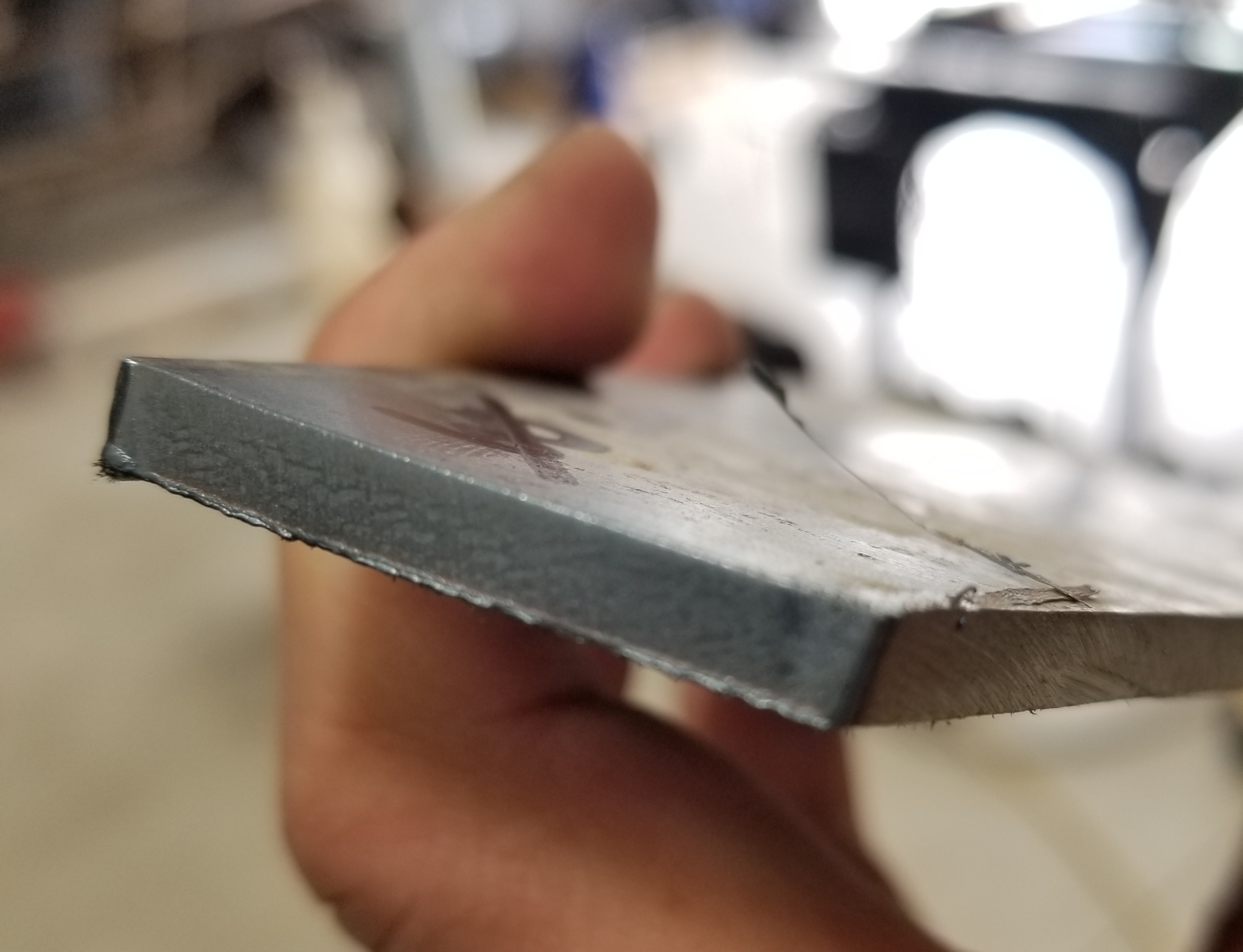

cant resist posting my first cut. Primeweld cut 60 maxed out on 110v so 30 amps at 30ipm
