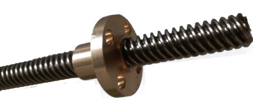

So I been running the pants off this PRO since sept. I cut alot each week. Lately Iv noticed my holes getting bad. Normally that is due to lead screws slipping in the couplers. So I usually jiggle all the bearings and holders etc. I noticed if I pushed on the bearing side of the X asis as it glides on the Y rails, I could move the whole X asis about an 1/8 of an inch even with the motors on. So I checked opp side and same thing. Well I have a brand new PRO setup right next to it, not even ran yet and it has zero movement. So I came to the conclusion it was the lead nuts.
I got new ones (still inquiring as to why I had to pay for them, machine is under warranty) anyway I replaced them and totally fixed the issue. Its very hard to tell on the old lead nuts that they are bad, you have to fully installed to check them. As I was dismantling them I wiggled them and they had no movement, but when fully hooked up you move the whole setup.
So just thought I throw that out there, check your machines often, things loosen up and or go bad. Also if anyone has any better ideas for lead nuts Im all ears. I found some brass ones on ebay but not sure if they are same bolt pattern. thread is the same.
lead nut brass
I wonder why they had no movement on removal, but had the movement when installed. Seems weird. This is something I had thought about though, the lead nuts are delrin and with them being against the steel lead screws, I imagined it may wear out over time.

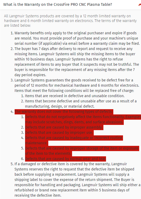

Warranty states ALL machine is covered for 1 year minus electronics for 6 months. Iv had multiple bearings go on my other machines, they sent me bearing packs. Yeah I get the wear and tear, but warranty says 1yr and it falls under that by months.

now as for warranty…not sure where you get “ALL machine covered for 1 year”…here is the statement for the PRO right from the website…limited warranty…
I have highlighted the not covered normal wear and tear…
Like I said, Im not saying they have to sell it with a better lead nut, but seriously a PRO machine needing new leadnuts 9 months in, and not to mention cheap couplers that stripped long ago. Iv dealt with plenty of maintenance on these machines. I cut over 15hrs week on them hard, back to back cutting. There is no machine on the market that comes close to the cost and reliability as this one. SO that couple hundred more for better parts to me isn’t going to make or break a sale too much. Or simply offer better products as upgrades. They have scaled really well and with the XR that will be my 5th machine I’v purchased from them. Im loyal to this brand bc of their growth. Im not trying to tell them how to run the company, but if little things can be dealt with from reliable feedback, then I think that is helpful.
As for the warranty. the first sentence says it all. 12 month limited warranty on hardware. the only hardware on the machine is bolts, lead screws, nuts, couplers. The bottom where it states wear and tear is really just a loop hole that contradicts the first sentence. So you when a bearing bites the dust two months in, we can all agree that is covered or that is wear and tear? Lead nuts failed at 9 months in, running 15hrs a week. So running 40 hrs a week these things wouldn’t last but half a year. What is seriously going to fall under warranty if not under wear and tear, you use the machine once and its wear and tear. Just like the electronics, they need turned on and used and they are covered for 6 months, is that not wear and tear?
