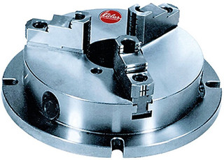

Has anyone found a low profile lathe chuck for the MR1? Looking to add one .
This is what I use. I did make a 6 chuck but it was too high for most of my projects.
If you work with round bar alot, an ER40 chuck is low profile and easy to mount. ER40’s also have oversize collets that go up to around 1 5/16", so you can do alot. Recently I had to make a 1 5/8" cutter from O1 to mill flash hider slots, so i did it from round bar that was turned down on one diameter to mount in the collet. I get that it isnt the same as a 3 jaw chuck, but its a must have for me. I have to make a ton of custom bolts and nuts for work and the MR-1 does a good job for that using this chuck. With the adapter I made, its shorter than the tool setter.
I have a 6" bison scroll chuck that I made a thin adapter that bolts to the table. It has bolt on jaws, so I made a set of low profile jaws to help with clearance.
One of the pancake style chucks would be bice, but that’s money that could be spent elsewhere in the shop.
