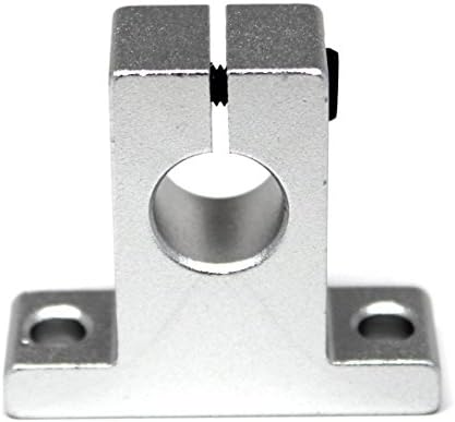

Found these laser holders on Amazon. Only another $23 for 2 of them:
Not exactly sure how I am going to mount them until everything arrives and I can mock it up but have a few ideas …
Here is what I came up with.
I made the bracket out of Aluminum for weight consideration. Because of the laser projection angle I had to bend the angles that hold the laser holders more than 90 degrees so the lasers would hit the torch tip.
The Battery holder holds 3AA batteries (4.5v) with a built in ON/OFF switch that I have velcro’d to the Z Stepper motor which should should be far enough away from splashing water to stay dry.
