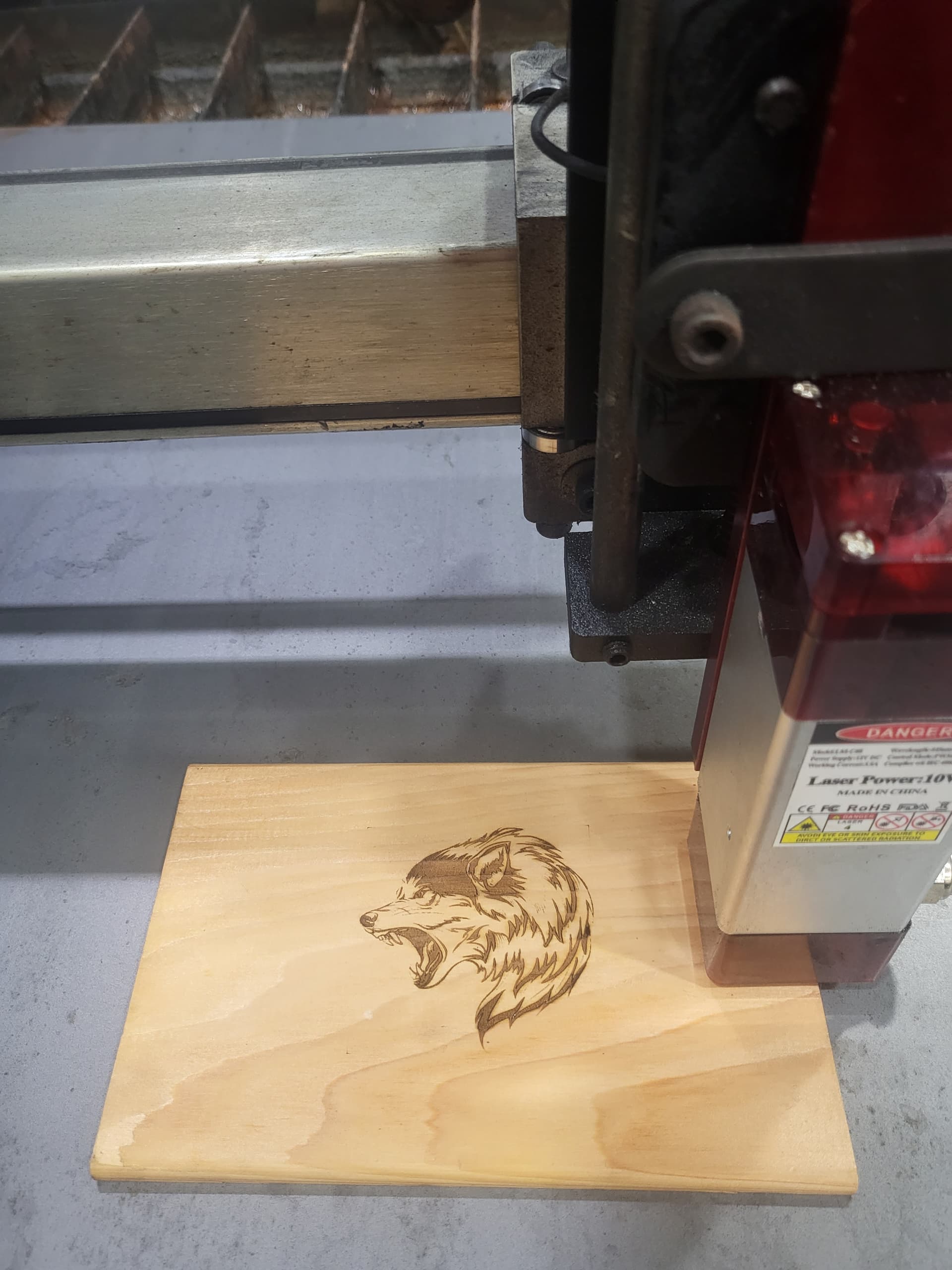

Its first engrave with my cross fire pro over kill i know
wow that would add to the versitility of the machine would you be willing to share the information on where you got the laser and the software used to do the engraving
Im not using the langmuir control box i switch the stepper motor connectors over to a laser control box i built .i had most of the parts for it in my junk box aside from the laser and a few odd and end pieces .it has grbl firmware installed on a arduino uno .the laser i got of ebay for i beleive $95 the software i used is lasergrbl it was just a project i wanted to do

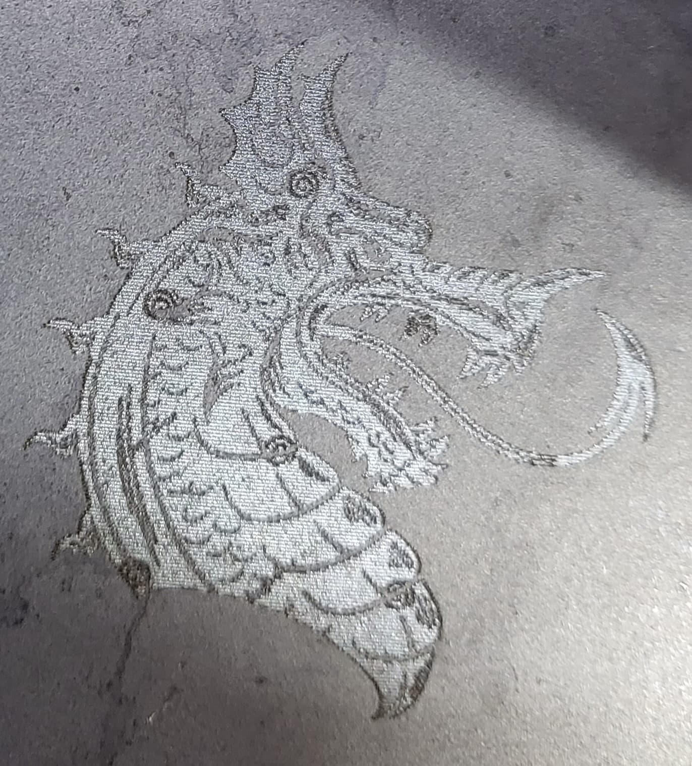

Tried a dragon head i can feel the engrave i think it cut through the mill scale however i think the easyscriber would have done better
Interesting…can you run one with the mill scale off? And thanks.
There are a couple of others out there. Cermark was one of the 2 that were the big dogs until Cermark bought out the other. The underlying patents have expired and now there are some cheaper alternatives. Cermark was $90 a can when I bought it last. Lasermark was $50. Just Google “laser marking spray”.
You can get similar results with Dry Moly Lube ($11 at Advance Auto) but it’s not as black as Cermark.
