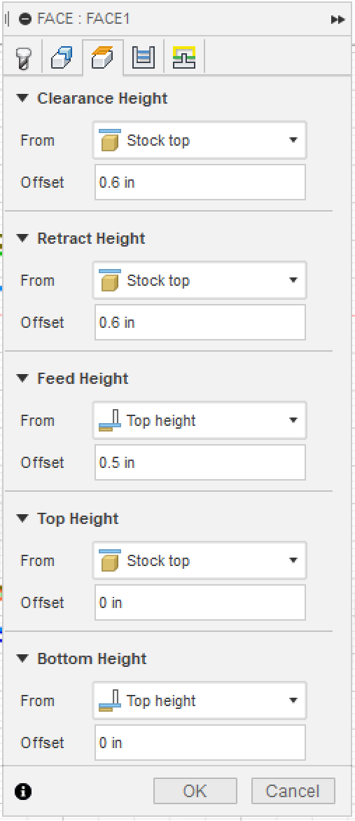

Anyone know how to change the rapid safe z height movement? I always did it in cam but I cannot see it in Fusion anywhere.
If I understand your question correct, the settings move around a little depending on your toolpath of choice. But it should be controlled with the settings on the “Heights” and “Linking” tabs of the toolpath. Another tip, when in doubt on specific settings, especially with fusion’s love of calling standard processes by strange terms… long hovering over most menu or field items reveals a lot of good info.

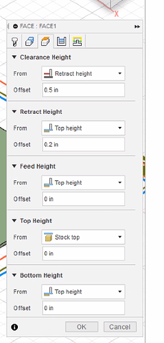

Well my friend I believe you are right. I think it is the “Clearance Height” in your toolpath Height Settings. I have mine set to .400" from Top Height which I dont know what the top of would be. I would think that once you zero your z work piece then it would retract +.400" above the Z Zero BUT I think I could be mistaken because it actually moves to the machine .400" from the machine zero which is a little confusing to me. The word definitions that Fusion uses is not like other programs I use. There is retract height, feed height, top height, etc. Those 3 are a bit confusing to me. I changed it to Stock height and will see what happens. I am trying to learn this in short time until I figure out the post processor on my other software. M6 commands and a few other commands that Cut Control does not like.
Well we were completely wrong. I changed the Clearance Height to StockHeight 1" and it made no difference. When I start the program raises the Z to +4.100 above the work piece then drops and starts cutting. I just dont get it. I am not likin Fusion so far. There is literally garbage info on these definitions like Feed Height or Retract Height. What does it retract from/to??

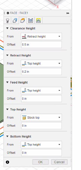

Well that definitely helps although it makes me even more confused. I sometimes get so burnt out on searching for solutions I miss a lot. My retraction on rapid move is over 4" above the work piece when it travels to its first cut. I suppose it is coded into the post?
Looking at your pic you have your bottom height set to “top height” with no offset that’s why.
The bottom height is the lowest the cutter will go. Everything in your heights tab looks to be Z positive moves.

Thanks for the reply. Trust me when I say I have watched dozens of videos and most of them gloss right over these definitions. I would think the bottom height set to no lower than the top height would be what I want as I am facing the base plate and I don’t want the cutter any lower than the top height. I cannot imagine that would effect my rapid transition 4" above the work plane? I am thinking this was also happening with the base plate program from Langmuir as well but I might be wrong on that and will check.

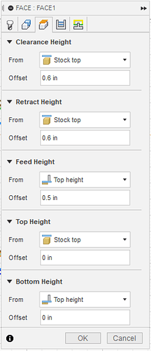

Thanks again Fablab. Been thru that one 3or4 times now and according to what I see I should be good to go. There is no reason I see in that set up that would cause my Z to retract as high as it can go. Again it is a positive 4.8" what it faults out so I am missing something simple. The code I copied here appears to be a G0 “rapid move to” Z1? Shouldn’t that be 1" above the work Z0??

Well you could definitely be right on that as I was struggling with the orientation options. The machine is doing the job just fine. It is milling the base great but the traverse from work zero to the start is what is bonkers. Trying to learn but gettin burnt out.

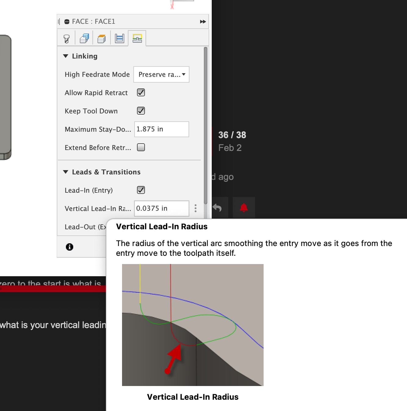

What is your vertical leading radius in the “linking” tab? I am new to Cam too so not sure if this is what you’re looking for.
Hi WorkNPlay, the toolpath I posted here has no Leadin or outs. Only thing I am looking for is an idea why my cutter travels all the way up to around MachineZero and not above the WorkZ. I have not cut anything other than my bed plate yet but if this head was travel to this height on every transition it would take forever to cut something. I also own a 4x8’ CNC router table and the safe Z is always set to around .400" and I really thought this was set .600" on my retract height but it doesn’t do that. When I hit the start button the head travels as high as it can go and transverses to the start of the machining and it cuts everything like it should but I cannot figure out why it starts out that way
