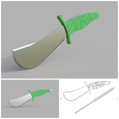

Here is what I came up with yesterday starting my way down the knife rabbit hole.
First off I created a slightly broken parametric model in Autodesk Fusion on a knife blank with scales to sandbox a number of designs.
Here is the first batch of designs.
3d printed one design to test fit.
Still needs a lot of work but I like being able to feel it in my hand.
Back to the drawing board.

I really like this design. You get the good puncture/plunge capability but can still put pressure on the back of the blade to steady the blade and for a longer cut.
This design would not allow any touch on the back of the blade:
I guess it is all decided on your primary, intended use.
Castrating posters who don’t provide feedback on the help they’ve received? :thinking:
I ll print one out and see how it feels
Just curious how you will print it: vertically (balancing on the back end of the handle) or horizontal (on a raft of support material)?

Decided to CAD this knife up too.
I notice there are all sorts of names used for parts of the knife so I was going to circle the part that I really like on this illustration, but I thought it would be better to use the name.
Then I encountered this:
I would say I really like the Bolster/Guard and Front Quillon on this knife:
It gives outstanding protection for your hand and allows you to apply lots of pressure with one hand. Not as versatile for approaching a patient, poster, volunteer that is to be circumcised or relieved of ones testicles. :rofl:

What’s your goal for how you’ll use your custom knife? Those design are all over the place in terms of practicality for various tasks. You should think about what it will be for you, and be honest. If it’s going to be a display piece, go wild, but if it is going to serve some specific purposes, look to design in a way to maximize the utility when possible. You’ve got good starting points for a variety of styles.
The design and function will inform the decision for what material to have the blade made from. A fat bruiser made to split coconuts and whittle trees into toothpicks will have very different needs than one for cutting cardboard or actual whittling.
Handle shape should be something that feels good and serves the purpose. If you’re going to skin deer with it, you’ll need a lot more texture/grip than if it’s for opening cardboard boxes and daily chores, where an aggressive texture may be a nuisance in the way it can grab at clothes and abrade skin and fabric. If the knife is made for handling in multiple grips, it’ll need to have a more rounded shape, versus something you’ll use with gloves or that have a heavy duty use that may need a shape that helps it stay locked in one position to keep the blade pointed the right way.
Just some food for thought as you design and make a plan.
