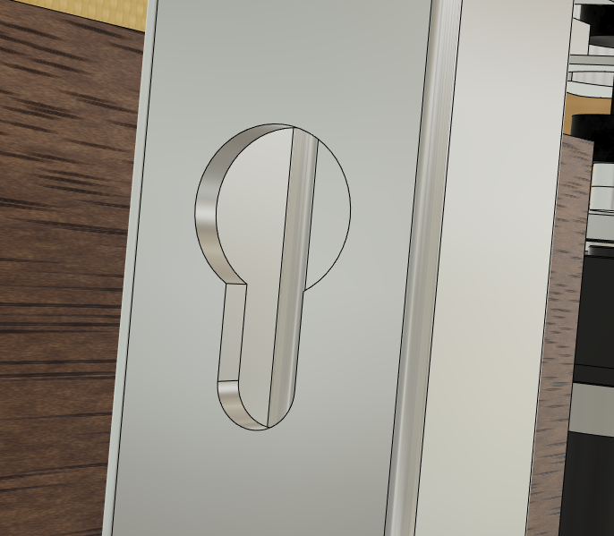

Hello All. Question for you. 2x2 Steel tube .25" wall, plain carbon steel. I want to cut this keyhole on one side only. Razorweld45. Crossfire pro. I will make a jig to place the 8’ pieces and line the nozzle with a marked spot for the larger diameter section.
Will this blow out the back side? There are cases where I may need to have a hole on one side and go straight out the back. Is this going to require flipping and cutting again for best result? I assume it will require flipping but wanted to see what you guys already learned on doing this.

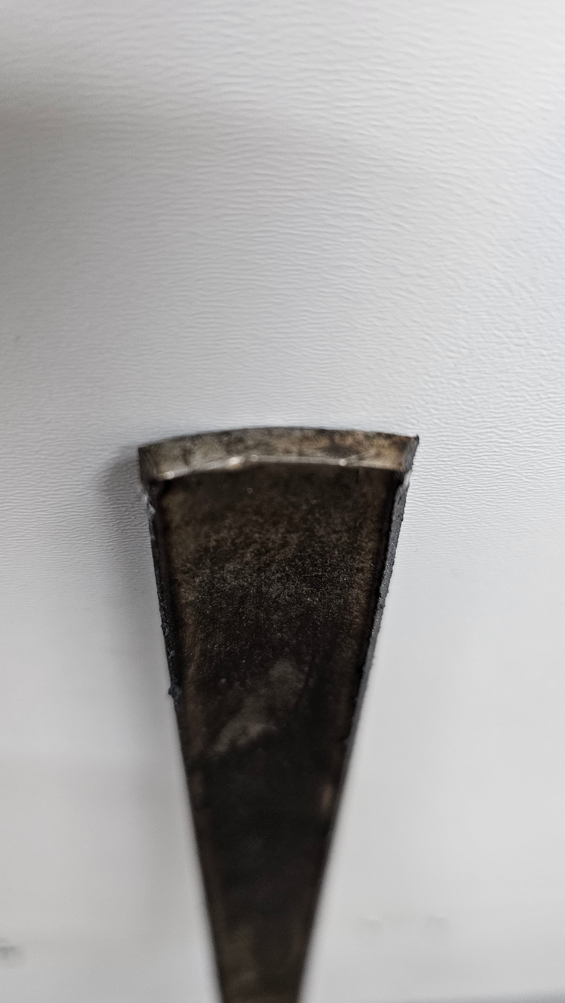

I cut a 1/2" wide x 56" long slit in stainless 2" round tube for a guy last week,slag slid right out of tube when I took off table. No need to put anything inside,dont overthink.

You could go wider if you did single line cut, rotate tube and do another single line cut and use cutting torch to snip ends. I drew up the slot run it through sheetcam and cut. Never had problem with slag on inside of other steel.
no warpage, tube was .250 wall thickness

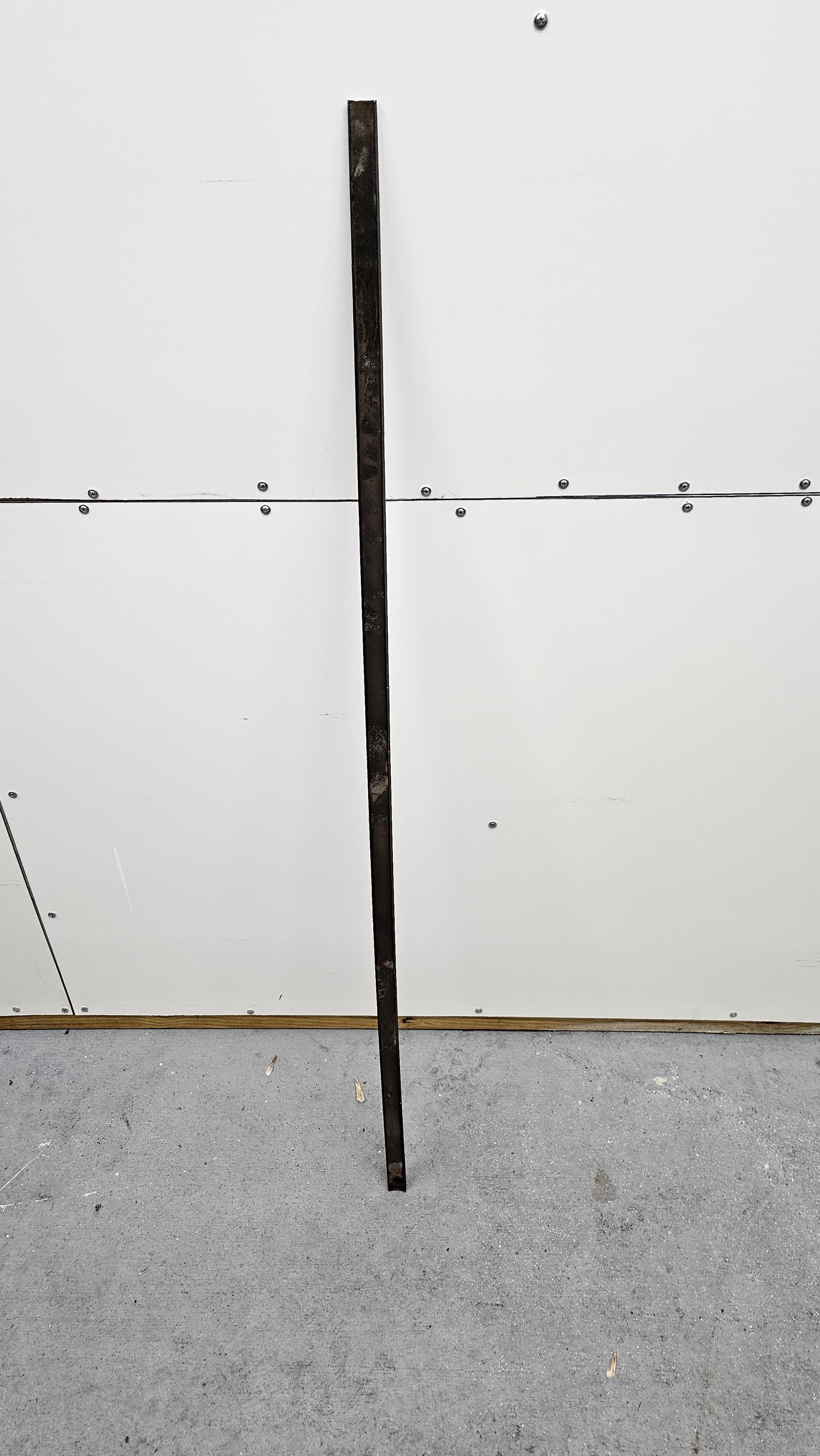

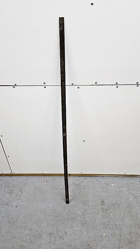

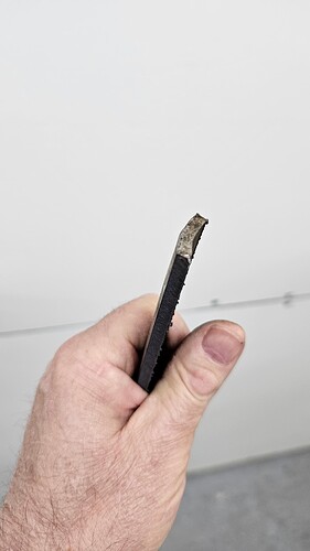

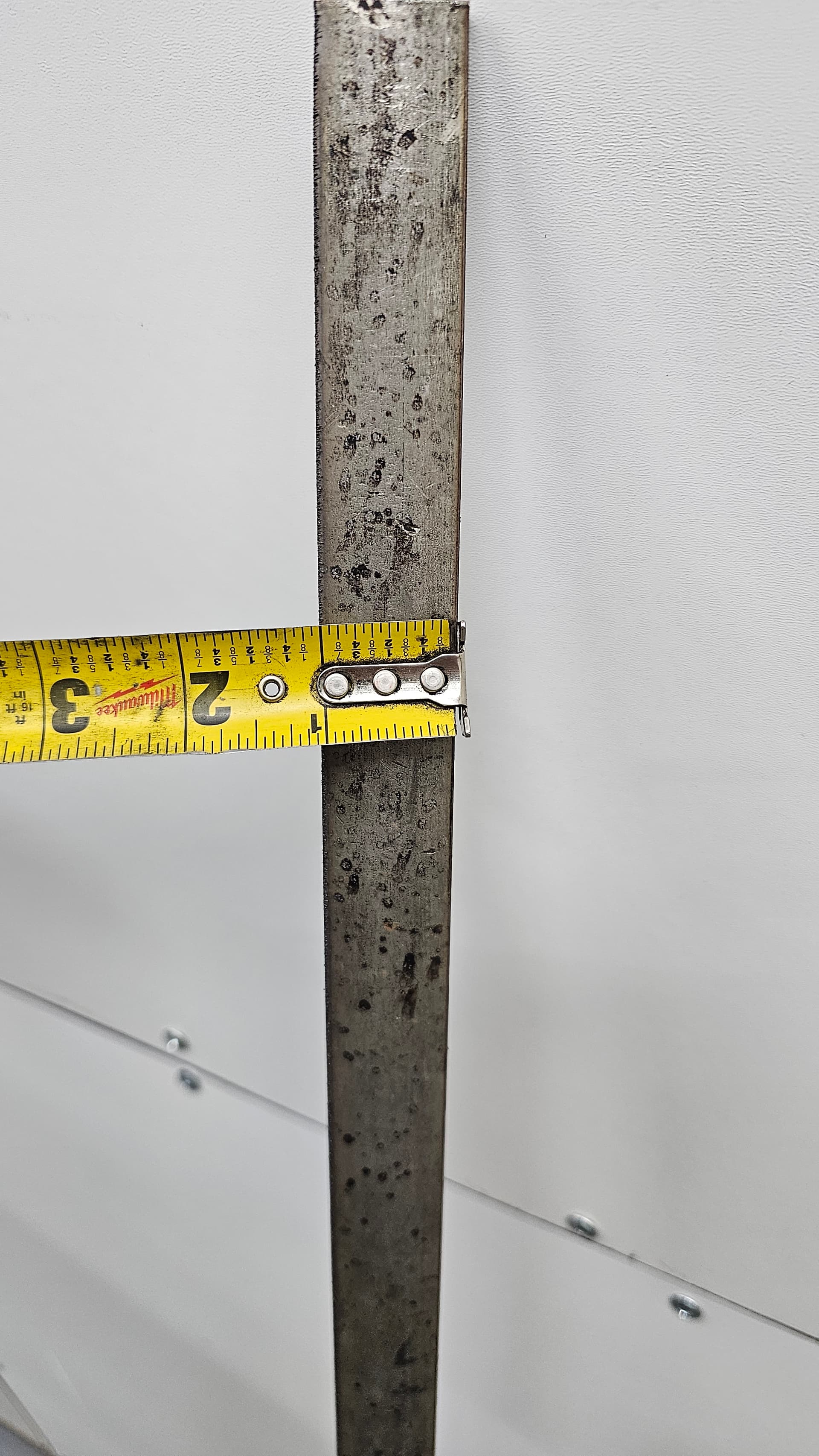

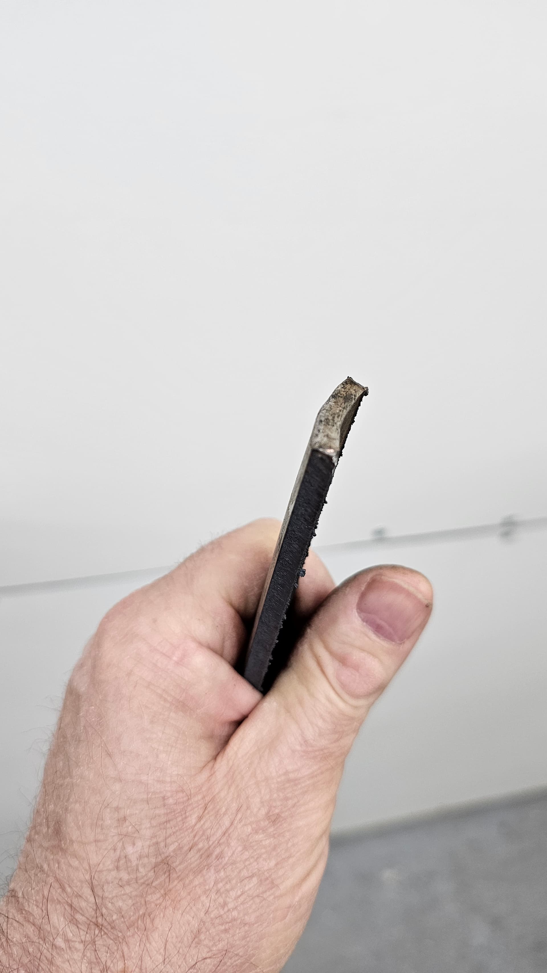

Here is pics of 1" wide slot out of 3" round tube 51.5" long cut. I will take pics of tube on table next time I do cuts on tube.
Ok I think I see how you do it now. I look forward to next time you cut one.
