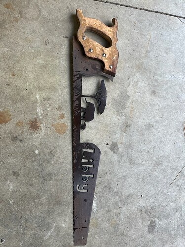

I am sure some of you will recognize these based on my never-ending questions on this forum. Thank you for your help. 16ga, Pro, Cut 60.
I had 2 different people ask me to cut their old saws. The 66” saw was my first long saw and cut it as 14ga because it’s thicker than handsaws. I cut hand saws as 16ga. I’m sure they’ll be happy.
