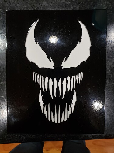

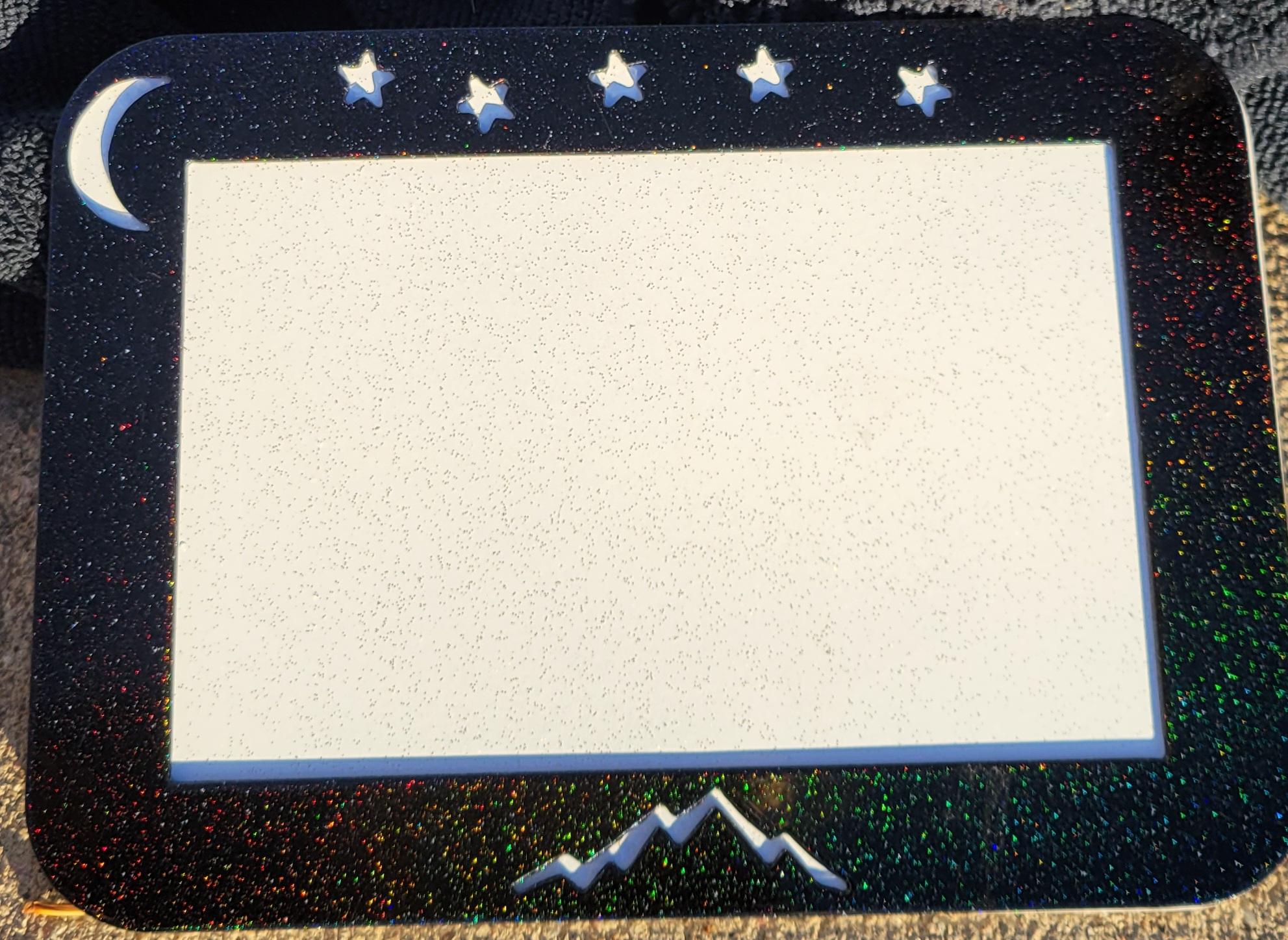

Some new projects, had an idea of making some picture frames out of metal

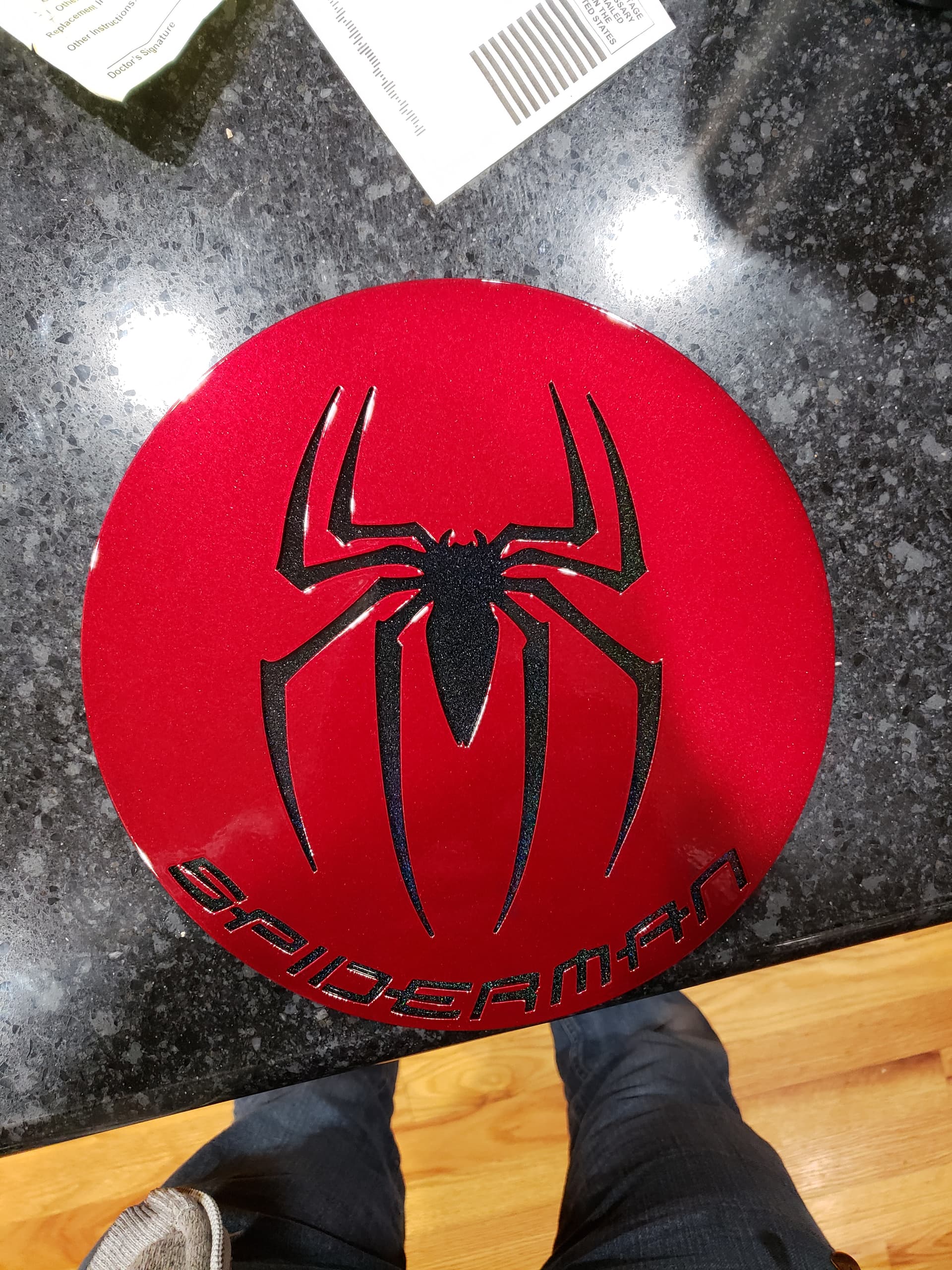

Also a spiderman sign for a buddy of mine and a Venom sign for my wife and I

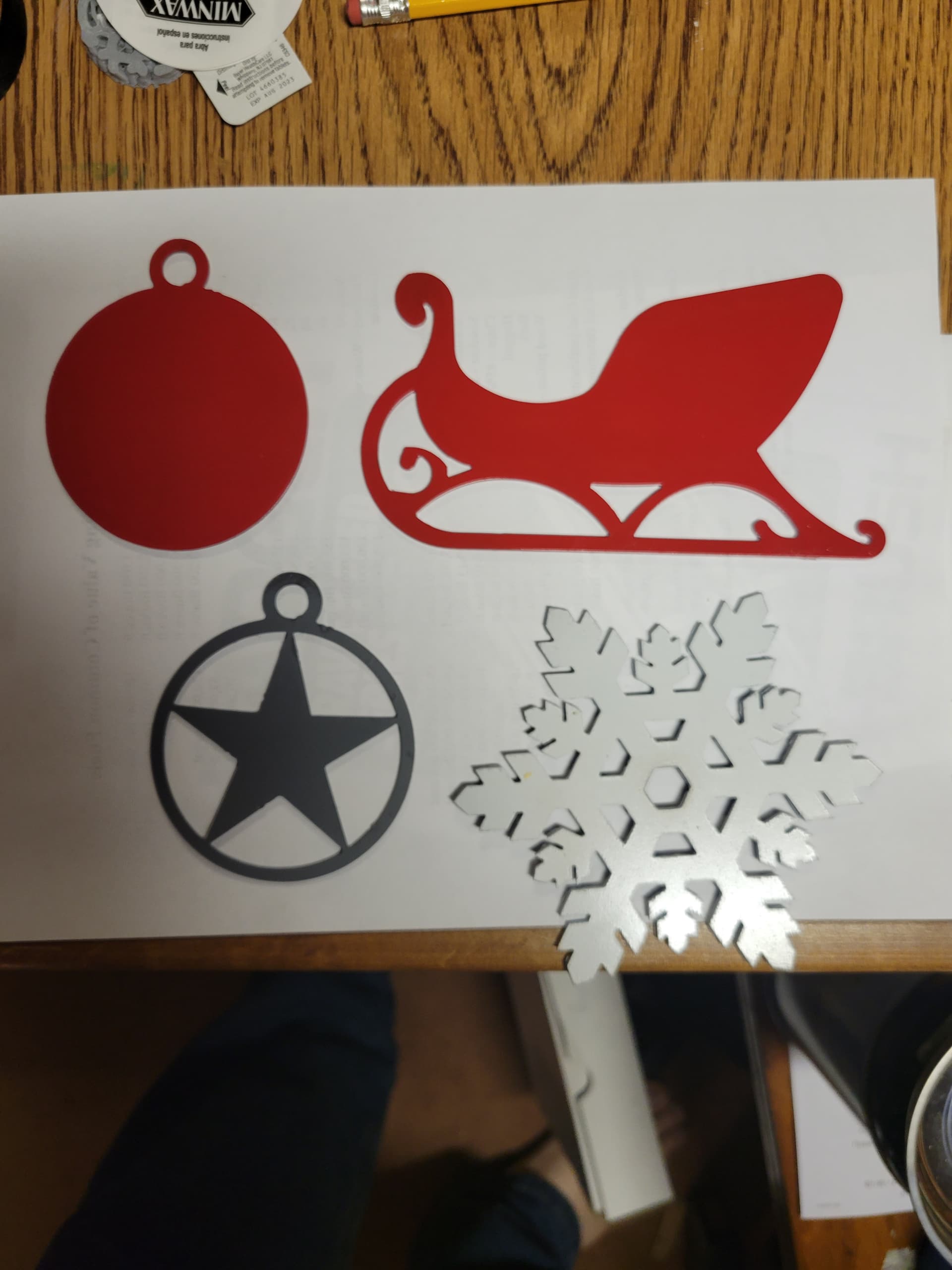

Getting a start on some Christmas gifts. Base coats are on but still need to get the metallic accent paint.
did you find that on fireshare?
I just searched for both venom and the spiderman one on Google. Venom was pretty easy but spiderman was the logo and the text separately. Had to import them to inkscape and use path effects to bend the text

What design are you thinking about?
Ok, looks cheezy but you get the point.
I’m at my dat job until 430 central…
Would you willing to share the DXF?
spiderman
venom
cut both out of 18 gauge
Not sure what that is?
@knick Click right and save as, they are the dxf files you requested. Spider-Man and venom. It’s hard to see when they’re black on black.
Shows up even worse on the mobile version of this app.
Thanks, never saw it done that way
Hopefully it comes through ok. I’ve never done it before
It did Thanks, now I just need to learn how to get it to cut inside the text :roll_eyes:
