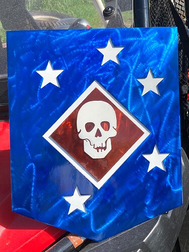

Any Raiders around? Did this for a buddy, 3 layers.

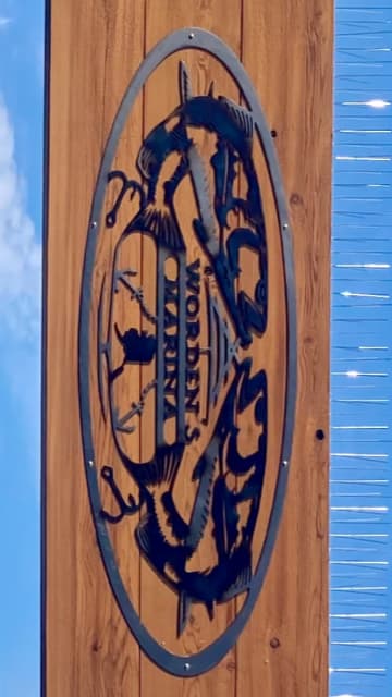

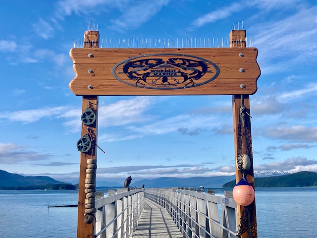

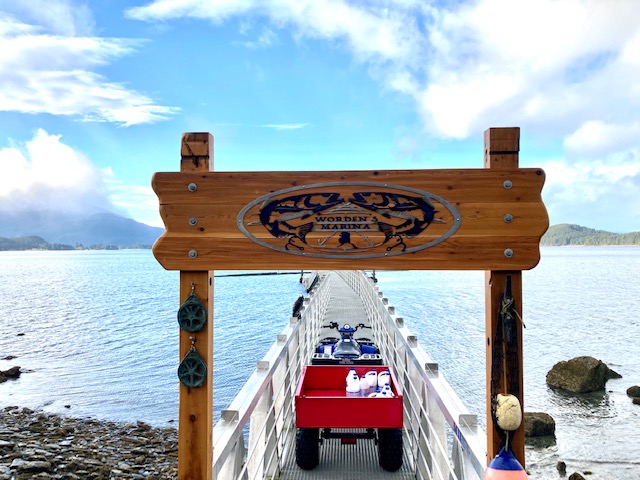

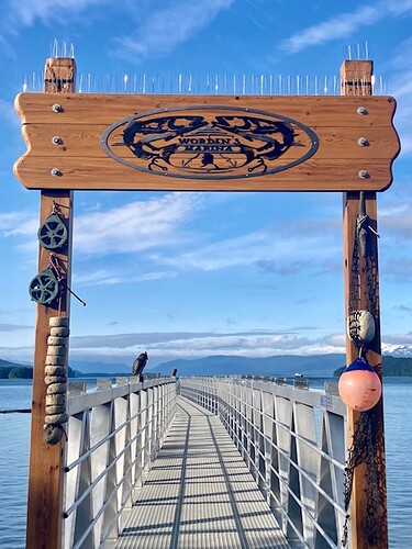

Did this for my good friend and business partner. Probably the most time Ive put into design etc on the metal portion. Colored with just a torch. I found using map gas gave me the best coloring after practicing on scrap. Wood was from a house I tore down that was originally milled from red cedar taken from Prince of Whales Island here in Alaska. Cool project and get to see it every time I go down to my boat that is moored on his dock!!
IMG_1908
IMG_2396
Nice sign and great view!
Tough to turn that cart around if it gets stuck though :grimacing:
It’s a one-way trip…

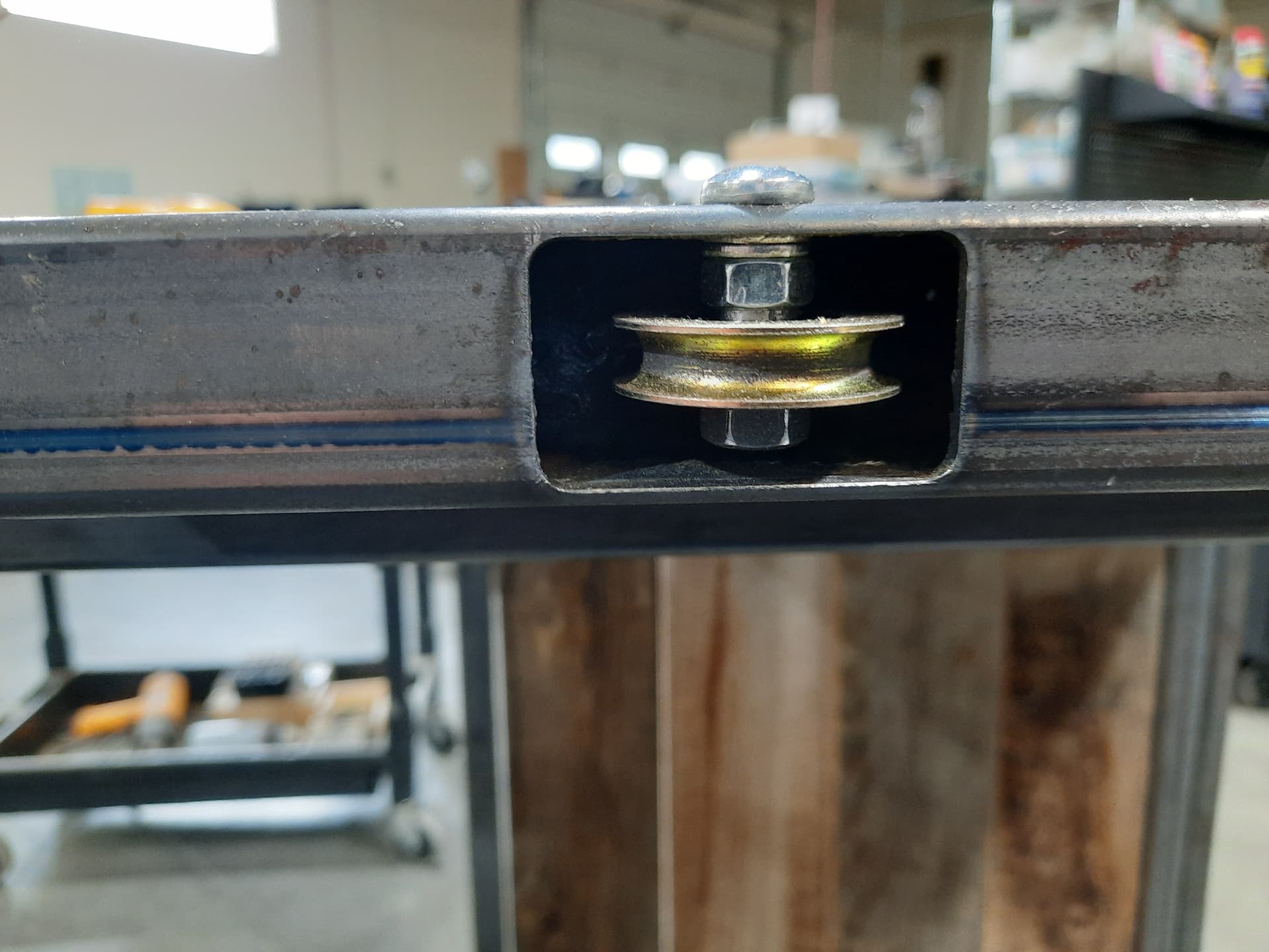

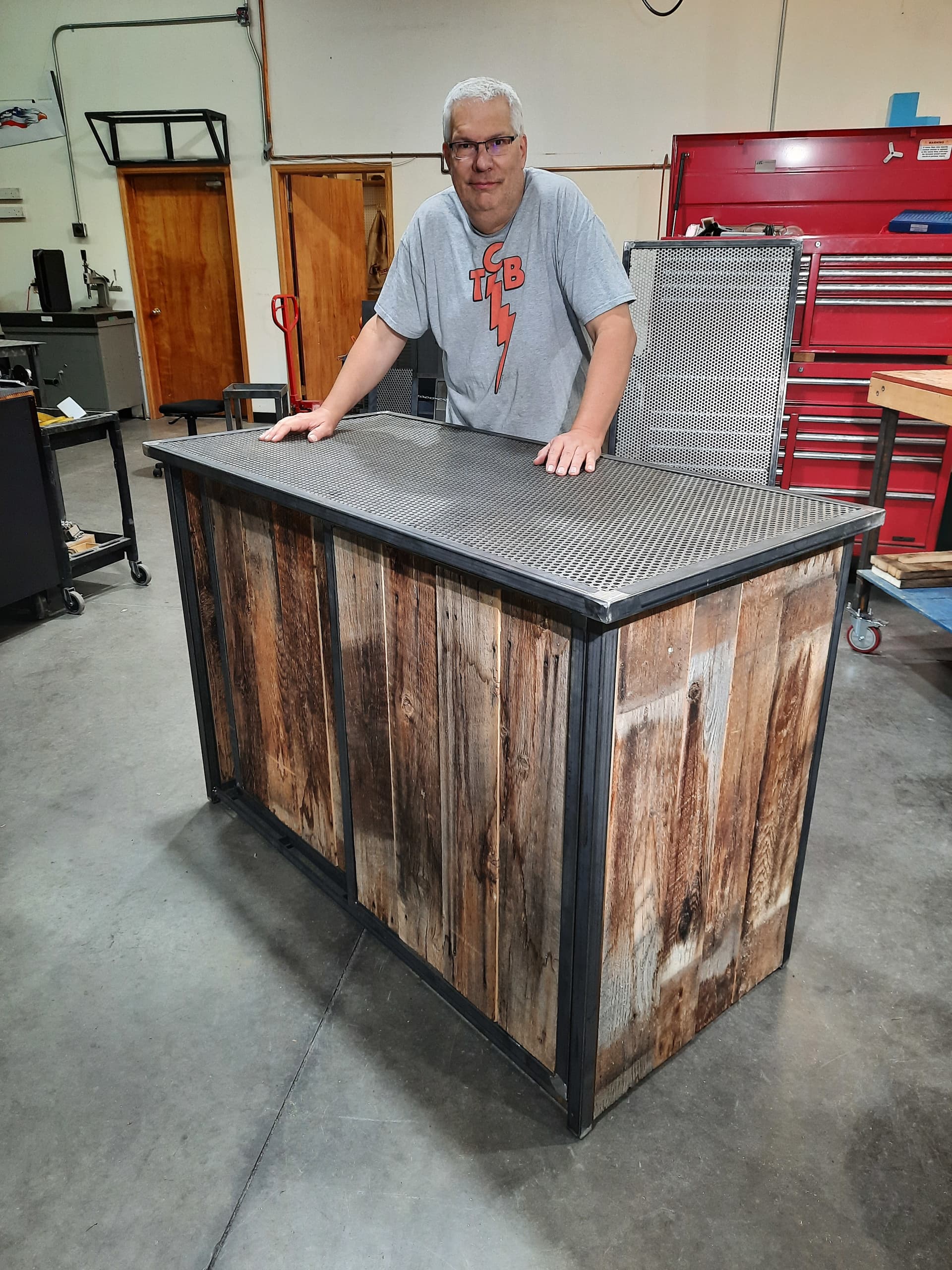

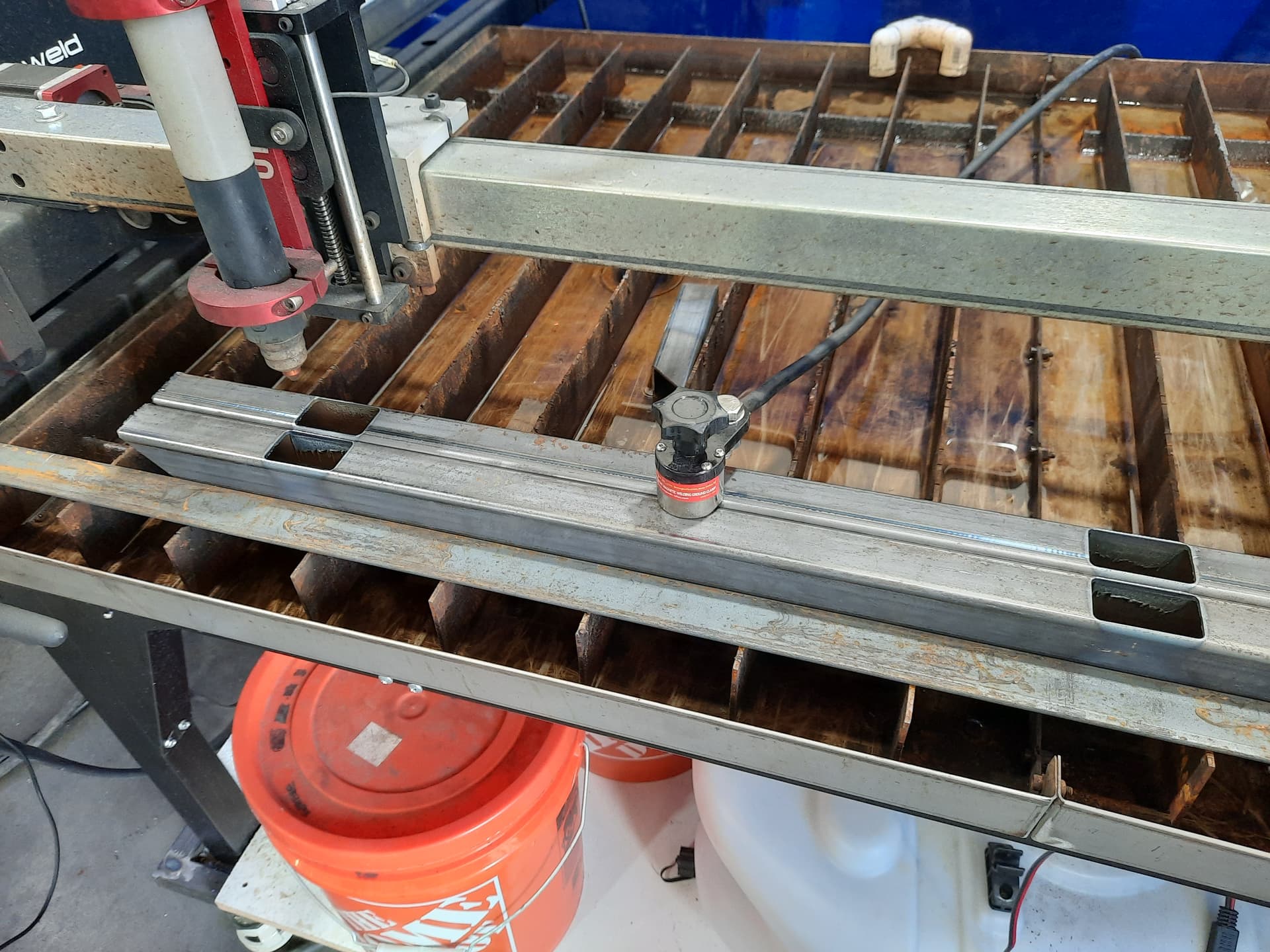

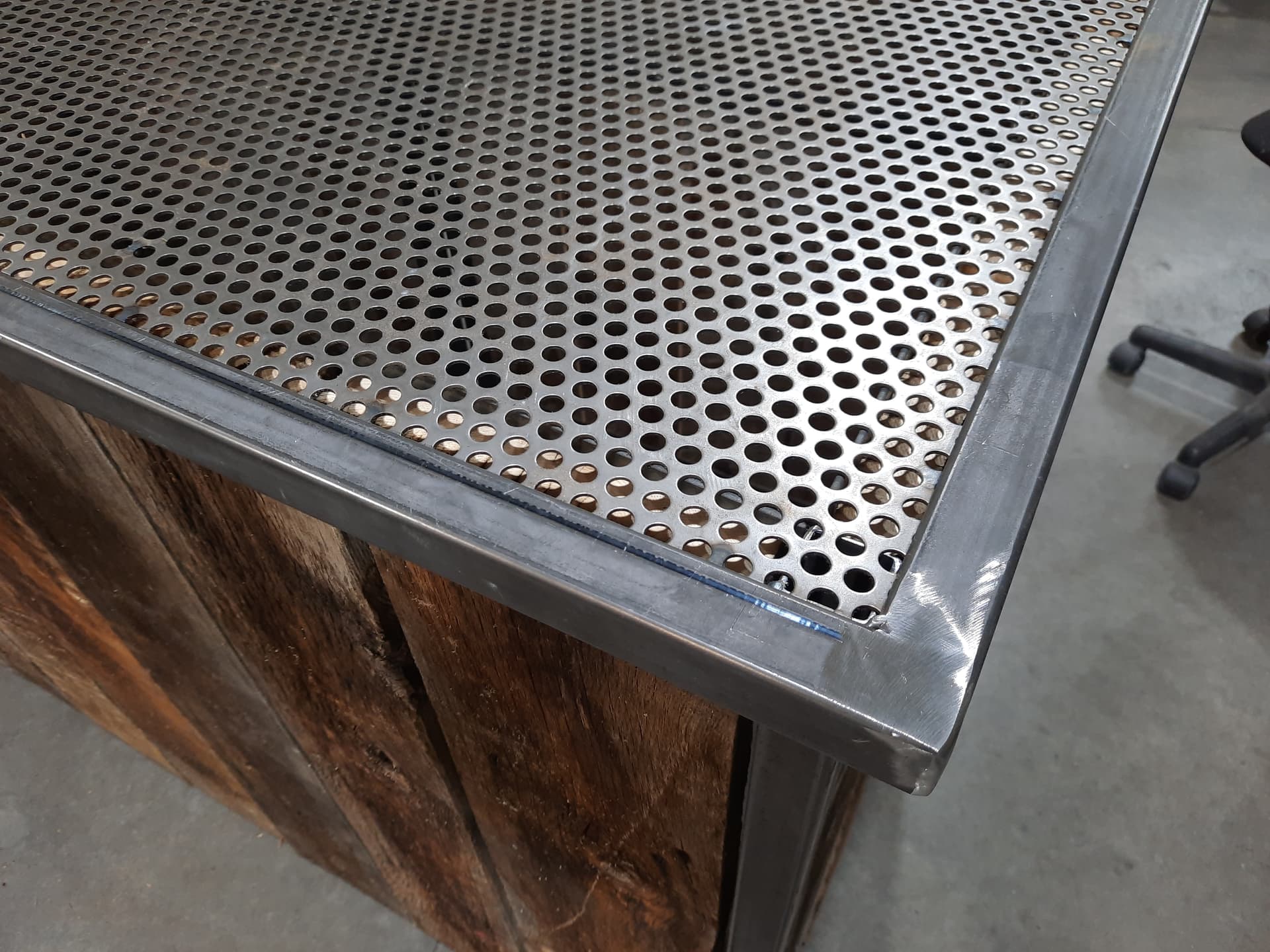

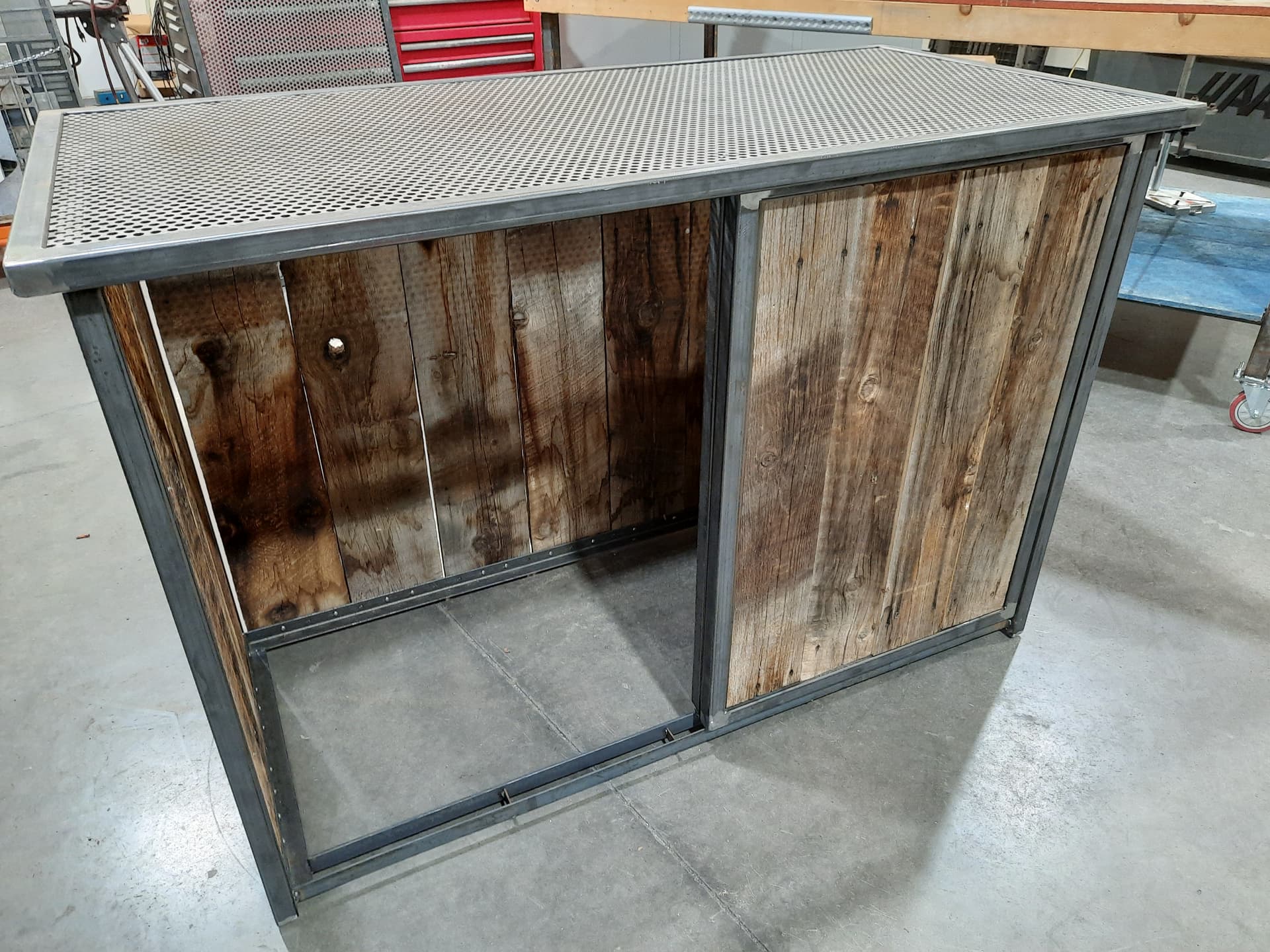

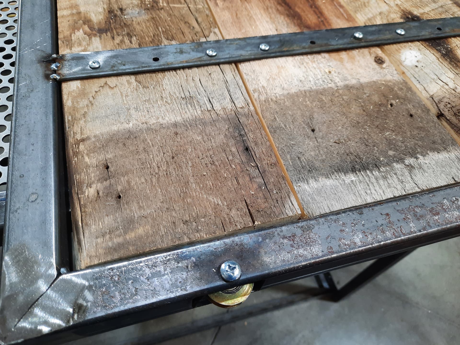

My wife wanted a serving counter for our outdoor dining area. I through together one in about 15 hours, complete with barn wood siding. 2 rolling doors, perf metal top. Used my XPro to cut roller wheel hole, ‘drill’ the flat bar for barn wood attachment and tubing threaded tube ends for leveling feet.
NIce build! Hoping to do something similar…
quick question witch im sure you have been asked 2 million times where did you get that ground magnet set up
Arc Zone I use a 300 amp version. They have smaller sizes. $83.00

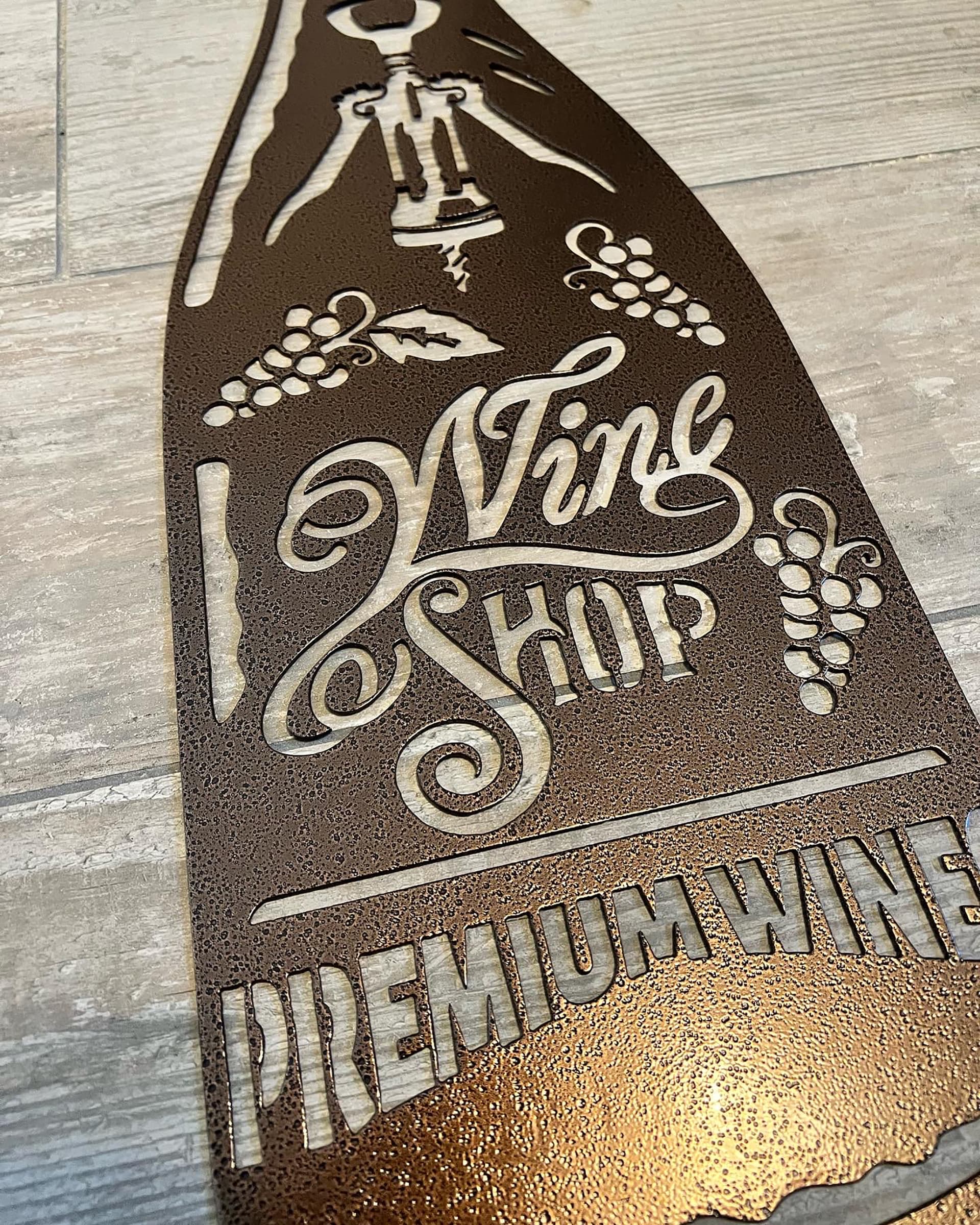

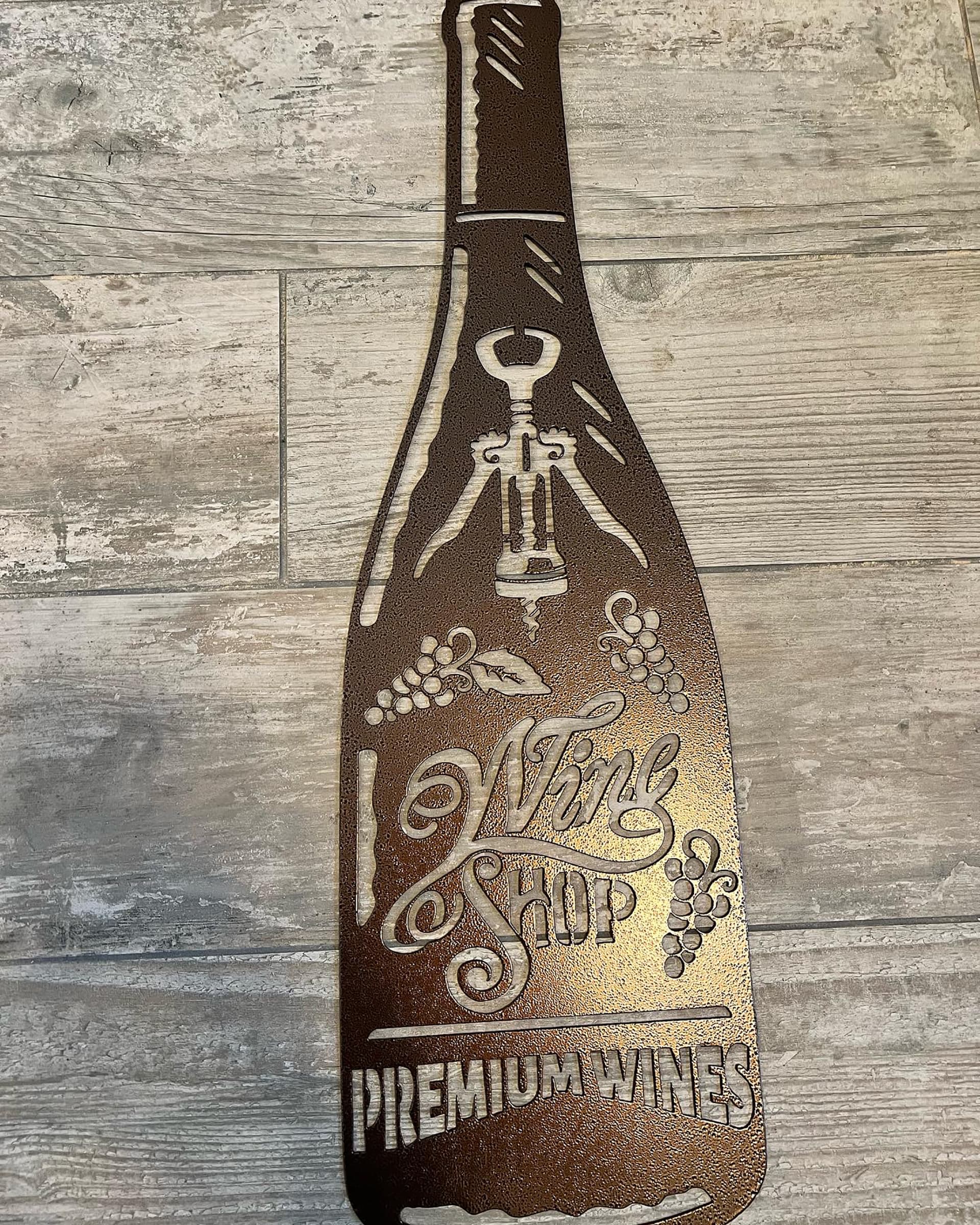

Here’s a sign i did recently, its powdercoated in Empire Copper Vein from Prismatic, overall size is 30" x 8.75"
I like that. Looks like some fine detail in the corkscrew (thin). What plasma equipment & tips did you use?
its a RW45 with a PTM60 machine torch with 40A shielded consumables, its definitely a delicate portion of the sign, nerve wracking part of the cut.
Very nice job on the sign, I like it.

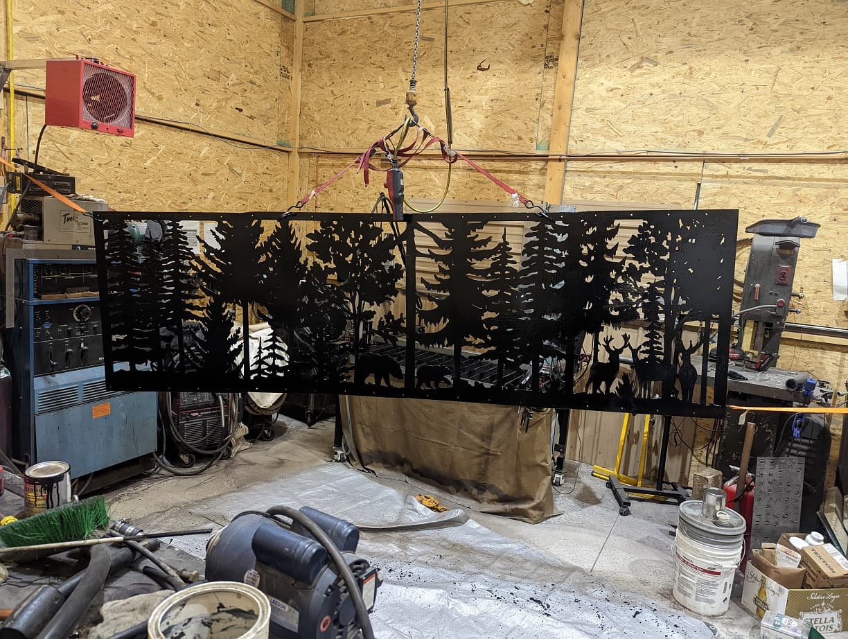

Biggest I’ve done so far, four sections for just shy of 10 feet wide and 3 foot tall.

LOVE LOVE LOVE it!!!
