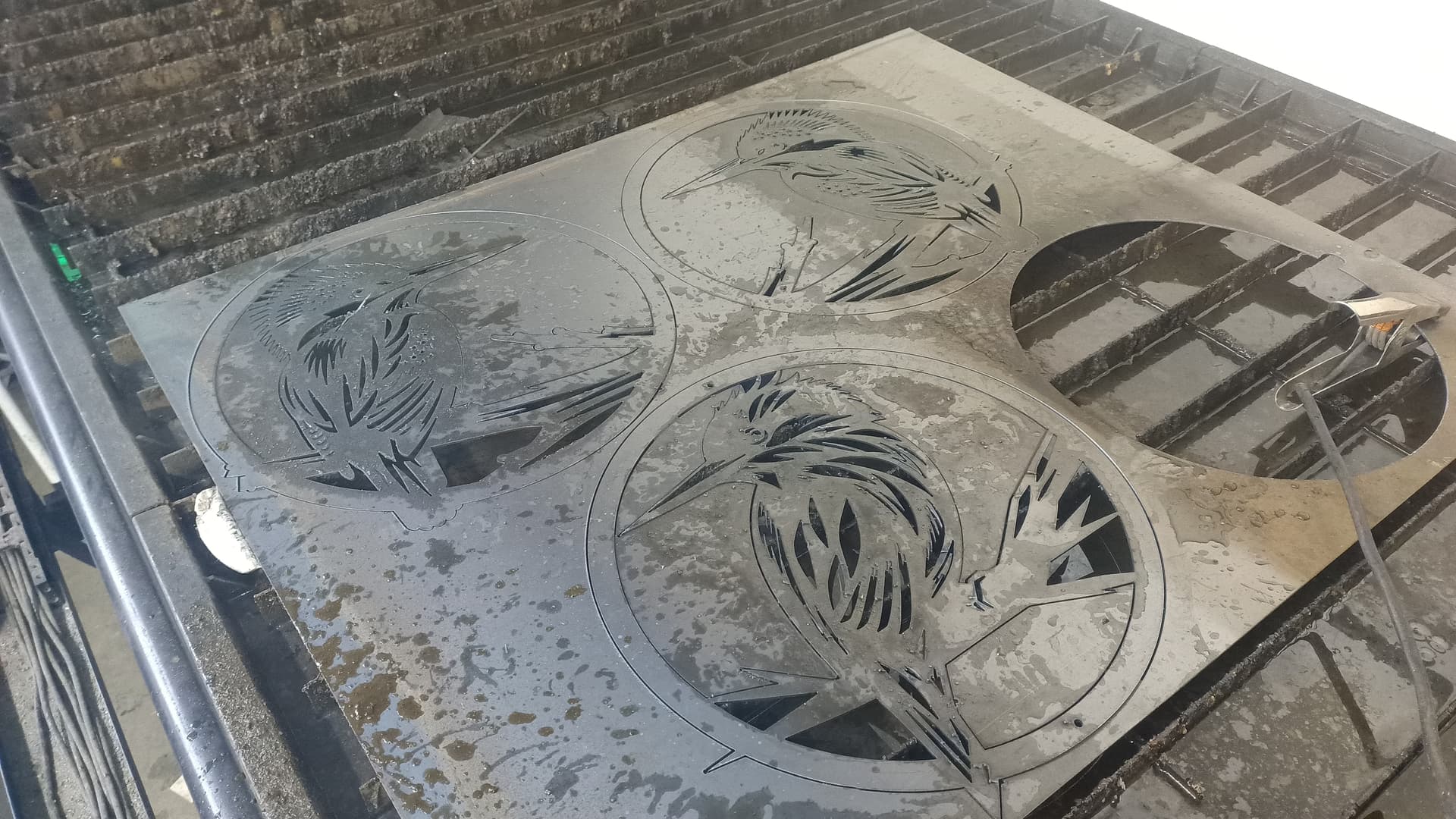

Sheetcam will automatically do dog bones on things like that. The feature is called “over cut internal corners”. You can adjust the settings and see the result in the tool path.
When you enable that feature, it will apply to all internal corners on your drawing, unless you set up a separate operation for just the parts where you want the over cut. It’s fairly simple to just move those cuts to another layer and create an operation with the dog bone cuts.

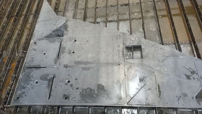

I have both sheetcam and fusion. I’ve seen people talking about the plug ins of add ons that help with the tab and slot and dogbone/ over cut features, i just wanted to read up on it some more. I have played with it a bit before, but usually end up doing some post cut file work because the kerf ends up making the slots too tight.
I did a little reading and found this post that allows Fusion to automatically add in an allowance with your cuts. I have not tried it.
Edit: The more I think about this, the more I can’t see how this would work since it would change the dimensions of your entire piece rendering the “creating allowances” moot. Perhaps I am looking at it wrong.

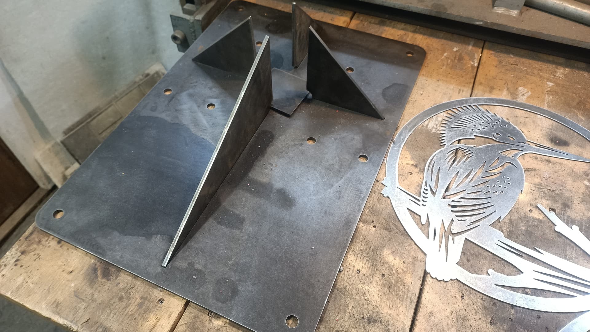

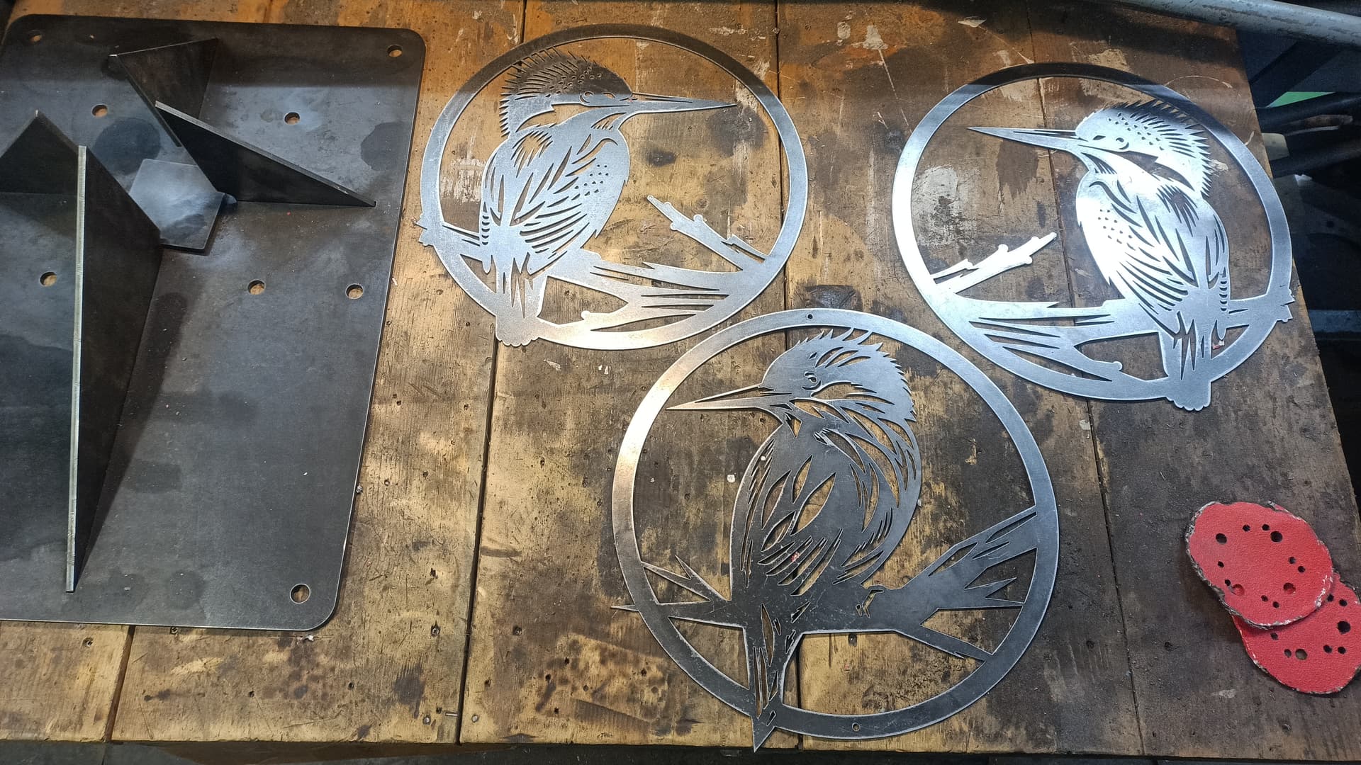

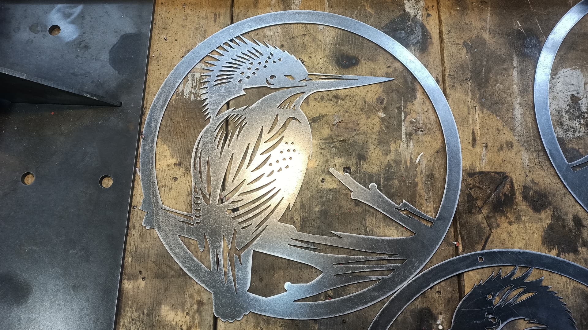

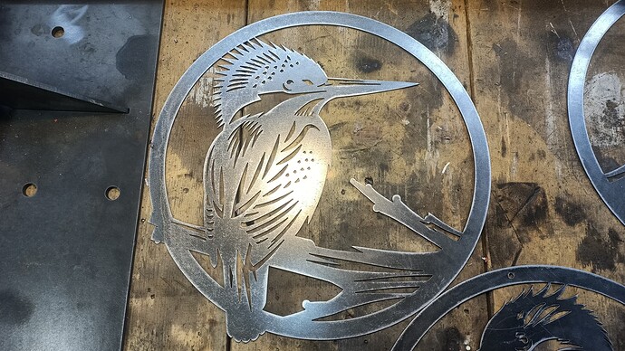

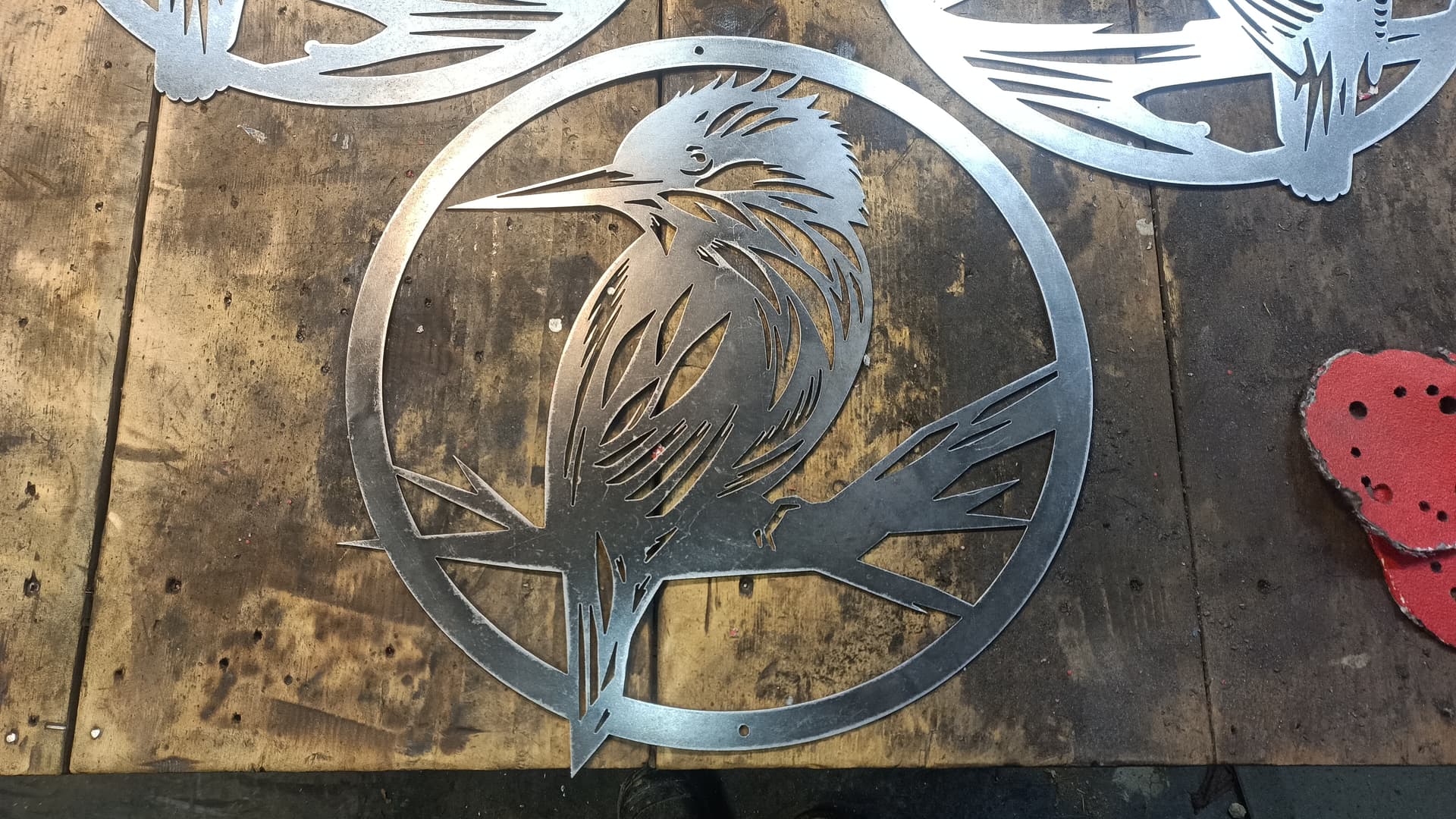

Few things that came off the table.

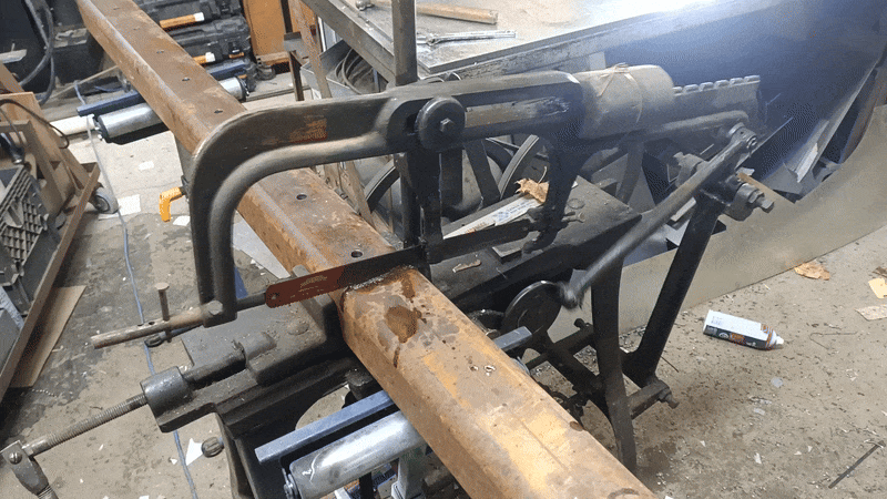

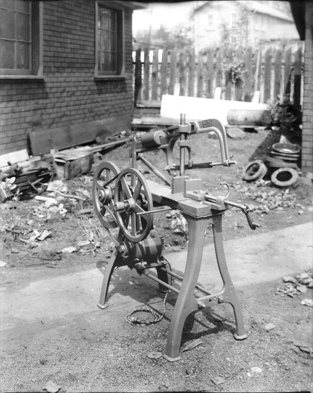

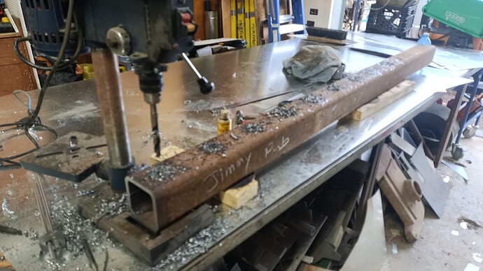

And I also had a cut down this 4x4x3/8 square tube. I don’t have a band saw at this shop so I pulled out the old power hacksaw. 70 revolutions a minute. I think this one was made in 1917.
ezgif-4609d470ebee28a5
I don’t see the leather belt running up to the ceiling drive shaft! How did you power it! :thinking:
Yeah my driveline is down so I’m running a power take off off the Ford.
Believe it or not, my grandfather had something similar to run a sawmill on his property. I was only 4 or 5, but I remember them telling me not to touch the leather belt. Boy, I’m an old fart TinMan.
