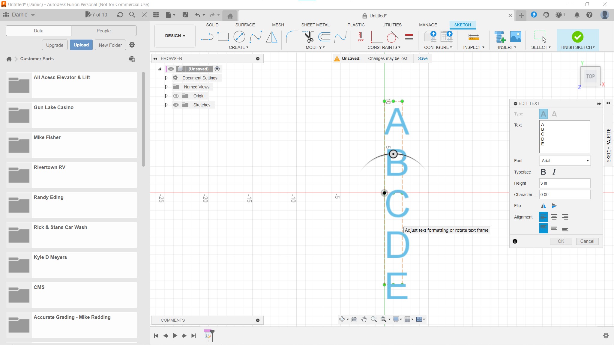

fusion is a little bit wanting in the font environment but if you are looking to do vertical fonts in fusion there is a way to go about it.
Using the text on a path function in conjunction with rotated or vertical style fonts works well.
I’ll include a zip file with a few vertical style fonts that you can try this out with.
rotated-vertical-fonts.zip (182.5 KB)
here in the screenshot I have an arrow pointing to the text along a path. I have a vertical construction line as my path and I’m using these rotated vertical texts on it.
character spacing also works to increase the gapping between letters in this position.
try it for yourselves it works OK.
These kinds of fonts are a little rare to come by so if you find more of these fonts in TTF format please post them for me, thanks.
Thanks Tin. I will be on the lookout for more fonts.
You can also use reg fonts just hit the return after every letter . Might not be any way to adjust spacing
Does anybody do this? Or does this not work well?
Definitely a good method if you have a very certain font you want. The only issue is that the letters end up justified to one side with most fonts so there’s a slight odd appearance. You also have no ability to change the spacing between the lettering.
But a very usable method that I have made signs with in the past.
And the other method would be to explode the text, unlock those closed chains and manually move them into position. This method can work also but it’s not easy or quick.

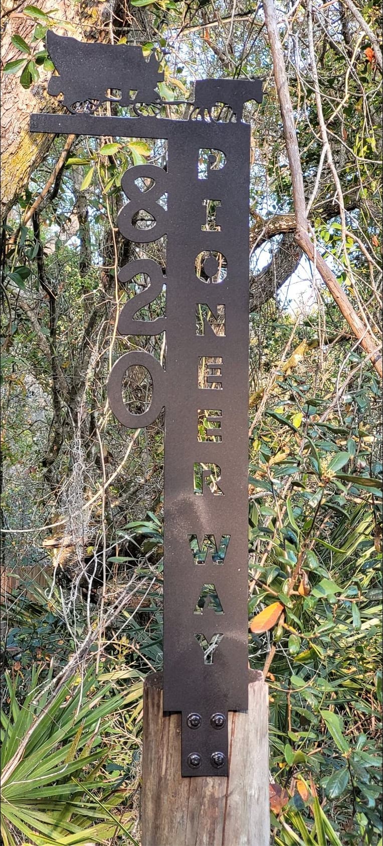

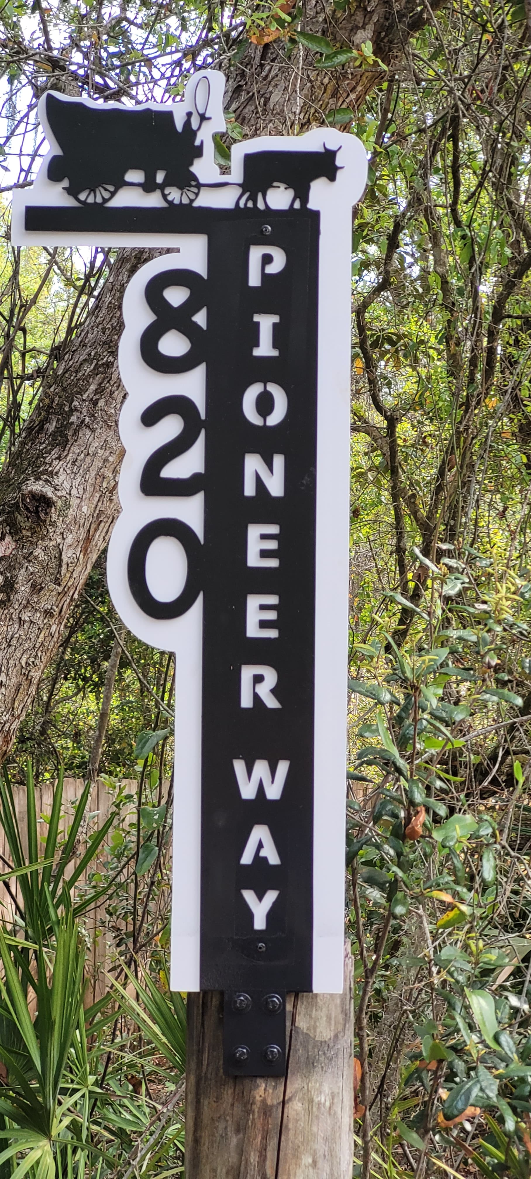

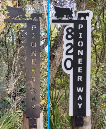

I added a second layer so it would stand out.
Jim, thanks again for all of the help.
Makes all the difference!!! I know it uses more than twice the metal but so much more readable.
That now stands out day or night!
