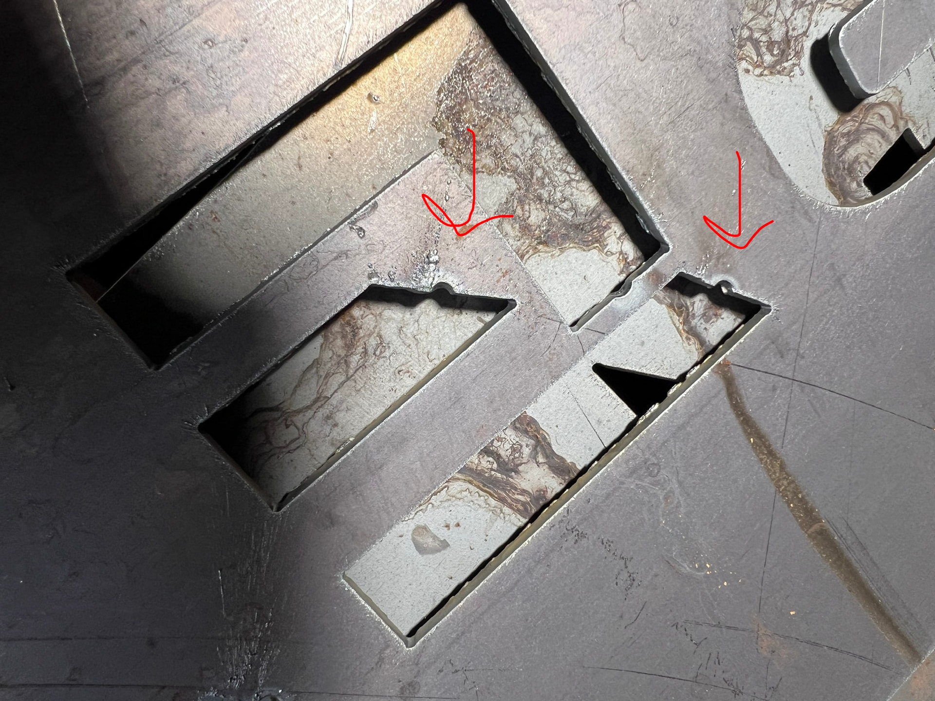

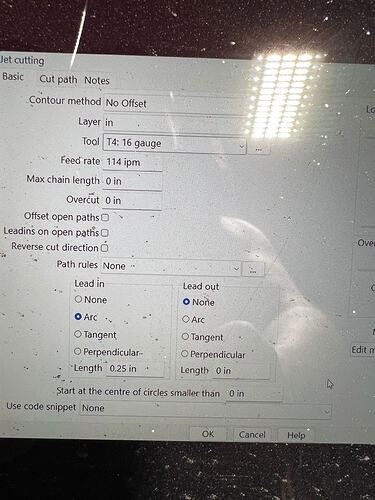

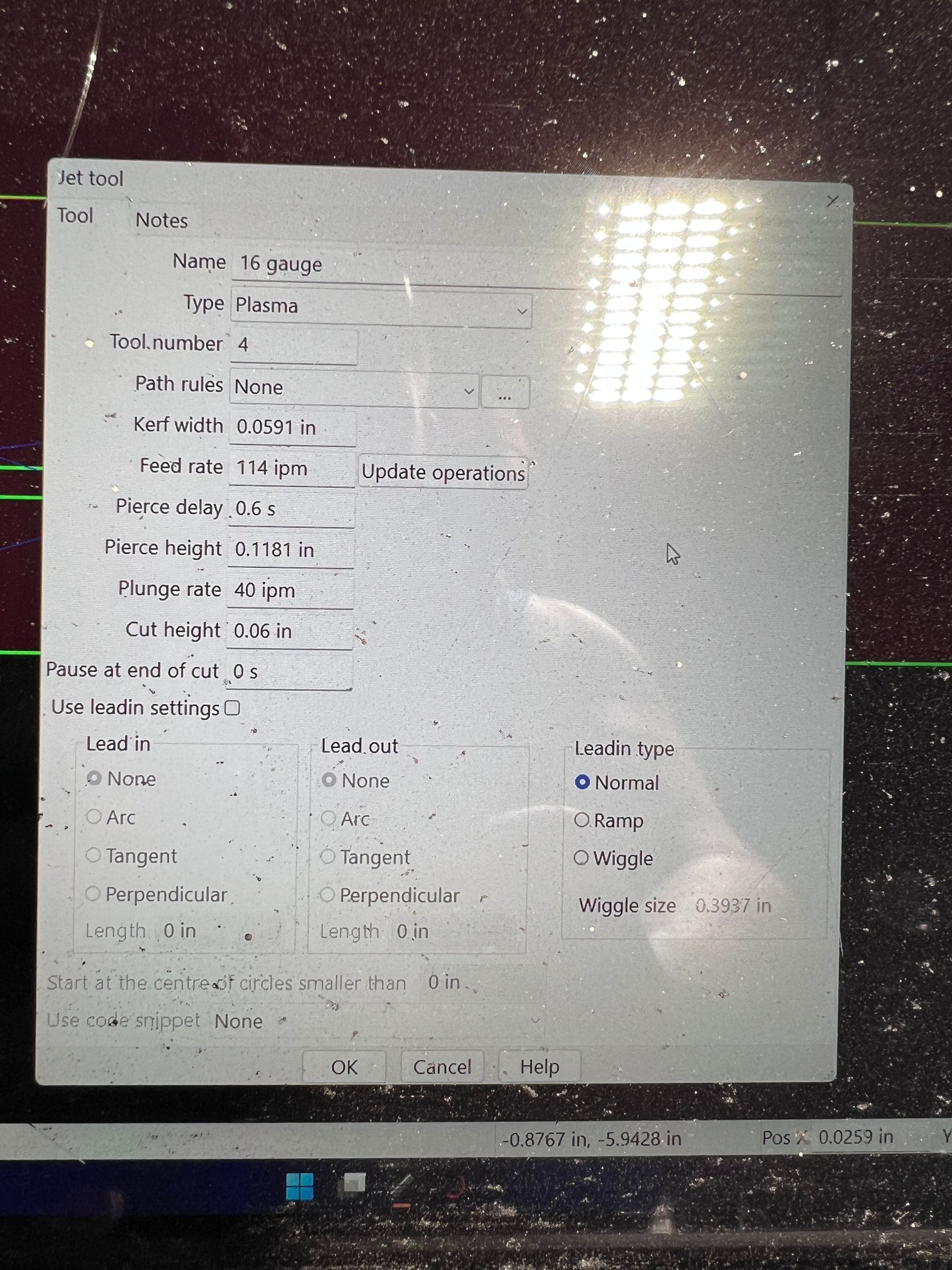

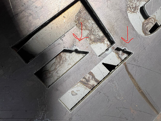

I just swapped my messed up plasma cutter razorweld cut45 with the exact same one. Im getting some weird cuts. I have attached pictures of what its doing and my settings. Cutting 14 guage. I feel like the torch stylays on longer than normal. Any help would be appreciated. Thank you
Try to increase your plunge rate. Fusion uses 100 inches per minute
Is there a reason you are using “no offset”? Using “no offset” with a lead-in can cause the lead in to be visible in your finished part.

You need to click the box to reverse cut direction, and you also need to use an offset or your parts will not be sized correctly. Unless accuracy is not important for your application
the enlarged start point is 100 percent the result of the plunge rate being incorrect. It would behoove you to add a lead in as well.

Its not the start point its actually the end point. The torch stays on longer instead of cutting out when its done. What setting can change that? @TinWhisperer @brownfox @ds690
@brownfox i do have a lead in and with arc
Are you saying that the torch doesn’t shut off between cuts?
It stays on longer creating that groove
Is the machine a Razorweld? The next question is, is there a 4T/2T setting on the front? If so, it needs to be on 2T.

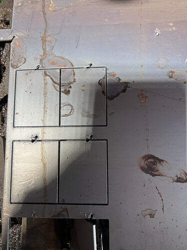

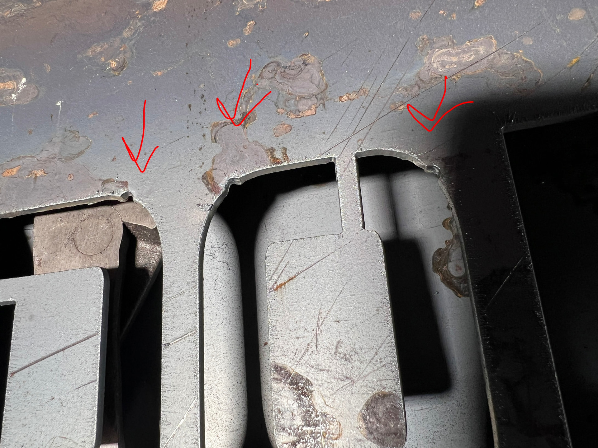

I think thats what it was i changed it to 2t. Adding picture. Before is on bottom @Bigdaddy2166
Happy cutting, my friend. Go wreck some steel.:grin:

Nice. I wasn’t sure on the lead in based on the two pictures you posted, one showed it on, the other didn’t. Definitely reverse the cut direction though, and try to start using the offset. If you design correctly, you never need to designate inside or outside offset in sheetcam. It all gets detected. I can post process a file in seconds.
What does the reverse cut direction do? @brownfox
It reverses the direction of the generated path.
