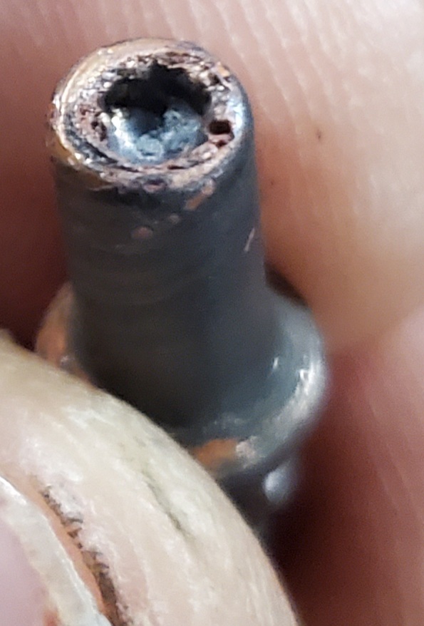

Is this normal for consumable wear?
Everlast 82i with a ptm60 60.amp Consumables at 55 amps.
No. Not normal.
Looks like wet air issues.

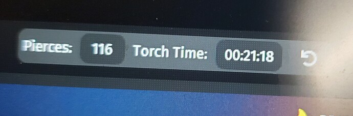

How long were those used? With what’s setting?
I see the 21minutes at 116 Pierces ( just one program?) 55amps and 0.06 cut height.

As TinWisperer has said that is definitely not normal.
You need to get your air cleaned and dried up.
Yes that is one program… ive ran that sdame program probably 15 times already. and im changing the consumables basically once per run. i run them untill the arc drops out (which i dont want to do but im blowing through the consumables so)

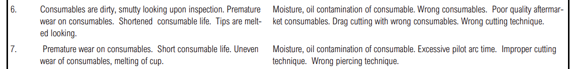

You got an air issue. Wet and maybe dirty to.

Yeah George knows the specs for what he sells for sure. I’m curious to hear what the OPs air setup is. For how bad it looks it’s like he’s running the plasma off diesel exhaust with mud injection.
No offense OP, just being funny. We’ve all had air issues.
im actually laughing right now… i honestly havent put much into air quality and i know its pretty big.
i have the separator/regulator that came with the machine and a separator /regulator on the compressor. doesnt have any oiling or anything like that. i also have an ingersol rand dryer that is currently not functioning (freebie) plumbed in but again not functioning.
im looking to get the motorguard filter some desiccant and a copper cooler setup but i dont have any wall space to mount it which sucks because i already have all the material to make it from jobsites
Have you ever drained your air compressor tank? Should crack drain valve for a few seconds at least once a day ,see how much water is in tank.
yes i drain the tank manually most days… i also have a popoff type drain that cycle each time the compressor cycles.

I definetly will… im in the process of ordering parts for an aftetcooler and building a copper line cooler as well from spare parts I have laying around
If you don’t have wall space you can’t mount it around or directly to the compressor itself if you have a standing tank to save room
I Built it in the staggered layout I talked about in another post. So I’ve added IR moisture seperator the copper line cooler an IR filter, a motor guard filter and I just got the aftercooler but haven’t plumbed it yet nor have I gotten the fittings I will need.
So the setup goes IR water trap>copper line cooler>IR filter>line set across the shop>harbor freight regulator and water trap. Then the motor guard filter and another water seperator that is attached the plasma table only
