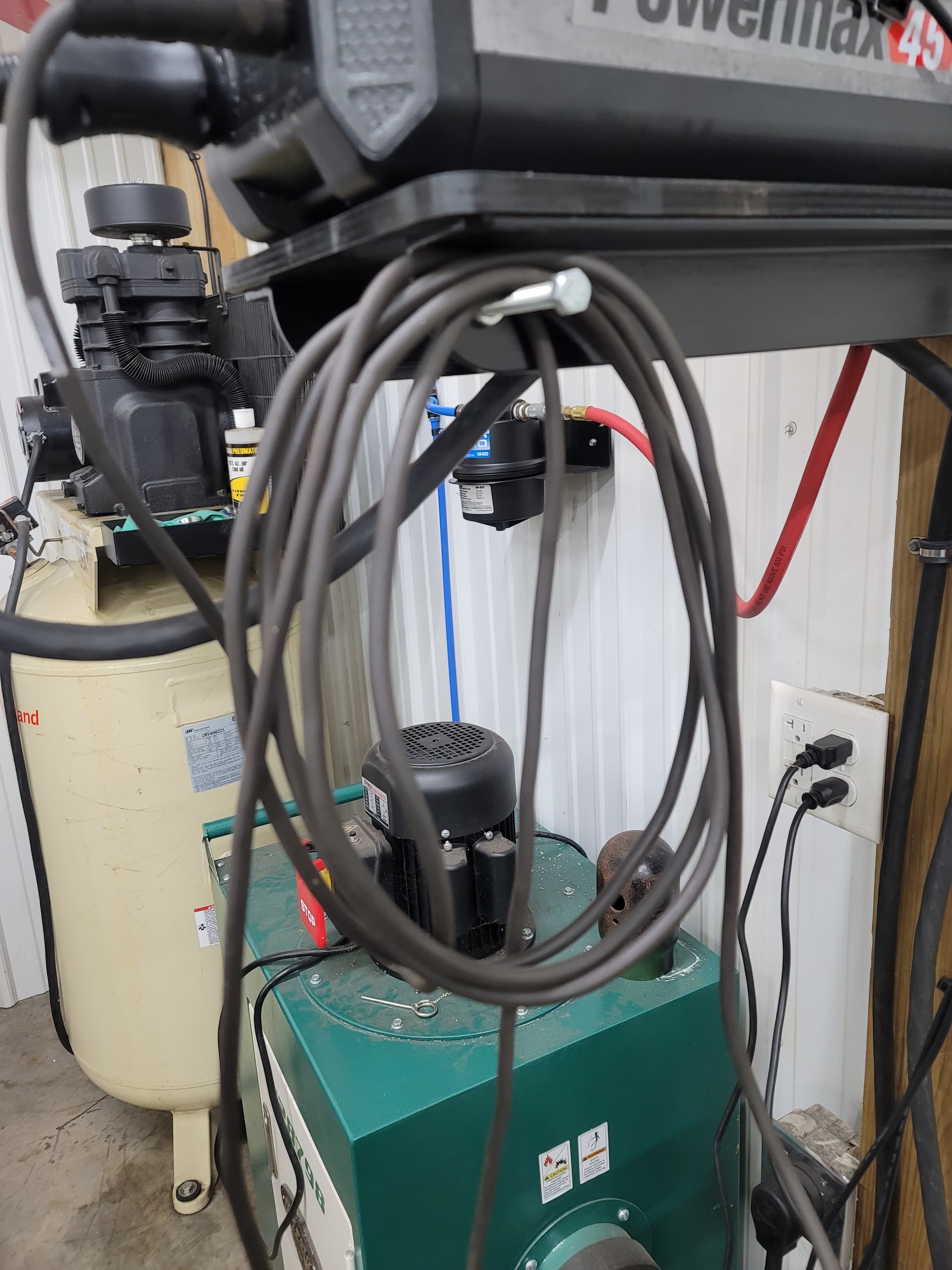

I had no issues cutting then out of the blue it’s started locking up firecontrol in the middle of a cut with the torch staying on.Ive only ran the latest version on my machine.I did the board mod and still had the issue.It seemed to stop when moving my pc a few feet from my plasma.I didn’t have this issue before and my pc had been in the same spot so I got to looking at my setup and noticed my ground was rolled up hanging over my control box and not far from my pc.I had installed this bolt to hang it after I done my initial set up and cutting of several things.I have a batch one machine that I just recently put together.Im going to reroute my ground and test for awhile.Ill update if it completely goes alway.
If nothing else you crated a good magnetic field there.
I think that was the point I was trying to convey in my post.
