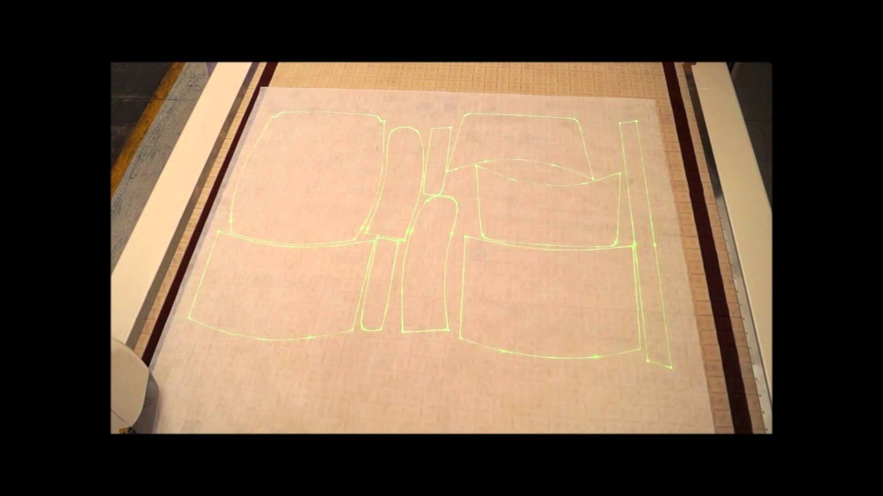

So when using Firecontrol it shows you your cut path and you can travel the torch around the area to see if you will run off the edge of the metal you have on the table. This is all fine and good but what if we were to develop a projector or laser scanner that is mounted above the table and can literally project the cut line onto the steel so you can line your steel up just right before starting the cut. I’m trying to think of how this would be achieved. It would be so easy to use up all the scraps laying around if you could just move the steel around until the image projected was in the right spot.
Notice the red projected box in this video. It would be cooler to project the actual cut path.

A crosshair is nice but I want to do more. I want to draw the actual DXF on the metal to be cut with a laser line or a projector.
You could take a photo of a scrap sheet and place it into fusion using canvas function scaled correctly and then place new parts in the openings left on the sheet.
That’s not what I’m looking for. I want to create something that helps speed up production. It would be very slow to go back to Fusion. Once you import the file into Firecontrol there should be a way to create something that will 2D scan a laser line along the cut lines. I’m not talking about using the gantry or torch to project the lines onto the steel, an overhead 2 axis laser scanner or projector would be used. This would greatly speed up production and streamline the process.
This site shows some laser scanning equipment someone made.
http://elm-chan.org/works/vlp/report_e.html
Imagine you have a swiss cheese piece of metal and a bunch of small identical parts to cut. You set Firecontrol to cut one part and upon importing the DXF, the image is drawn onto the table with a laser. You move the steel to where the part will cut out good and hit start. It cuts, then projects on the steel again. You move your torch and Zero all axis, the projection moves. It is off the edge a bit so you nudge the steel over a bit to fit the projected image and hit start. This seems like a fast workflow.

so kinda like what they use in the textile industry?
there is these production layout machines?
I see them advertised on Instagram a lot lately.
are you talking about having a interface between a piece of equipment like this and firecontrol?
Yeah, exactly like that. But it would have to have buy-in from Langmuir to integrate with Firecontrol. I’m good with the mechanical and electrical aspects but this would need coding in Firecontrol to support the hardware. It would be cool to develop a similar addon integration.
Yes, just like that but the catch is to keep it affordable. If laser costs too much use a cheap LED projector with keystone adjustment. Write a calibration routine and calibrate it to your table after mounting it above the table.

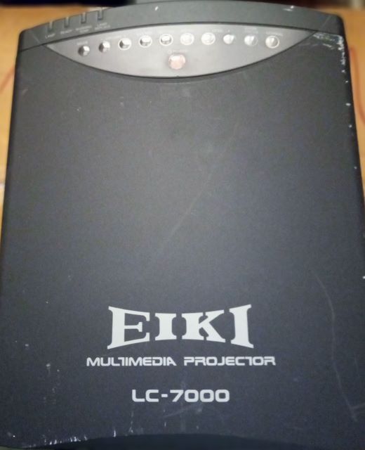

That’s a good idea. If you need a projector to develop the idea, I have a projector I’m selling for a widow friend. $100 plus actual shipping service of your choice from 93065.
