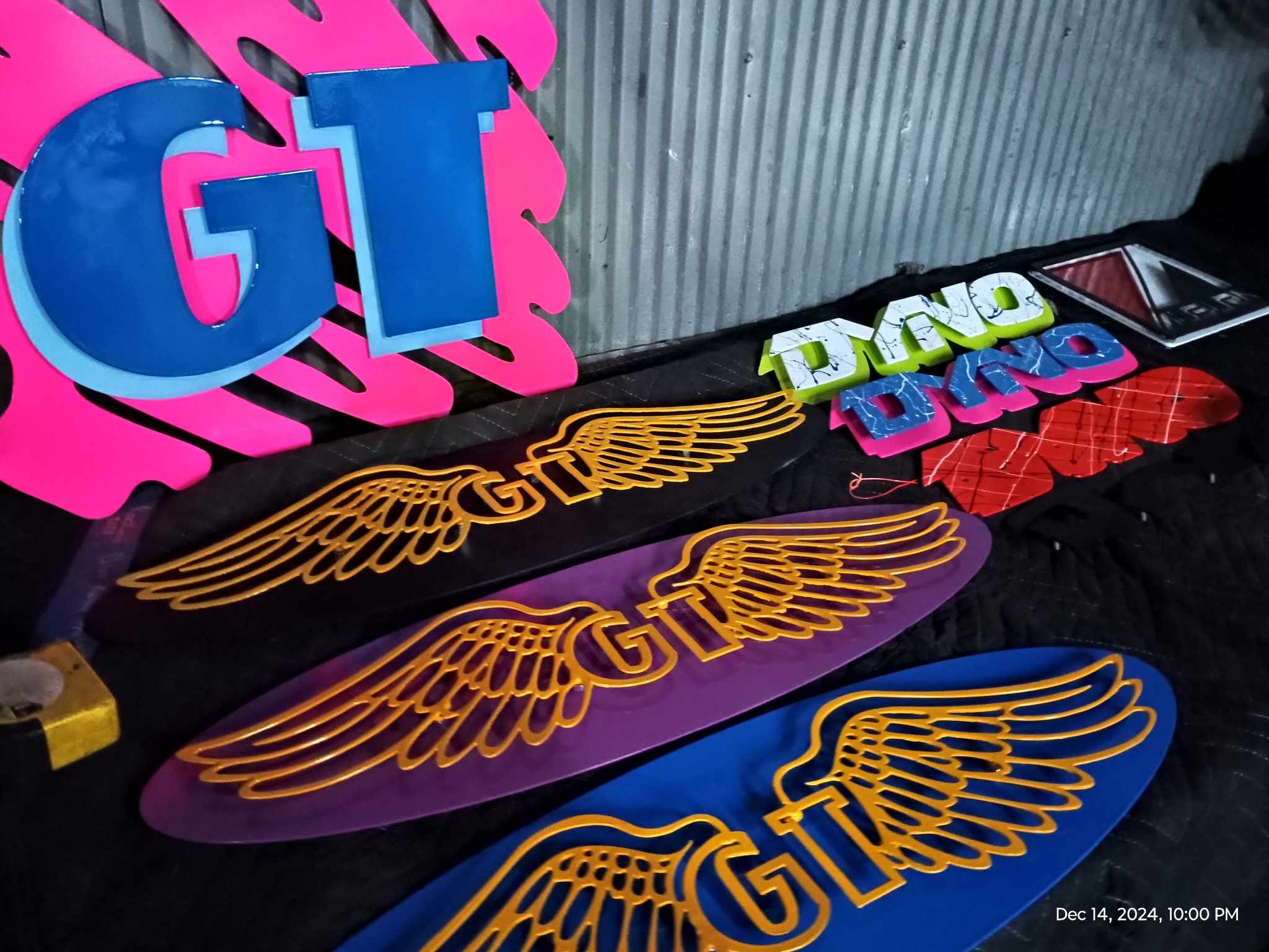

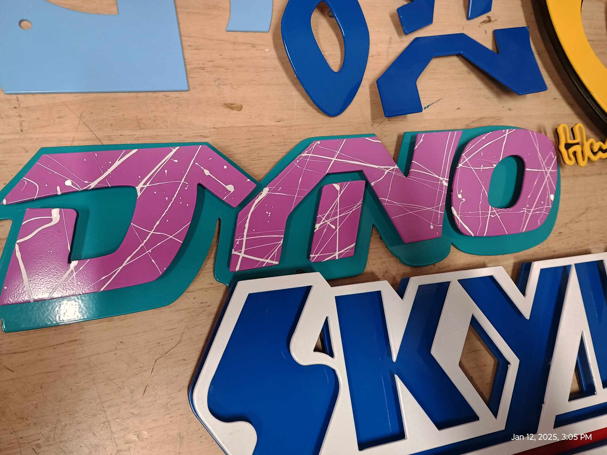

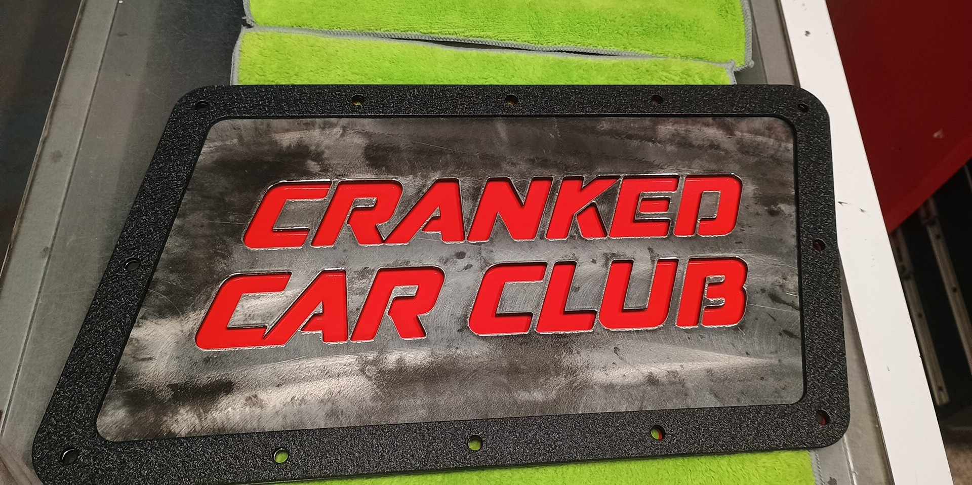

@Bigdaddy2166 We started with Vintage BMX man cave art. I will link some pictures :slight_smile:
My partner is a great Powder Coater and he makes the rough metal look Amazing.
I am very impressed. Bravo, my friend
Thank You! I asked my partner to forward me the pics from our latest batch . I will add it here when I get it.
