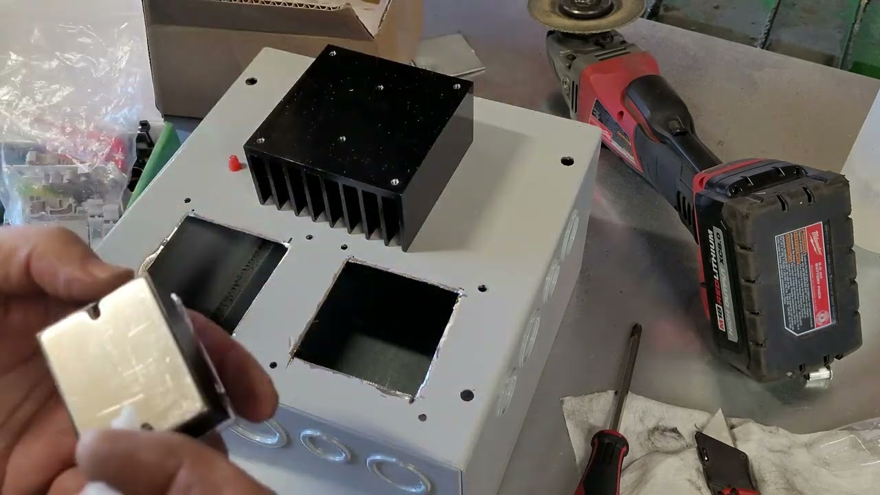

I will nee to get new indicator lamps for lower voltage DC, but otherwise everything is working properly now. Just need to wire the alarms and install the door and it’s time to cook
I forgot to put up any pics yesterday, been working on it non-stop yesterday and today.
Everything turned on and functioning. You can see how dim the two indicator lamps are.

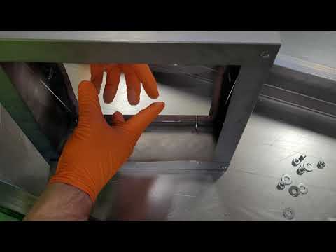

Skinned the doorjamb and installed the tadpole gasket
The door, just resting against the frame and shimmed up
Strapped the door closed to compress it tight to the tadpole gasket before installing the hinges.
Window opened
All the heating elements fired up with the door closed.

This is the last of the pictures, I’m on to editing videos now. The oven is complete and functional at this point. There are two things I will address in the coming weeks, first is the indicator lamps for the two heating element circuits. I will need to put the full time hot lines for the heating elements on a switch and that 100% will fix the indicator lamp issue, I rewired them to the SSR output today and the other side of the elements backfeeds through so the switch will absolutely fix this problem once and for all. The other issue is the alarm buzzers, they aren’t mission critical so I can address them when I get some free time to learn how the alarm outputs work for the PID and the timer. Wiring the alarms isn’t the issue, it’s the programming that I need to learn. Anyhow I cycled the oven to temperature today and everything worked great. Finished attaching the door latches and the door functions better than I hoped. The door weighs about 100 pounds so I put a caster on the unhinged side to carry some of the load and make opening and closing easier. It runs real smooth. I’ll try and get the next video posted today! So much video to edit…
The door after installing the latches and removing the straps
The door latches installed
The voltage and amperage gauge works great, and the indicator lamps with the right voltage look good now

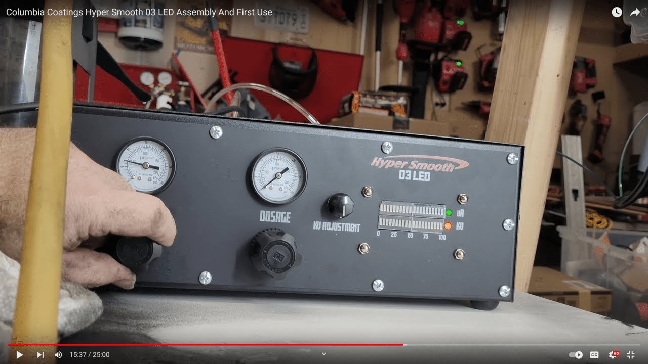

I put together the powder coat system today and cooked my first piece ever. I got a touch of orange peel I think because I put too much paint on, and I think I got a little bit of back ionization. Overall though really happy with my first go. This was Columbia Coatings super mirror black. The paint booth worked perfectly, I’ll have the build video of that up soon.

It’s the first and only powder coating system I’ve ever had, I’m looking forward to using it regularly. I have about a half a dozen signs cut and waiting on powder coating so I will be getting some practice in. I’m not looking forward to cleaning out lines to change bottles but I think that’s just one of those things you have to get used to. I just finished editing the video for this, I’ll post the link once it’s uploaded. It’s the assembly of the Hyper Smooth 3.0, spraying and cooking the part. I got real lucky on that paint booth, the blower has been sitting in my driveway for 18 months getting rained on, snowed on and covered with leaves. Couldn’t believe it fired right up when I wired it, and it pulls just the right amount of air.
The hyper smooth 3 is a excellent machine. I have sprayed between 25 and 30 pounds of powder with mine… the cups are cheap enough your main colors you use just use for that color cuts down a lot on color changing clean out.
Get you one of the surface conditioning tools from harbor freight and the 40 grit wheel and you can grind the powder off of the front and reshoot it.
So you would just need to clean out the hose and the gun then right? I had considered this before but I haven’t had a chance to look at how it would work out. I know I’m going to need a dedicated cup for flat black and one for clear coat at a minimum.
