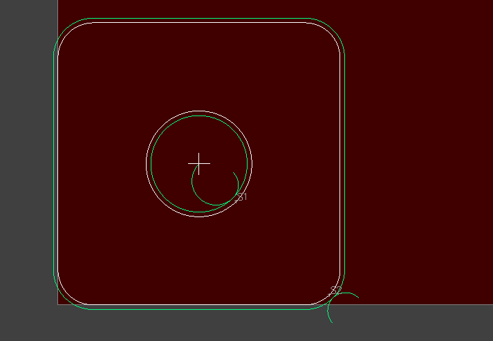

I will post a picture of part and tap file later. At least you can eliminate your cam.

2 in test square.tap (1009 Bytes)
if it works i cam out your part to try also.
you may need to adjust ipm it is programed at 60 ipm.
Just ran the test .tap given by Phillipw. Same results:
Slight difference though - on ProNest LT23, when I get a pierce failure it continues the program until it realizes there is no voltage on the THC. So on the shorter cuts (under .5 sec), it never realizes anything is wrong and continues to the next step. With Phillipw’s .tap, the system immediately recognized that the arc was extinguished and gave me the THC voltage alarm.

At this point, I am pretty certain that the issue is not with the CAM (since it was replicated with Phillipw’s .tap.
