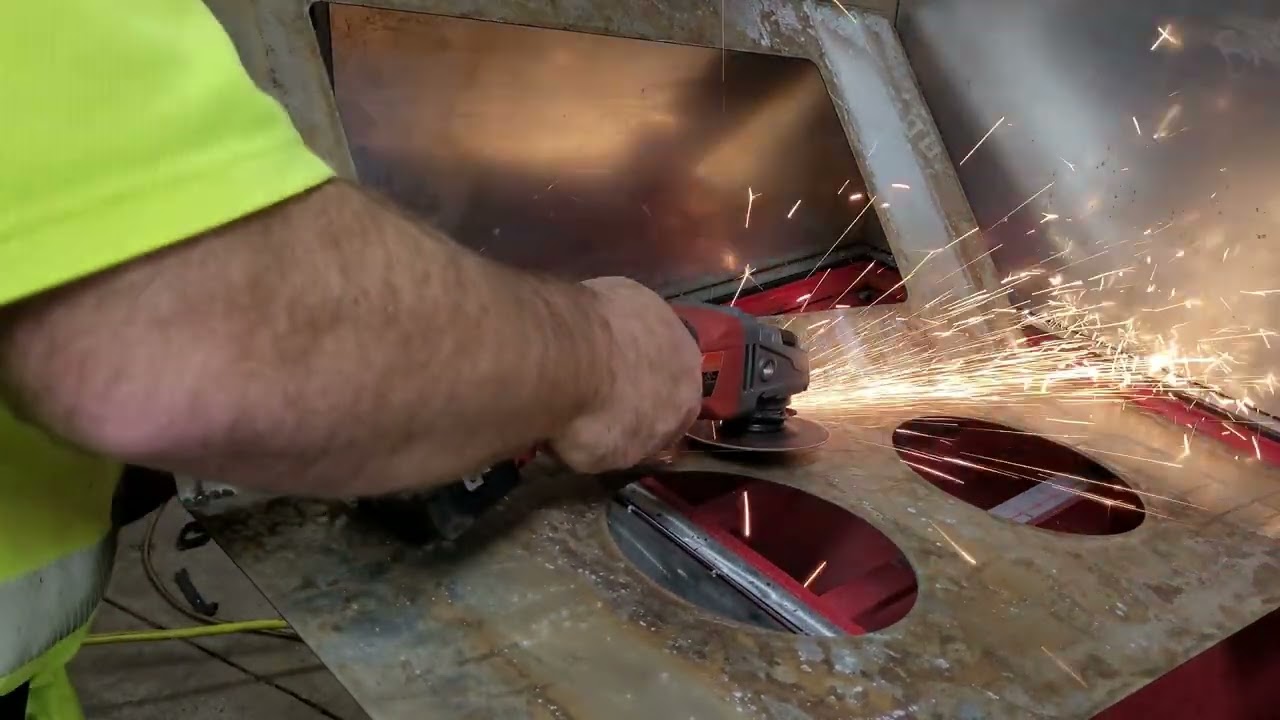

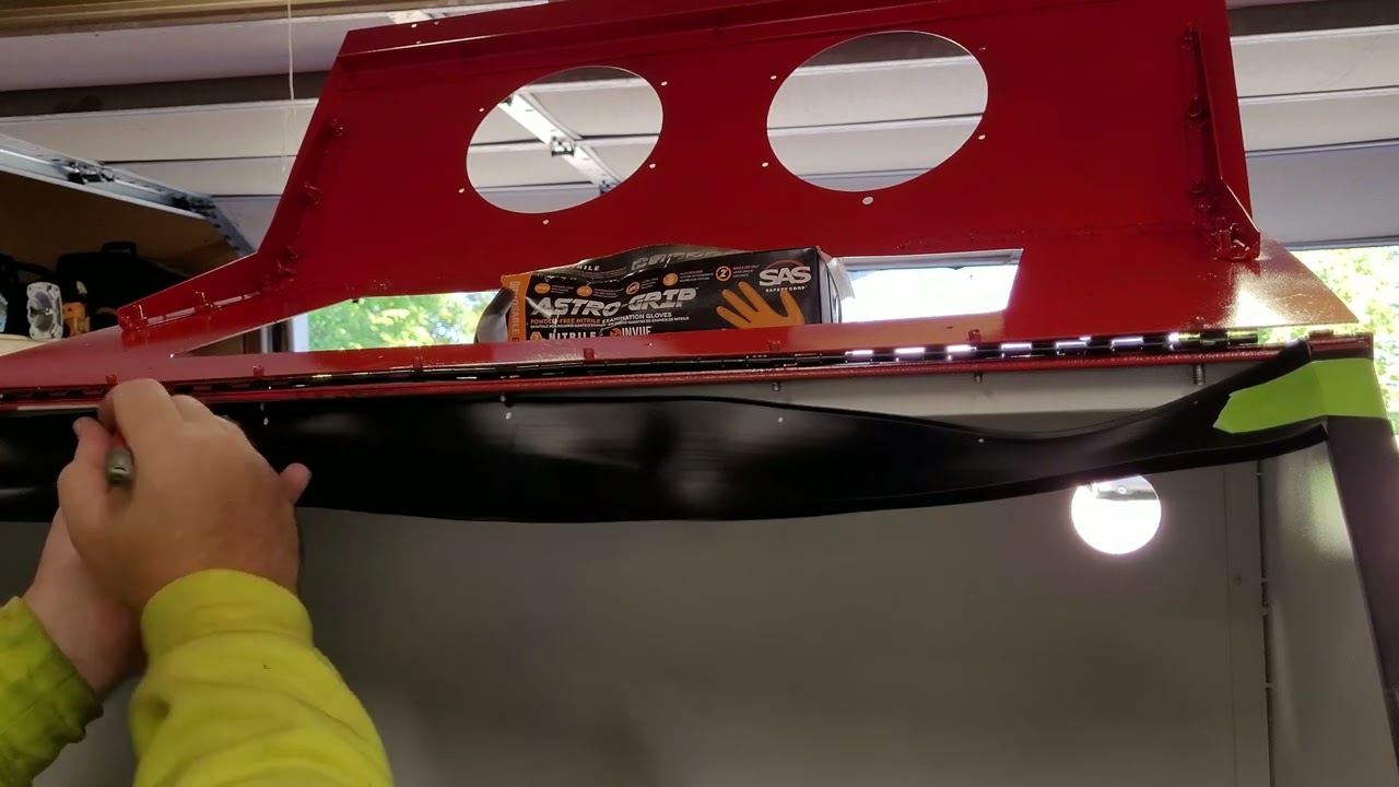

I upgraded my sand blast cabinet so I could fit my signs in there for blasting
I had a standard issue Harbor Freight blast cabinet, it was just a couple inches too small for my 24" metal signs so I fired up the table and cut some new walls and basically rebuilt the entire thing. I added 4" to the height and depth and left the width the same at 33". Also moved the door from the side, it’s now a front opening cabinet. I made a 3 part video of the process, it’s a bit long for one video.
Nice job on the Videos and the build
Thanks Knick, I did make one major blunder that has to be fixed but otherwise it works perfect. I made the hand holes too close together, I’ll fix that when my current project is done (I’m building a 54 cubic foot powder coating oven).
I thought they looked close in the video. :grinning:
I am more of a 5-10 blunder kind of guy!
Post your P/C oven build if you have time. I built mine and always like to see how other people build stuff.
