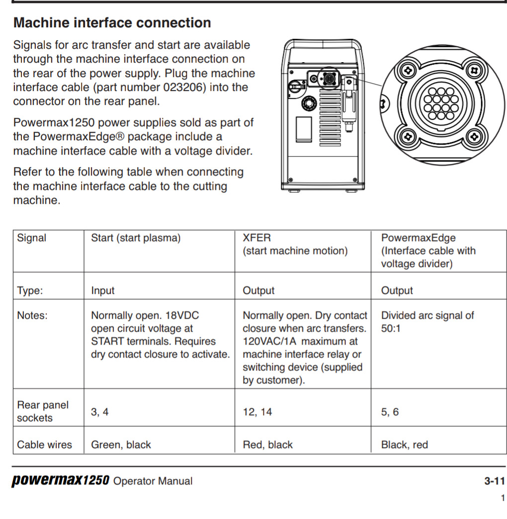

@Mach1 what mode of operation is your machine set for? I believe the middle setting or normail maybe the correct one.
Let’s maybe try to get raw voltage straight from the lead lugs ?

I would agree with @TinWhisperer with hooking up the RAW voltage leads to the work clamp and torch lugs.

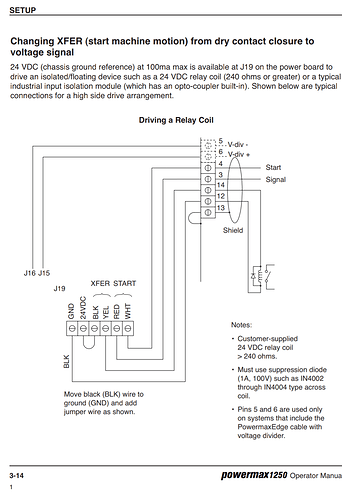

I am going to need do some creative wiring to pull raw voltage from the torch. ( No exposed lug to wire to the torch.) ( It plug directly into the machine frame.) Ground clamp will need to come directly from the board lug.
fyi, “ground” clamp is positive so the red wire goes there. it’s not actually a ground/negative. the torch side is negative.
that is good to know, and was going to be my next question. So the black wire to the torch?

Well I tried everyone’s suggestions with no good results. Made over 100 attempts to run the programs to cut only 3 pieces. Checking wires and connections with a MM and the only thing I could find with my limited knowledge was the continuity between the black and orange wires for the torch trigger is only momentary at the start of the run. Full continuity during manual torch firing. I don’t know enough about the systems workings to know if this is right or wrong. At this time I am still dead in the water whit no clues.

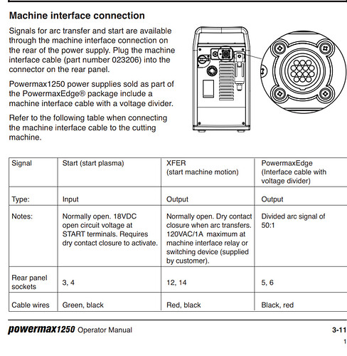

so manual fire from the trigger works good right? have you tried shorting the barrel end of the torch on/off cable that’s connected to the cutter to see if it fires normally as well? if it does then I’m suspecting maybe the relay in the control box is faulty.
First off i said black and orange wires, I meant to say purple and orange wires,
Yes,I can fire the torch manually from the plug with a paper clip.
The relay is working in the table box.
I think possibly I have a delay in the cutter sending voltage to the VIM and onto the table box or a delay in the table box sending signal to the computer. OR the computer is slow sending back it’s signal to the box.
Because I hooked up a mm to the grey and white wires coming out of the board that fire the torch.
Ran the program and the table box is cutting off the continuity to the torch on/off.
Then I checked the signal from the VIM to the THC plug wires inside the box and manually fired the torch and got 3 volts DC .
For some reason the voltage is coming in to late and the program is shutting down the torch.
This only happens when I run cut files.
