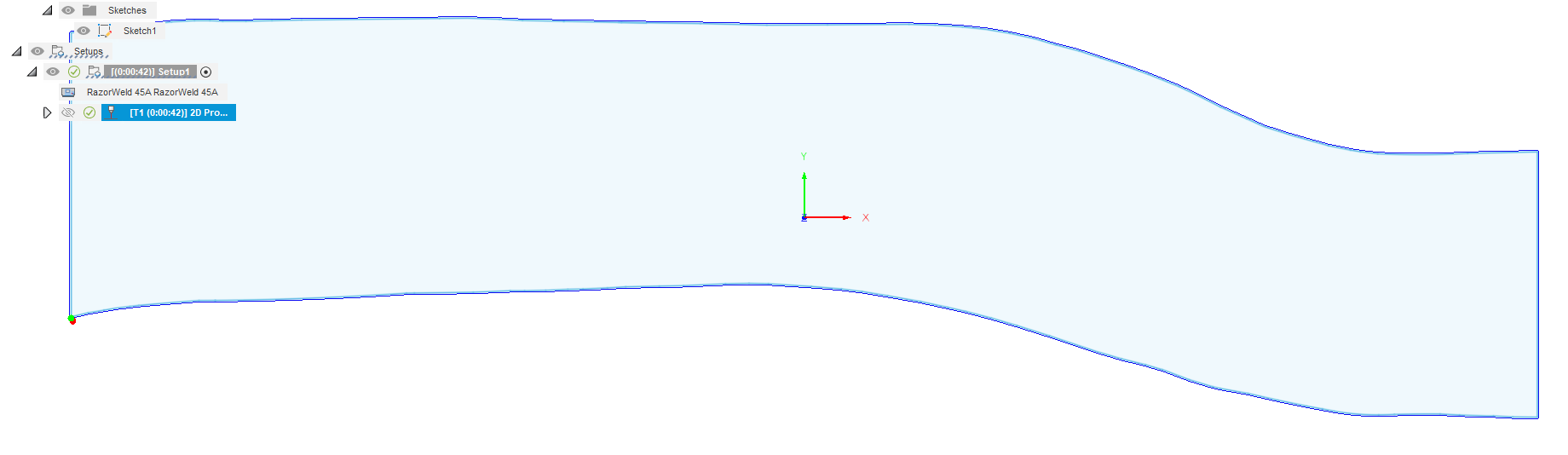

I cannot seem to be able to make an NC program to cut all around?+(Solved)
Here is the F file :
63rbox v3.f3d (2.3 MB)

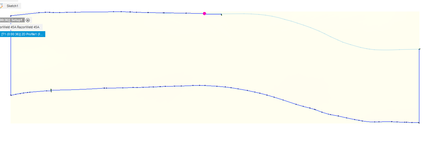

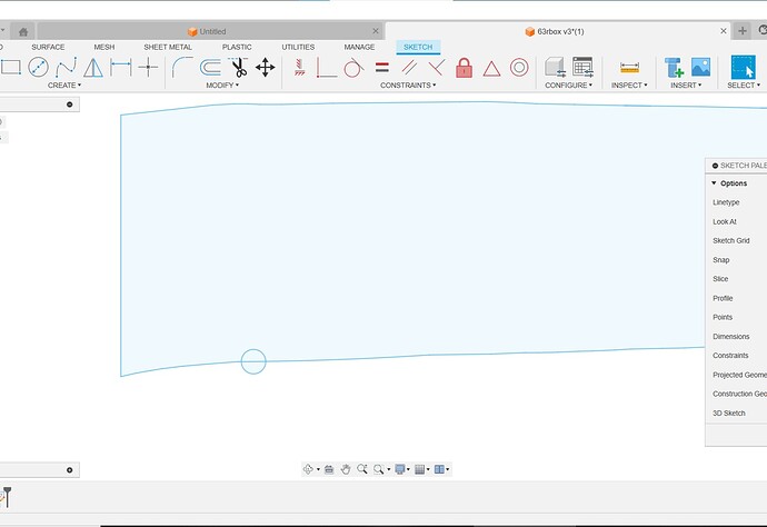

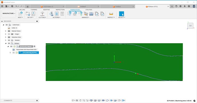

If I start the cut at the top it goes about half way then stops where there is a light yellow border it won’t cross, also I have a grey arrow I can’t seem to delete, I have tried a lot of things from past lessons learned from a few of you experts, Please take a look and see if you can tell me where I messed up Please, Thank you -Rick

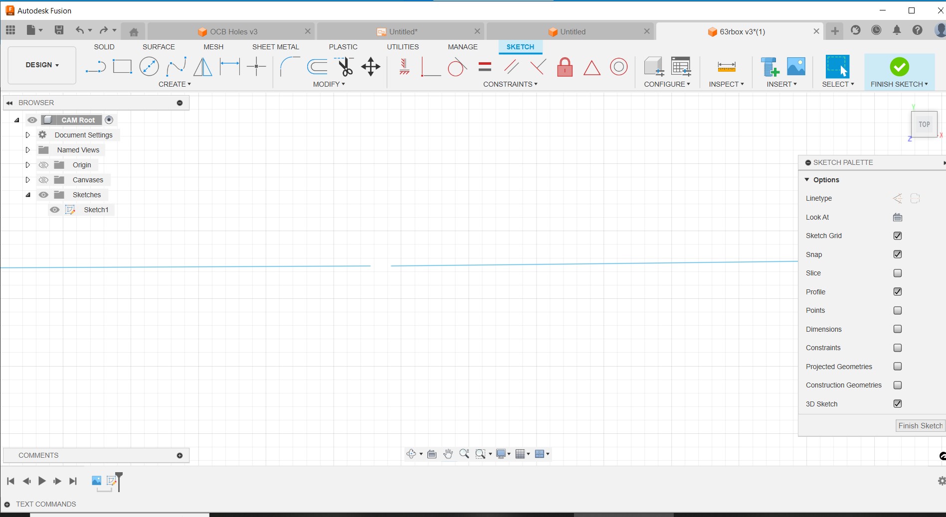

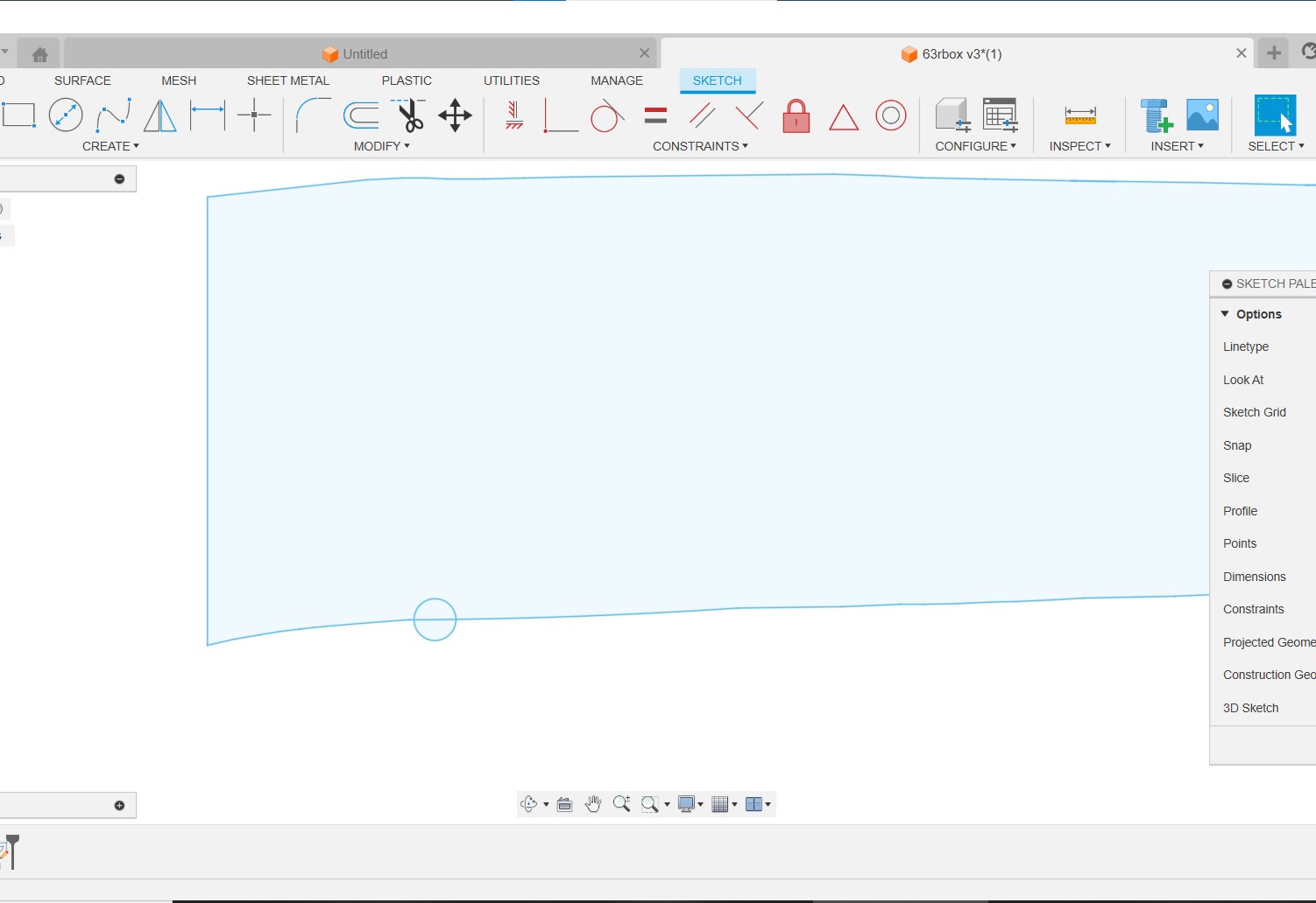

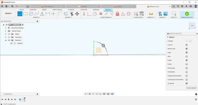

Your sketch line where the circle is, does not connect to form a closed shape. If you connect that line, then the shape will turn light blue indicating a closed line an then you can either extrude and make your cut program, or just from the sketch.
Sticks got on that quickly and solved the issue to make the ‘profile’ complete. You will definitely be able to make a body and go to Manufacturing, pick the face contours and run a tool path.

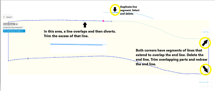

Cutting with the sketch turns out to be a messy deal:
Here is what is going on. It is mostly overlapping lines. I circled in yellow the ones that had to be changed for Fusion to be happy with the sketch to take to “Manufacturing”.
So I made the changes, including the one Sticks found, now you will get a complete toolpath using the sketch.
63rbox v3Chelan.f3d (2.3 MB)
The best way to avoid those gaps and overlapping segments is to zoom up on those lines so you are much more likely to cut lines and start lines at a precise points.

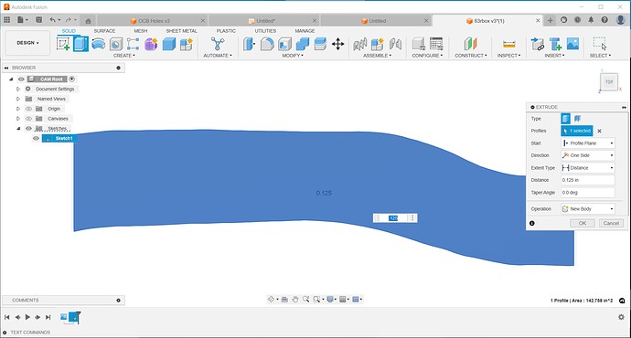

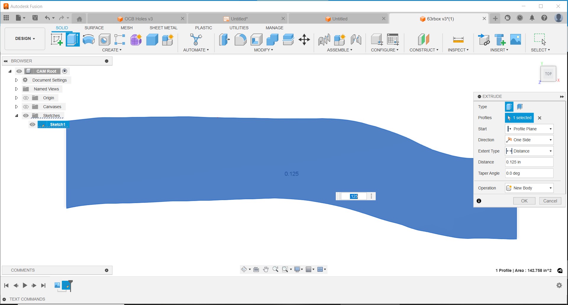

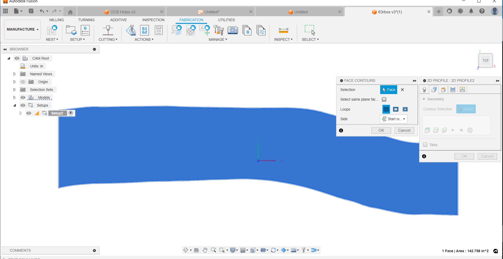

Extrude your body, how ever thick your metal is, then do face contour cut.

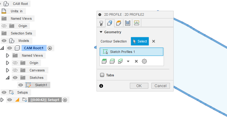

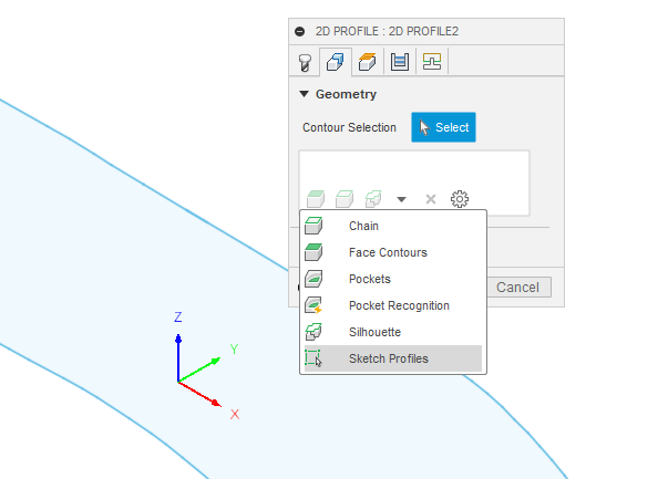

When I said “use the sketch”, I meant to use the sketch in the contour selection by using the drop down menu and pick “sketch profile” or pick the sketch directly from the browser. With this method you don’t pick any contours.
or pick directly from the browser may also work:
In either case you don’t have to click on any of the contours. I will admit, I did not try that.
Edit: I just tried your original version with the gap fixed and then going to manufacturing and picking the sketch as described above. You can see how Fusion is confused on how to handle things. It cuts out the extra ‘duplicate’ line first going the wrong direction, then starts at the lower right corner and cuts the wrong way up to that first cut and then back to the lower right corner cutting the rest of the image out in the correct clockwise position.

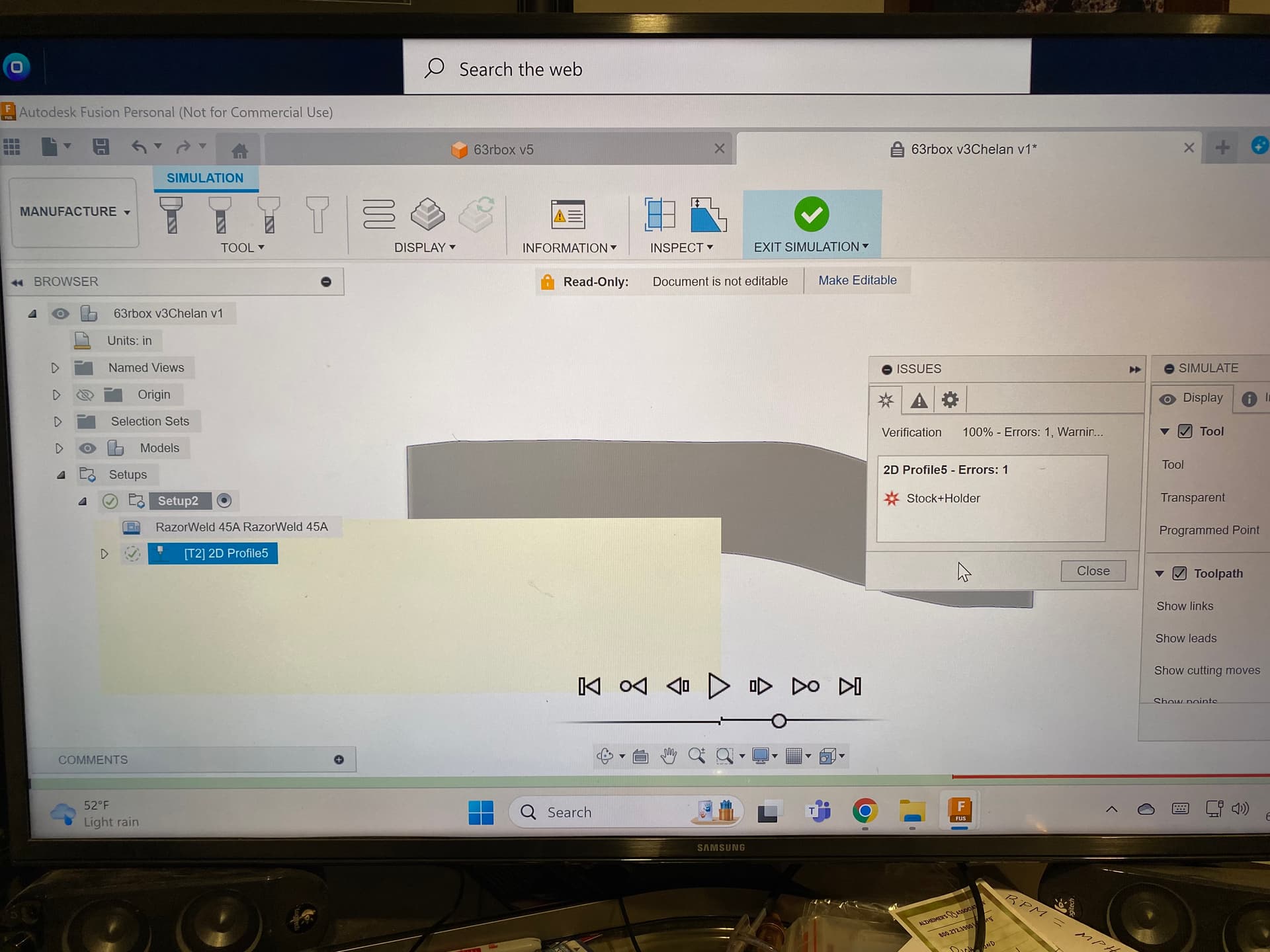

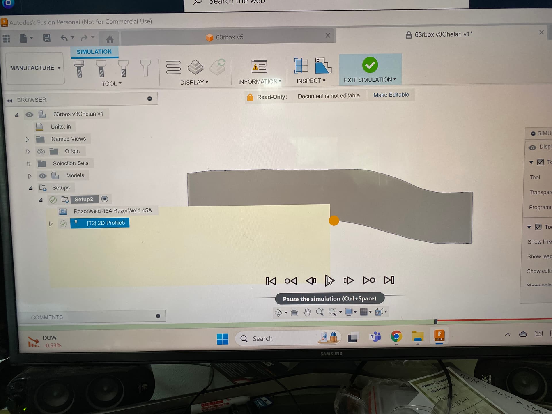

Thank You, i did it and it is back to cutting half but there’s the yellow box again, and it won’t cut that area?
I don’t know if the picture will show the yellow box?
I see the yellow box, I have never seen that. So you say when you run the simulation in fusion it stops right at the yellow box? or does it disappear behind the yellow box and come back out?
yes,it just stops…weird, I am starting to think I have it so messed up I might have to redraw it?
I saw a note in the upper right corner, issues found clicked on it , it says 2D profile 5 - Errors: 1.
I tried changing the Flute/jet, Shaft, Holder/head, still stops at the yellow, But i noticed I can hit the arrow keys and make it go thru the yellow but it’s red in the path?

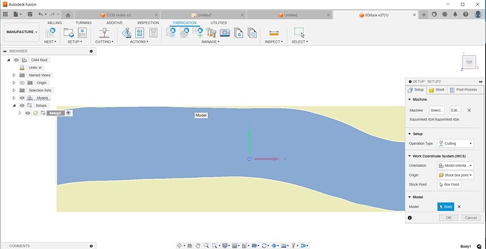

I am not sure what you are doing in the setup and cut profile.
Worked for me by closing the gap in the sketch, extruding, new setup selecting the body not sketch, then the cutting with your Razorweld (came with the f3d you posted) face contour selection, again not sketch.
You need to go back to Design and edit the drawing, removing all the history behind the original drawing.
Extrude it and move on to Manufacture.

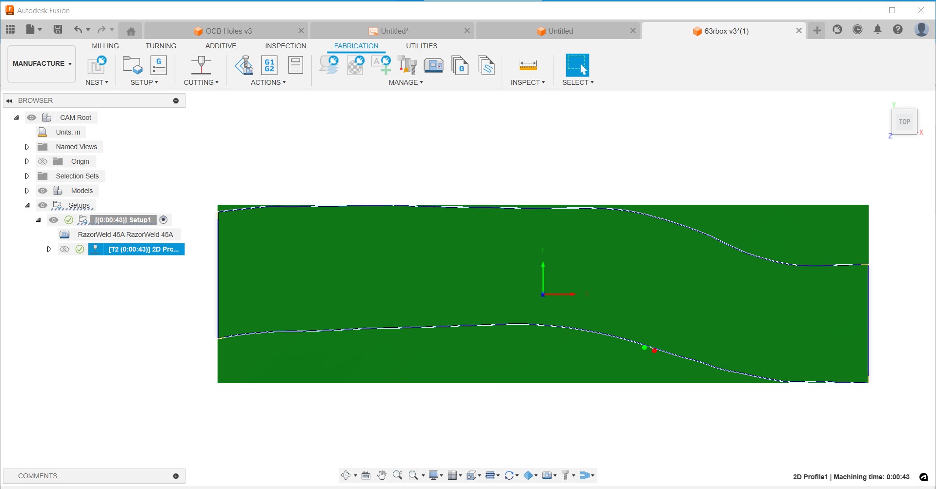

Delete all your current setups.
Pick your machine. Langmuir crossfire. Not Razorweld.
Set your coordinates and hit OK.
Go to the tool and pick It.
Go to the profile and pick cutting from the top menu.
Pick your cut profiles and then simulate it.
Go to Actions on the top and post-process it.
Then, send it to the table for cutting.
I am not sure how you got to where you are.
In 5 min, you will be cutting.

I’m not a Fusion user, but it seems that Fusion thinks the yellow box is a piece of stock that the torch will crash into.
