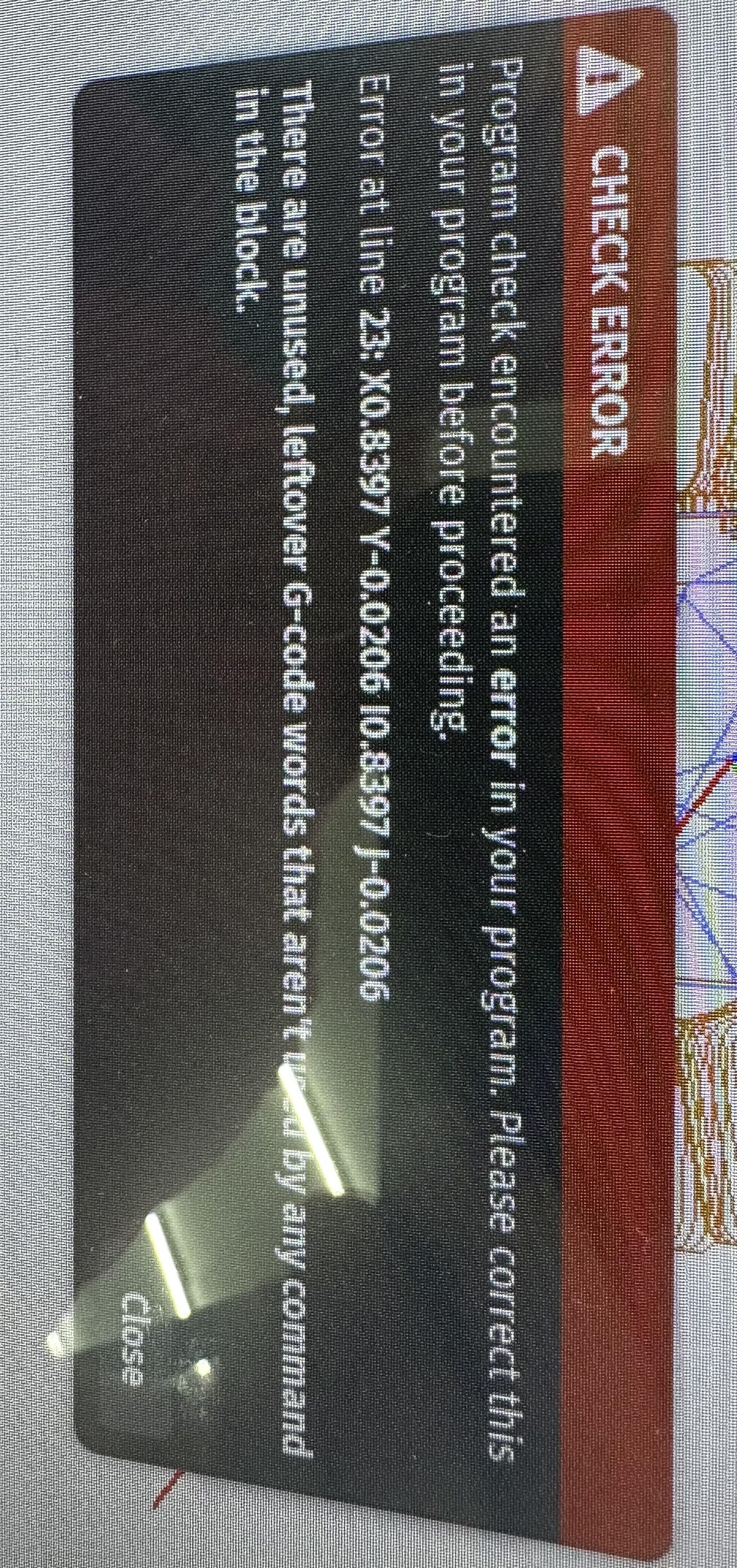

I always get an error after tool change
Every time I have a program that has a tool change, I run the auto tool set and the the next g-code and I get this error. I have to reset my zeros and reload the program and it runs fine.
Cut control does not yet recognize tool changes, each tool has to be a separate file.
Ok, thanks :pensive:
