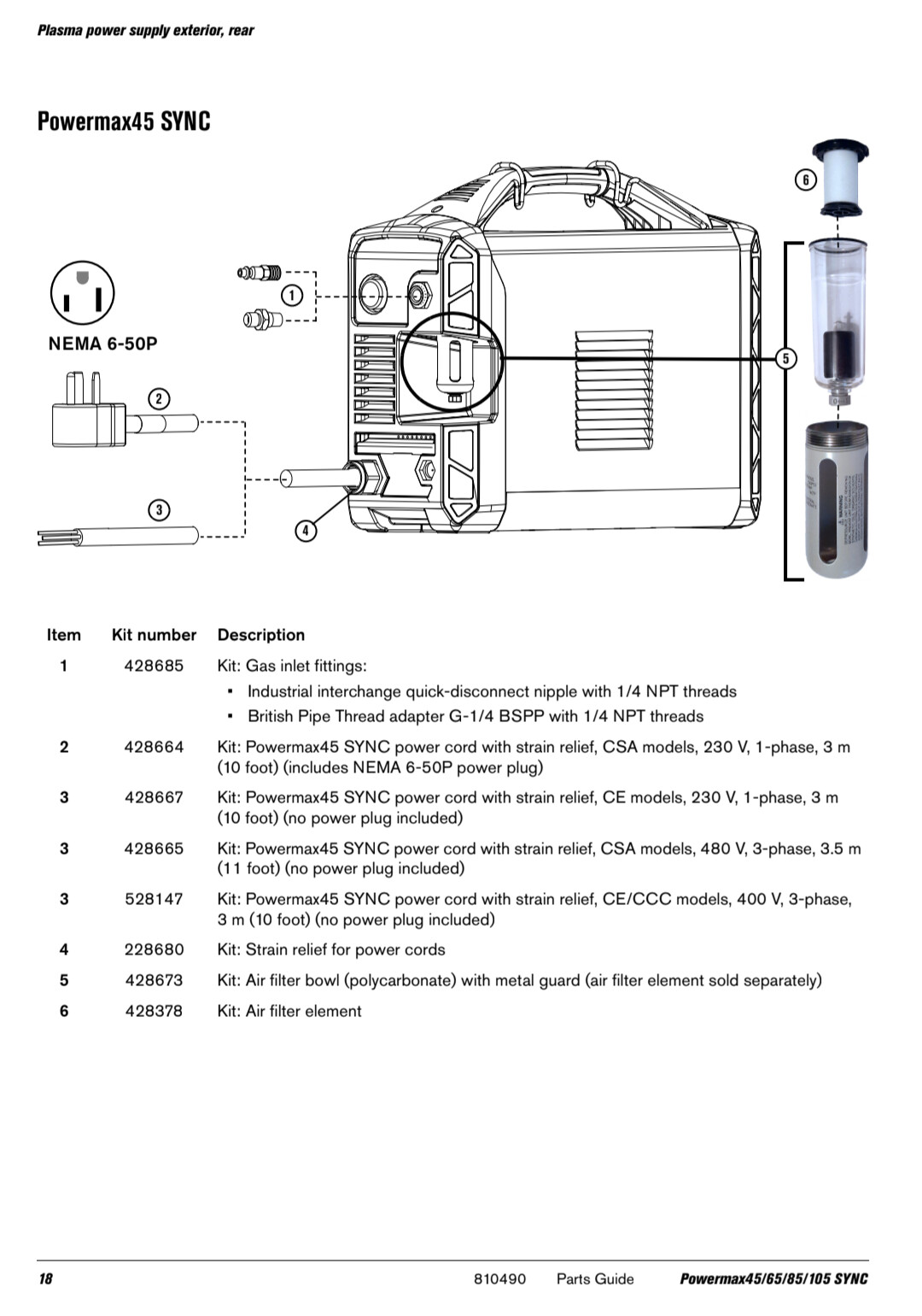

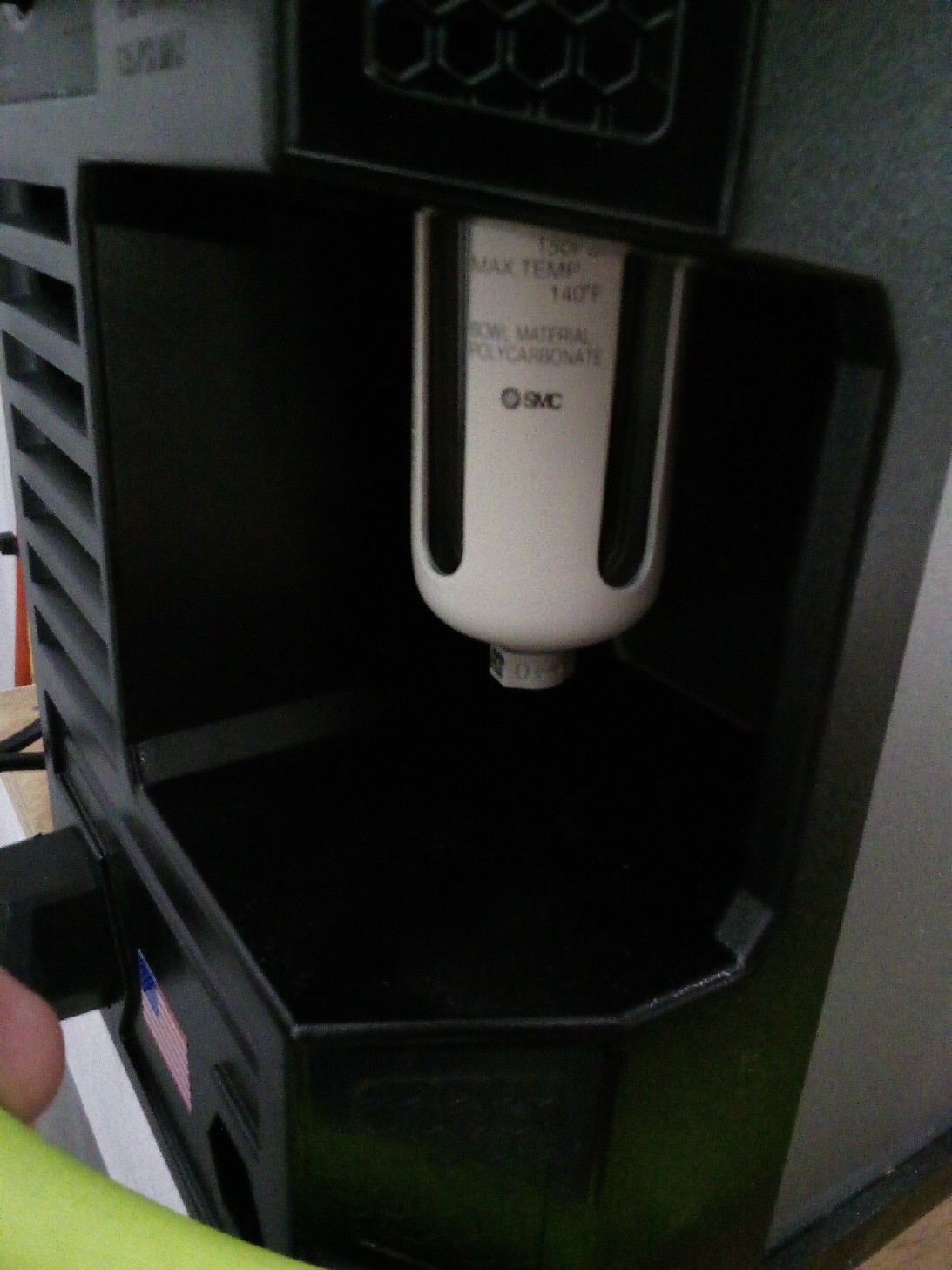

I have a new hypertherm 45 sync and would like to know what this is on back of it ? And any maintenance I should do to it ? Seems like a filter ?

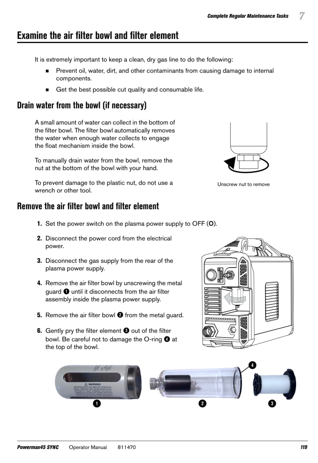

That is the particulate filer housing and inside of it their is a filter to remove dirt, rust, sand etc. NOT water. It may state in the manual to replace it every 30 days. But it most likely will not give you a part number for it.
They stock all those at bakers gas. That’s where I buy my replacements.

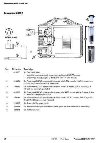

The manual does discuss this in their maintenance portion
And then from the manual it tells you to refer to the Hypertherm SYNC parts guide For the part numbers.
