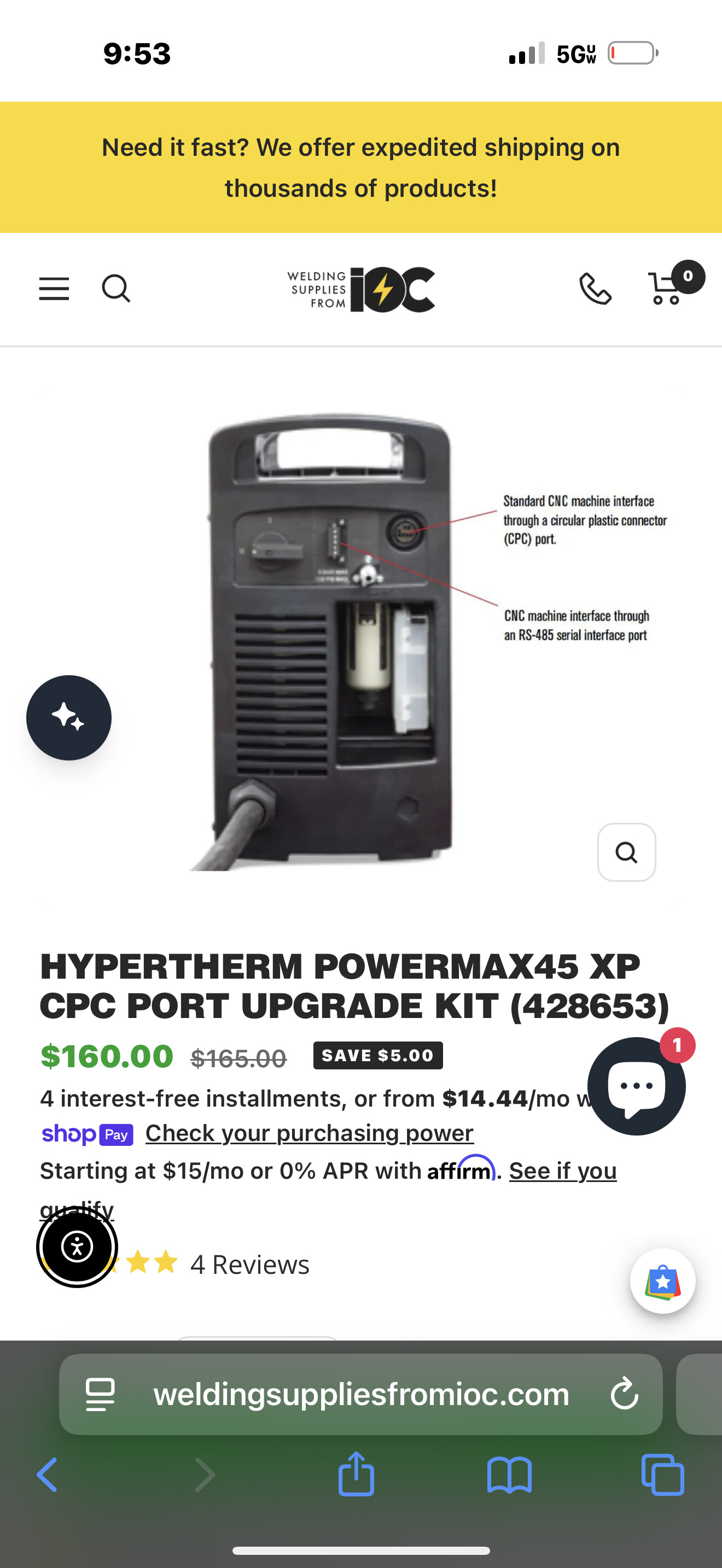

I have a Hypertherm 45xp and I’m new to the cnc plasma table world and I was looking into getting the cnc port upgrade kit for my plasma cutter is that all I would need to be able to run the plasma on the table?

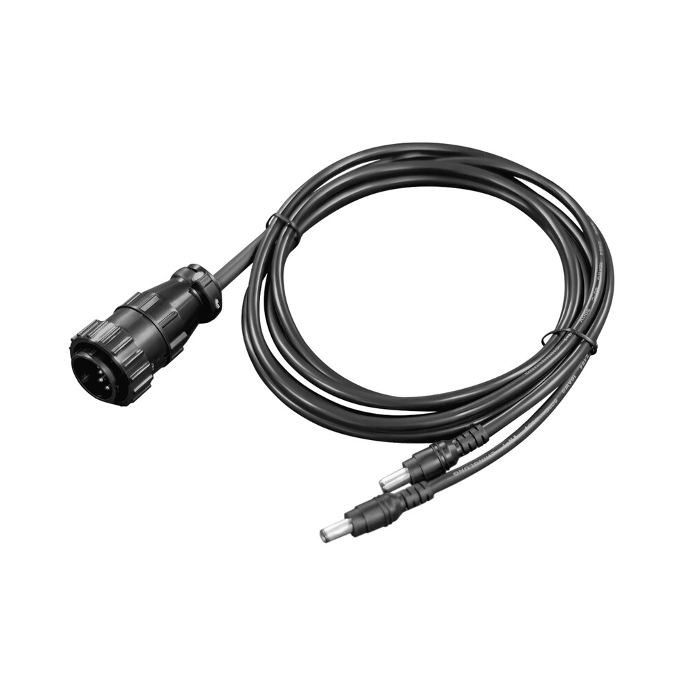

Welcome to The forum you’ll also need a pigtail to come from that CPC port to the machine.
What Tin said.
Just make sure during/after your install, you confirm you didn’t accidentally bump the dip switches.
By default, it’s set for 50:1 but just make sure it’s still on that setting before buttoning it up.
Edit: Speaking of I think I have that Hypertherm cable sitting in my box of parts :rofl:

Hypertherm bundles the systems for authorized retailers like Langmuir to sell
With that said, Hypertherm machines with an included mechanized torch all have a CPC port from the factory
The machines with hand torches don’t have them pre-installed; easy to install anyway

Thank you for responding with this rather important CPC port detail. This makes more sense. I just ordered a 45 SYNC with the machine torch from Langmuir and the pigtail cable to connect to the Crossfire controller box and VIM. I downloaded the cutter’s documentation from Hypertherm and didn’t see the CPC port as a highlighted feature of the machine. The pigtal (only) arrived days ago, with no documentation (classic) or lead labelling, waiting on the cutter. From what I read on the pig tail the longer leads are for the arc trigger and the short lead is for the voltage divider.
Deleted, re-read original post.
Correct, because it is assumed that the VIM will be attached to the plasma cutter itself hence you’ll only need a short cable.
And yes there is documentation; it’s all online just like assembly of the table is.
They even have a picture of said pigtail.
