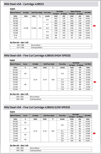

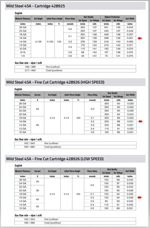

This is the published cut charts for the Hypertherm 45 SYNC machine. I put an arrow at 16 gauge so you can see how you can change the kerf width whether using the normal cartridge or the Fine Cut cartridge.
(Note: More recently, Hypertherm has been giving guidance to suggest better cut quality by decreasing the cut speed slightly with water tables vs downdraft tables. I could not find what the actual percentage decrease. Most of us with Hypertherm start with the chart settings and nudge the settings from there. For the most part, the charts for the 45 XP serve my purposes. I do NOT have the SYNC machine).

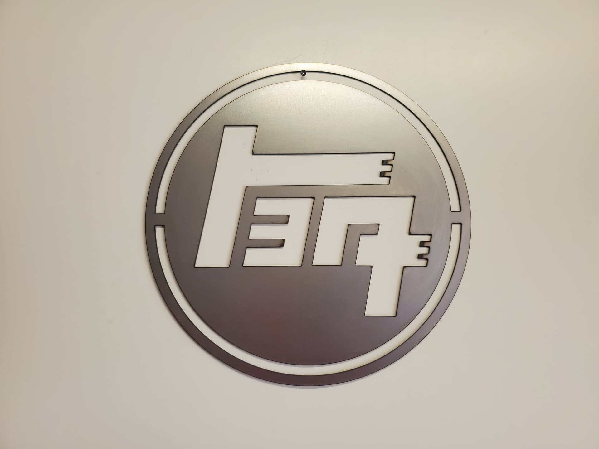

Non-sync user here (have been told to stay away from sync) but Hypertherm’s finecut makes a difference against it’s own consumables
Both Hypertherm, one finecut, the other isn’t, both at book settings on 16 gauge.
And another, but with the water level much lower.
20% is what I was given from hypertherm tech support last year, and that seems to fall in line with what I have to massage my cuts from their cut chart to reality.
