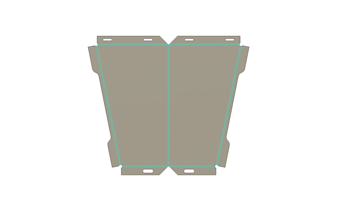

did quick video to give another way but Tin is HVAC guy and I just play around in fusion. I have never cut or bent this stuff. Some really cool things in fusion. Of course, I would need to add tabs or way to join like Tin did on flat pattern.
@DonP looks good, quick and to the point of sheet metal flange/loft tool.
The reason I split it in half so it could be fabricated on leaf brake instead of needing a mag or square to round brake.
With thin enough metal you could do it in one piece in the leave brake too.
