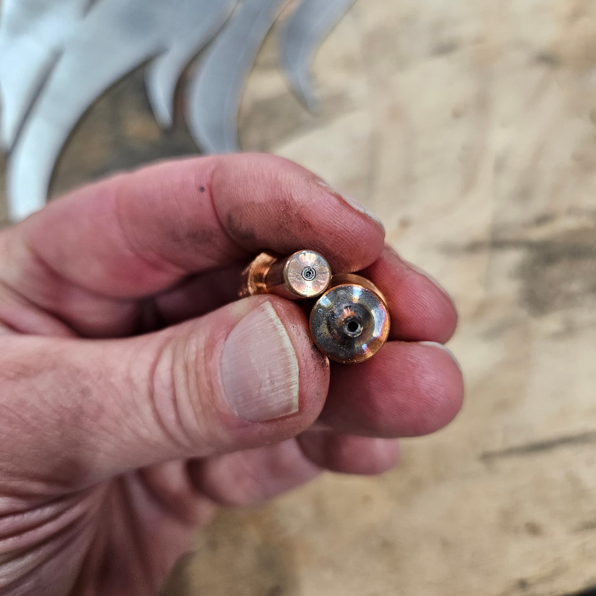

That electrode looks normal there is still a lot of Hafnium left, as its used it will get a pit in the middle. When the pit gets to be about .065" deep its time to change it out.
Well I must have looked at it crosseyed!! It looked at first glance that the center blew out completely.

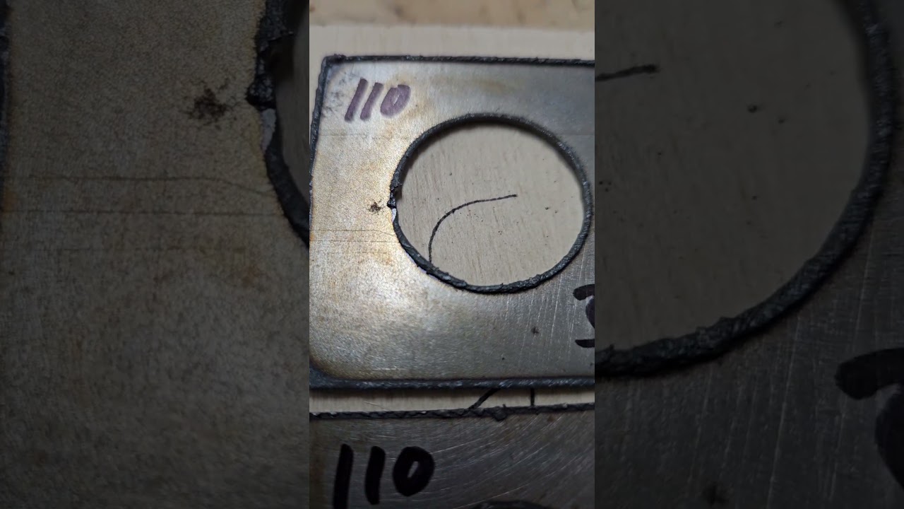

After doing some more reading, I think I was able to get my cut height dialed in. Apparently my machine likes .03" for the IHS springback number. That gave an actual springback number in the G-code of .05". The .063" shim lightly dragged the torch shield.
Finally got the chance to run some more tests, too Results are here.
After chipping away the dross, I found that the 100ipm/30A and 110ipm/30A were the easiest to clean with a chisel, and their edges felt the best. The dross cam off in long, thin pieces that resembled toothpicks. All of these samples were cut @ 75 PSI on the RazorCut.
Don’t really have any questions, at least none come to mind, but I thought I’d post this in case it helps somebody else.
What thickness material?
This is 1/16".

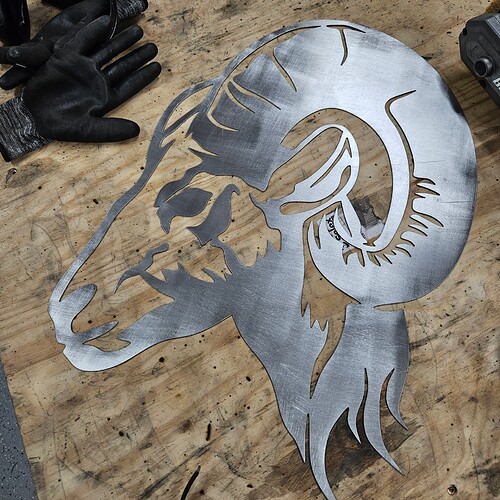

Well, I cut the following at 110ipm and 30A. Took 3:40, not sure how many pierces. 16 Ga.
There was a continuous bead of dross on the back, but it came off no problem with a wire wheel.
Also took a pic of the electrode and tip. They probably have about 5 min of run time on them.
I’m pretty happy with this. Will keep dialing it in, but thanks again to all for the help!
