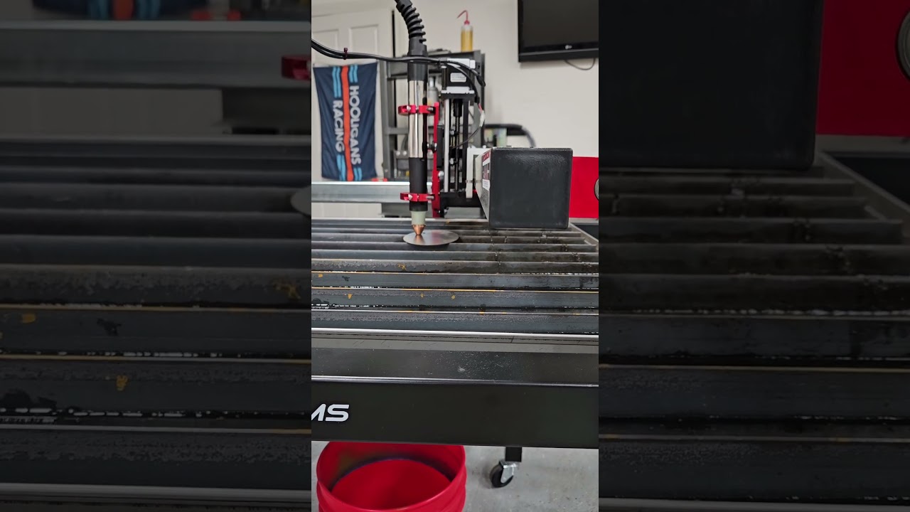

When I watched the machine do the test, I did notice some movement (flex) in the X axis tube when the torch touched the metal. Is that normal?
You won’t get good cuts with those for sure. We need to figure out what happened to them though.
The only thing that should move is the torch holder it will move enough to cycle the ihs switch. Can you wiggle anything by hand and it move? That is other than the z axis the torch head.
Those could have been just a bad electrode. Did the center blow completely out? Where did you get those?
Heres a vid at 1/2 speed of what im talking about.
It’s not loose, just flexing.

I see it is the small table. I am not sure if that is a issue. That electrode appears defective. That is probably why the nozzle blew as well.

Well, what else could cause the table not to cut at the correct height?
FireControl does say .06 on the Z axis after running the program.
Seems a lot of people get different things on the z. It seems to be a fault in the screw and nut maybe. You should get the same consistently tho. Can you lift the z axis up and down does it feel rough or sticky?

The float is smooth.
Also, did some reading. I’m using 16 ga for this test, but maybe I’m getting some kind of spring back?
It appears that I can compensate for the cut height in CAM, which I did. Made it .09. The 1/16" shim that came with the table slipped in perfectly. The question is, is this a fix or a band aid?
I would look into a bead dryer for sure. Compensating in cam is the fix if it is off. You can put thicker material on the table and redo test to confirm difference. Can even run nominal voltage to help with cut height. That is do you have the THC?
