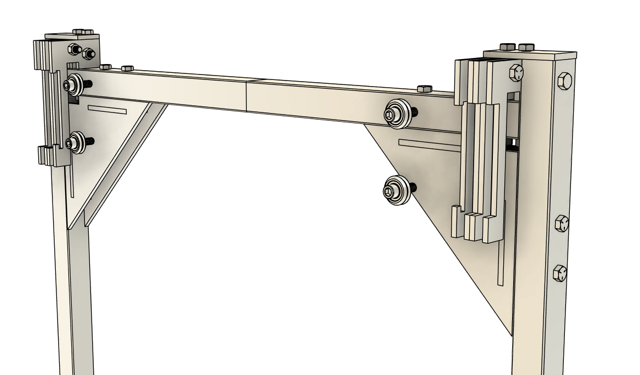

Hello. I want to build an aluminum frame using 1.5” aluminum tubing and 1/4” steel parts I can make on the crossfire pro. There are quite a few holes to drill and I want them precise on the tubes and the holes go all the way through and some cases one side will be larger hole. I am thinking to make a steel jig out of 1/4” steel with the holes arranged as needed for easy drill pattern. Then insert drill bushings and clamp the jig on the tubing which should be fast and easy and then drill with a drill press. This will be more than a one off need. Has anyone ever made a drill jig using a plasma cutter? I don’t get how I can press fit in the bushings without drilling out the holes to be precise. My holes in 1/4 steel never perfect and the walls aren’t straight.

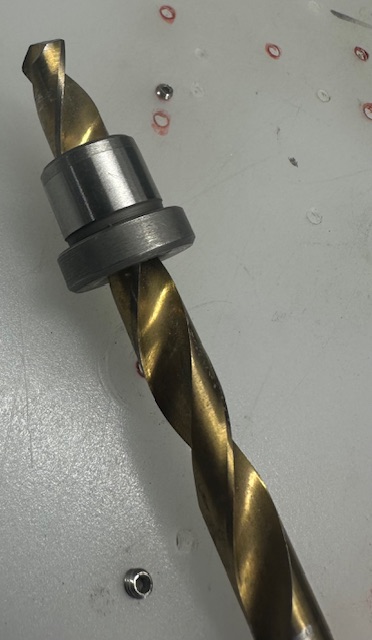

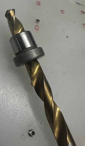

This is what I had in mind. Make a plate with 1/2” delrin on CNC, with sides added to self align. Knock in these drill bushings for 3/8 drill bit. Lay tube on drill press, clamp jib onto tube. Drill with drill press, then jump to next hole, etc. For multiples over 16” or so at each end of the tube just drill and slide down and drill again. This jig is not even 15 minutes to CNC out of delrin.

I got in this 3/8 drill bushing. 1/2 long. For me making a Delrin jig is as simple as it gets so i don’t consider this complicating things. For a drill pattern for multiple tubes I think I bolt this to the end of the tube and then just slide the tube around on the drill press with no fence and drop the drill bit down and just drill it then slide to the next bushing. There may be 8 bushings on one of the tube. At least this is what I hope works out.
