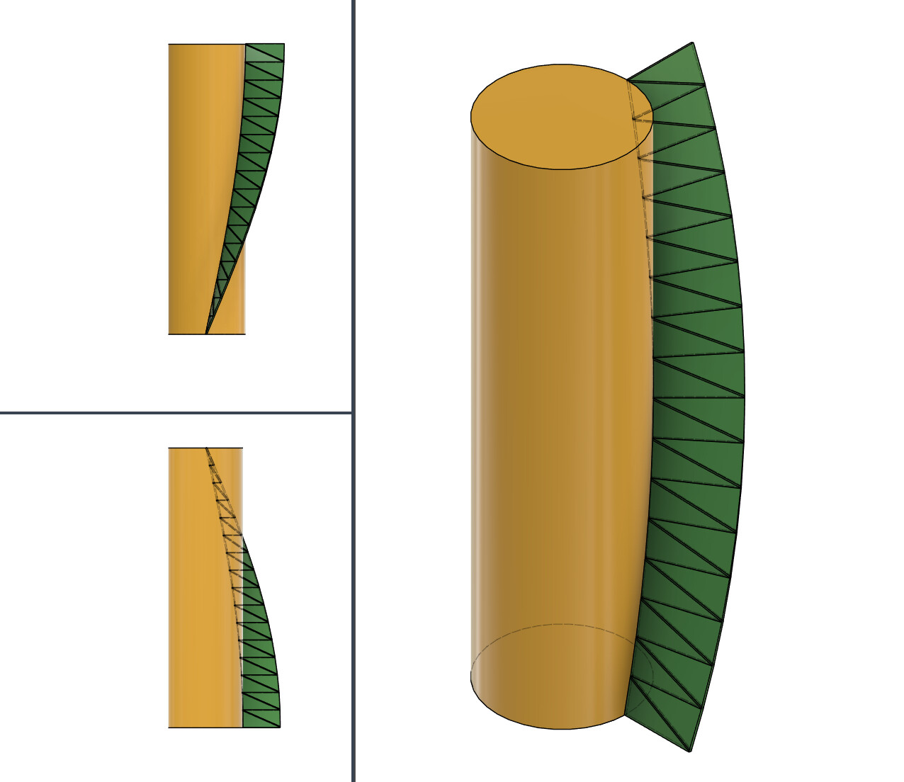

How to construct a twisted sheet metal pattern in Fusion
This is about the best workflow I can come up with right now.
Please check it out dissect it and be as critical as possible. Several features of it were clean from this collaboration. Thanks again for everyone getting involved.
Reducing steps and simplification is our goal.
Triangulated twist.f3d (652.9 KB)
someone could get more and more accurate by increasing the amount of construction planes that split up the strake. What I found in my real world applications is that between 3 to 5 splits worked out OK with no discernible gap.
Here’s something to think about from both a practical and geometric perspective. Sheet metal bends because the top and bottom surfaces have different areas. This makes it somewhat hard to model accurately. However if thickness is maintained, modeling with surfaces is fine because the surface is the sheet metal center line. Visualize the center line for a press brake bend.
Also, physically shrinking and stretching change the metal thickness in addition to the top and bottom surfaces having different areas.
Hope this makes sense.
Were you able to tessellate this in fusion’s mesh workspace? Is so, it might be possible to work your way back to a body that can flattened after conversion to sheet metal part.
I’m gonna have to check that out I am totally unaware of that feature. Thanks for the tip
I’m gonna have to play around with the settings but this definitely is gonna save me some steps once I figure out some of the settings
Tessellate a curved surface to get a mesh of triangles, then convert that back to a surface, then thicken to get a body, then convert to sheet metal part. Might work.
Looking at your triangles, it seems bendable as a series of triangular flanges.

Here’s a new version with a few less steps thanks to @holla2040 input about the tessellation function in the mesh workspace
again please be critical while dissecting this F3D and if we can reduce steps further, let’s do it.
Triangulated twist Tessellation.f3d (2.0 MB)
